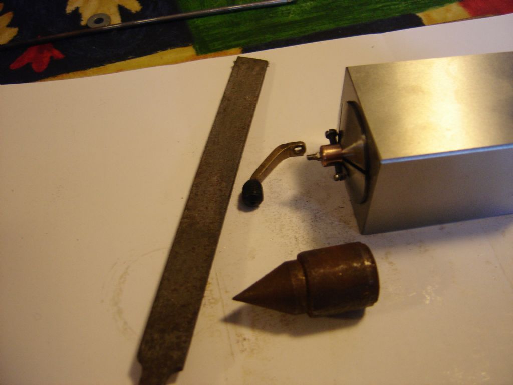

                                I'm in the process of making a holding block (that bolts on my boring table) to lift my ER32 blocks to the centre height of my small lathe – and then it will be possible to use them a bit more conveniently than if they were just in the vice (which doesn't hold them at c/h)…
                                And of course they can be handy for bench work too. I needed to make a new regulator rod for my Atlantic and my first attempt at filing a square on the end of the 1/8th stainless wasn't very pretty (or square either) – so I got some round scrap about the right height and used it with the ER collet to do it right. Pictures being worth a thousand words… it went something like this…
                                Regards, IanT

                                  PS – looking more closely – that is my 5C block and I only had a few sizes of 5C collet back then, so the 1/8th rod was held in a brass adaptor – but these days it would be held directly in an ER collet….
                                  IanT

                                    Actually I had machined one end of the brass rod and needed to machine the other so to keep things lined up I tightened the 5C before releasing the ER and with both faces on a flat plane all stayed true.
