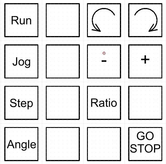

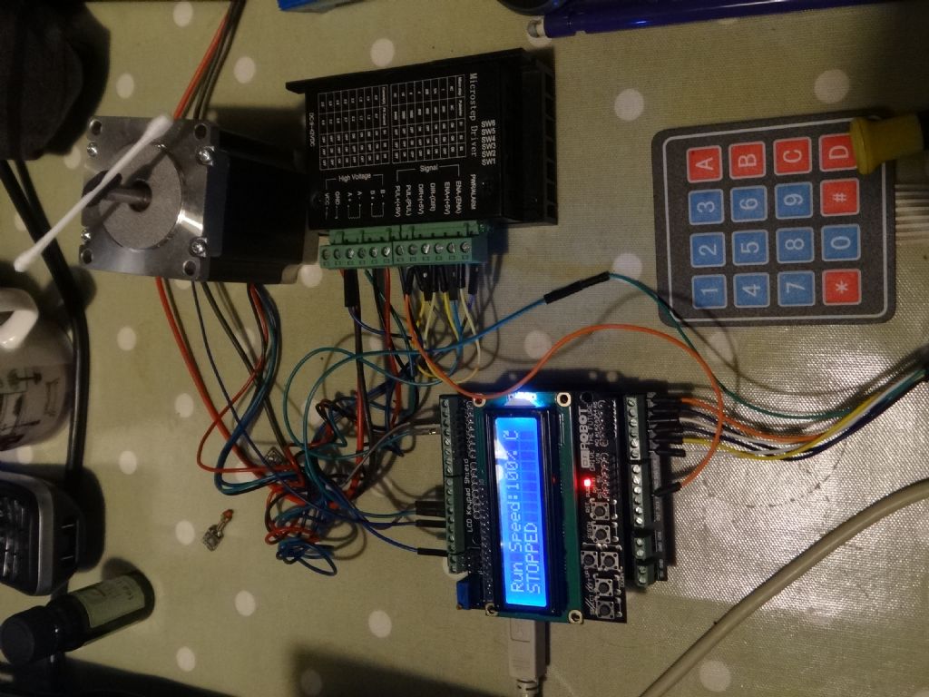

              A while ago John Stevenson suggested the controller would be easier to use from a keypad rather than nested menus. Unable to resist the challenge I immediately sat in my armchair.
              If anyone would like to try it, this dropbox link will let you download such a beast. No proper instructions but there's a pdf that should help. It uses the same motor connections as Carl's article and also works with the DF-Robot shield, though the push-buttons aren't needed. The keypad is a cheap membrane type about £2 from ebay etc.
              The control keys are laid out thus:
              Here's the lash-up.
              As well as eliminating the nested menus, I have built in more ratios (90:1, 60:1, 45:1, 15:1, 12:1, 3:1 and 1:1) and made it easier to add more. A new feature is that the indexer reports it's status back to an optionally connected PC, and it should be possible for the PC to control the indexer. (This remote control feature is untested.)
              Not implemented (yet) is keypress repeat. Otherwise the code replicates the same motor control applied by the Gary Liming's program as described by Carl.
              This is beta software offered "as is". It has only been tested moderately carefully. I would be grateful for any comments, bug reports, or criticisms. The display and keypad layouts are just as they occurred to me and no doubt could be improved. At the moment STOP/GO are on the same button: it may not appeal to everyone.
              I'm sorry I didn't anticipate JS's requirement for the indexer to support Morse Code. (Typical computer user, always changing what they want.) I could add CW quite easily if anyone really wants it. It should be easy because someone else has already written an Arduino morse decoder.
              Seriously though, Morse is sometimes used to signal audibly to the operator as part of a real man-machine interface. (Like SMS on mobile phones. And my old dishwasher did it. ) Not sure there's an application for that here though.
              Just for fun and interest.
              Cheers,

                This looks very interesting but one point and it's not morse wink
                Two other common ratios are 40:1 which is most dividing head and 72:1 for a lot of the cheaper import tables.
                It's peaked my interest and I 'may' have to send for an Arduino to have a play which after I have got back from a trip.
                Many thanks Dave.

                        Thanks Dave, I have downloaded the "ino" file and am awaiting keypads to arrive from China.

                            Just in case you haven't spotted it already, the ino uses the Brevik keypad library and won't compile without it. The library is installed using the 'Manage Library' part of the Arduino IDE.

                              Dave, yes I noticed that in the comments and installed the library. Compiled first time. All I need now is the keypad!

                                      Duncan, as it was written originally it can do number of divisions. I tried mine out with a an offcut in the chuck on the table I set divisions to 7, a nice odd number. Then drilled a hole, step, drill hole etc. and I ended up with 7 holes that looked equi-spaced. Just to see what happened I went round the circle again and the drill went neatly into each hole without apparent deflection. Just to see what happened I ran it in reverse and the drill again dropped neatly into each hole. So the system seems to work. Not able to measure accurately enough to tell the angle the holes are at but seems pretty good for a simple test. Probablt accurate enough for my needs.

                                        Not difficult to modify the code to use separate STOP / GO buttons. At the moment I use a single button to toggle STOP/GO. The code is:
                                        case 'G': // GO / STOP toggle
                                        rstatus.go = !rstatus.go;
                                        break;
                                        After assigning 's' to the STOP button, you would change the above to:
                                        case 'G': // GO
                                        rstatus.go = true;
                                        break;
                                        case 's: // STOP
                                        rstatus.go = false;
                                        break;
                                        What's complicated about using the numbers on a 4×4 keypad is fitting in the functions. Run, Step, Jog, and Angle can be assigned to F1 to F4, but what to do about ratio?
                                        Duncan is interested in numbers too so I'll have a think. Ideally the solution shouldn't involve nested menus! It may be necessary to use a 5×4 keypad like this one.
                                        Apart from the labels your keypad is probably the same as mine so the program should still work. I would like to make an overlay that goes over the existing key labels but that's an unsolved problem.
