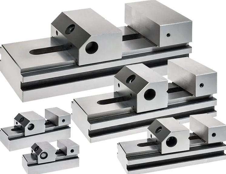

                        I wondered if the vice was one of these?
                        precisionvice
                        Adam Savage mis-adjusted one whilst demonstrating his new PM728V mill, so it clamped with the moving face tilted and came loose.  I think it’s in this Youtube Video.
