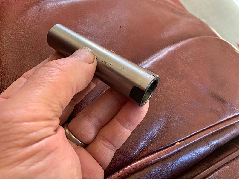

      I have recently aquired a (barely) used Chester 626 Mill. It was a probate sale, so the seller can't help me.
      It came with no tools and the manual doesn't help.
      There is a reducer in the spindle to take 2MT tooling. I want to know how to remove this reducer. The reducer itself looks to be 3MT, it is not held in with a draw bar, the draw bar was screwed into the 2MT chuck.
      There are two flats on the reducer that suggest it unscrews but I'm not sure. I'm guesing there should be some sort of keyed spanner to lock the rotation of the spindle but again, I'm not sure.
      Before I go to the lengths of sourcing a correctly sized keyed spanner, can anyone advise me on the correct way to remove the reducer, please?
      Thank you

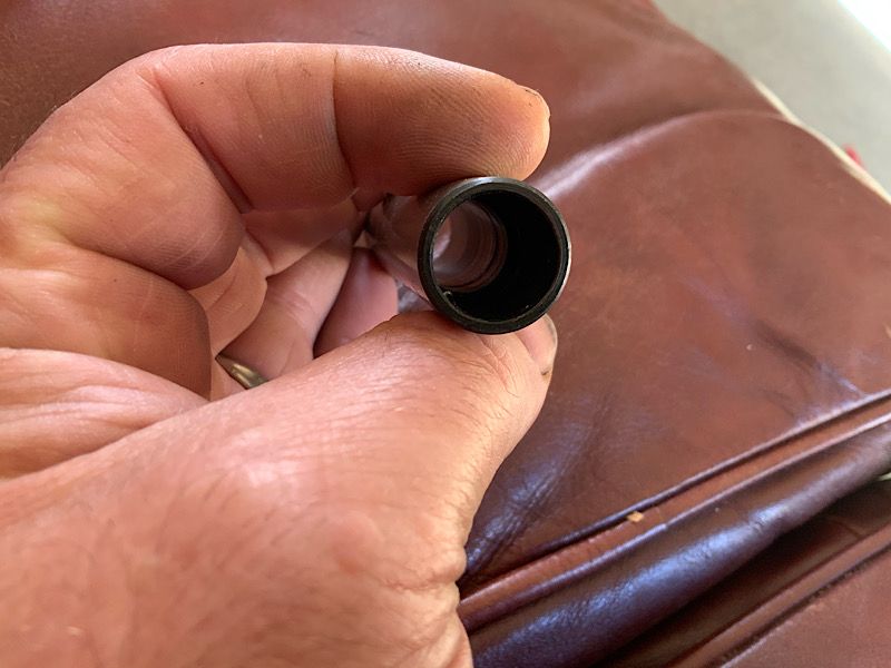

                      094989fd-f3db-40c4-9d59-ddd4e07fe06c.jpegThis what you will have up your spindle
                      Edited By Ian Parkin on 01/11/2020 11:53:37

                          Thanks all, especially Martin, for the link to the Grizzly manual. It is much better than the one it came with.
                          There is no slot in the quill.
                          It does appear to be simply a 3MT to 2MT reducer, the internal diameter of which is the same as the internal diameter of the quill so I can't knock it out.
                          I think then I have two options;
                          The one which will take a little more time but be less likely to do damage will be to knock up something to lock the spindle, then try and twist it out and if that doesn't work, drill and bolt through the adaptor, then try and knock it out from above, using supports as Dusty has suggested.
                          Thank you all.

                              Arc sell this adapter, and say the flats are used to twist it out with a spanner. The drawbar passes straight through to engage whatever is held in the open end.

                                A spanner to twist the sleeve is all you should need, to remove it.  This is assuming (hoping) the sleeve was not inserted, while cold, into a warmed machine🙂 ).
                                Check out what Arc say about it.
