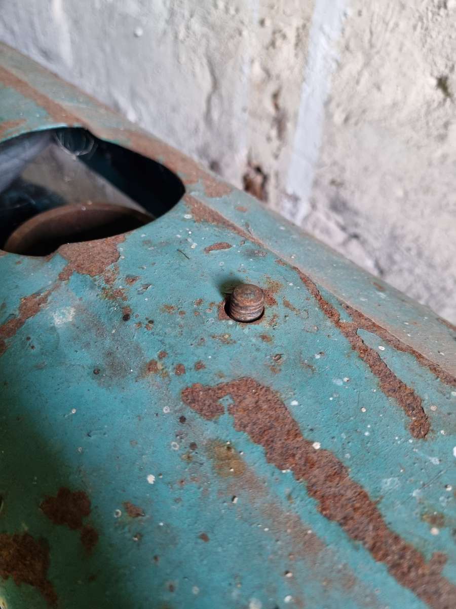

      I am about to start the restoration of a Meddings Driltru bench drill. Unfortunately mine is missing the thumb nut for the belt cover.
      If anyone has one of these drills I would be greatful of a closeup picture of said nut, with some dimensions, so I can make one.

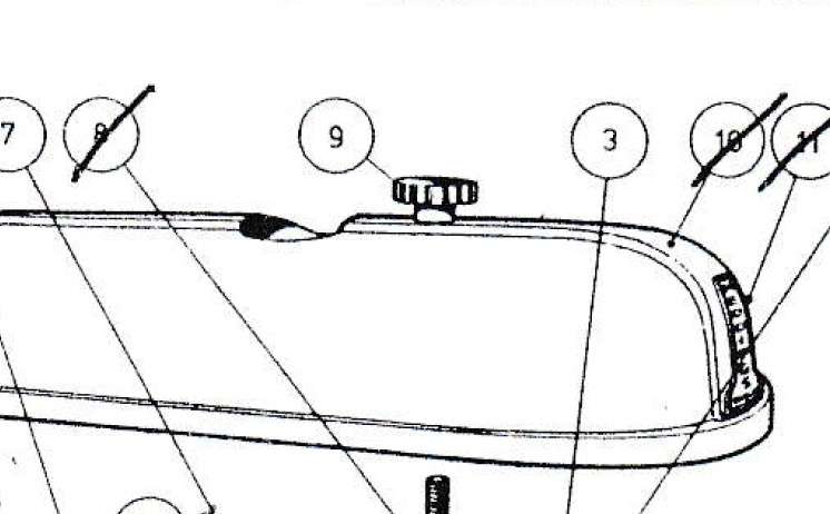

            Like the other current Meddings thread, I would direct you to Vintage Machinery’s web site where there is a wealth of manuals and other material for instant download  That link takes you straight to the exploded parts diagram of a Mk2 Driltru, from which I took this magnified screenshot of the belt cover retaining thumbscrew:
            Meddings thumbwheel
            Combine this with the dimensions provided by Noel and you should be able to come up with a suitable replacement, even if it’s not an exact replica.  The picture on the lathes.co.uk that I looked at wasn’t quite as clear as the one above.

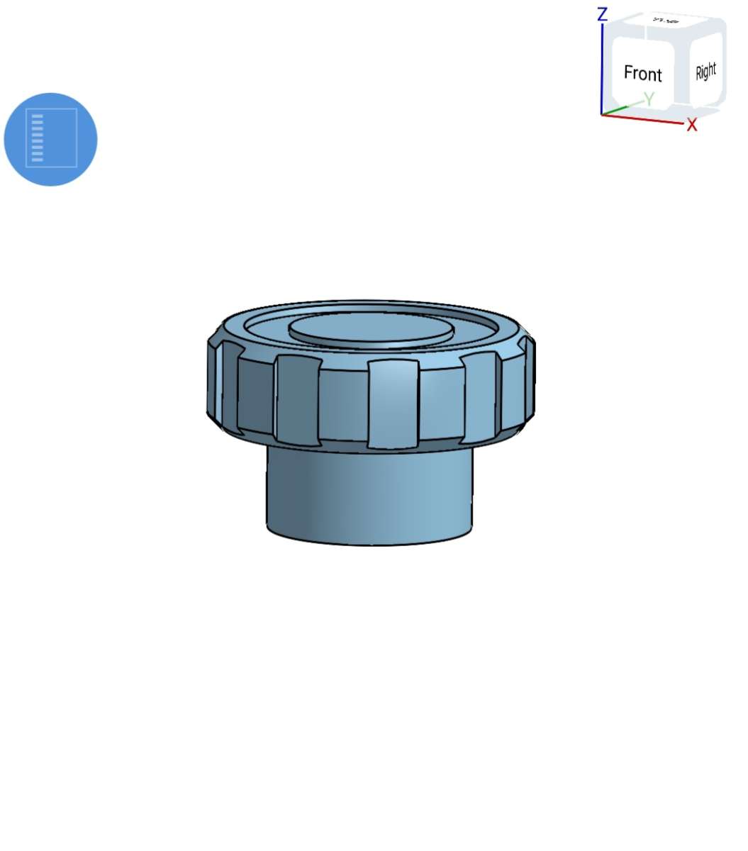

              Thanks for the replies. My research leads me to believe they were fitted with a knob as pictured below (Meddings drill but different model, best picture I could find off the net) This also matches the drawing as provided by John.
              I have modeled one up and as best I can tell, the diameter should be about 1.25″ and should be about 3/4″ tall. I think i will make one and see how it looks. From a functionality point if view it doesn’t matter, but I like to restore them close to original if I can.

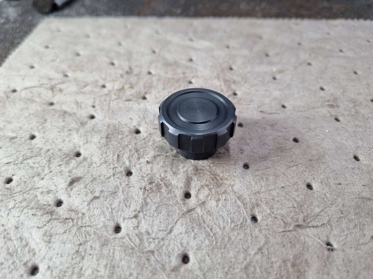

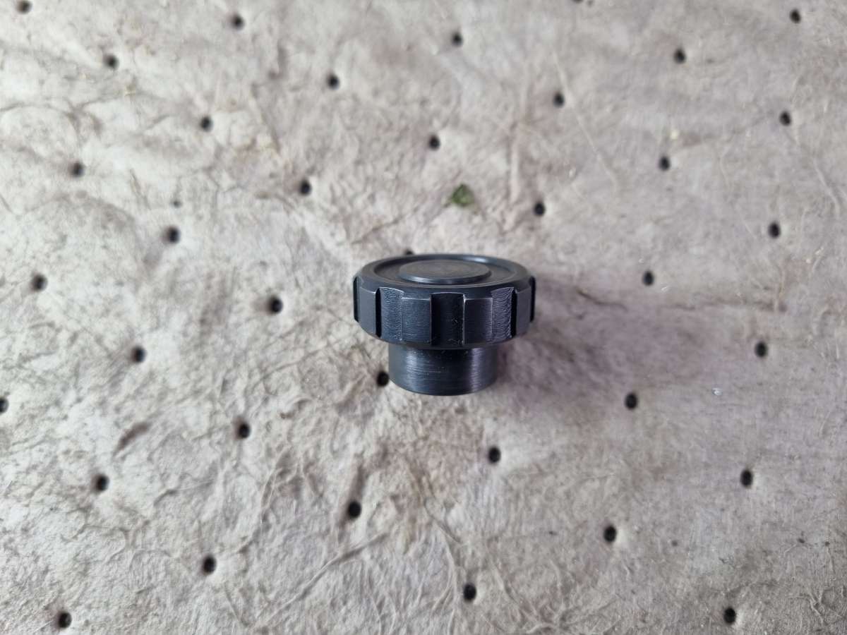

              Craig Brown
                @craigbrown60096
                Well I made one. The dimensions look about right.
                20250620_083928
                20250620_083937
