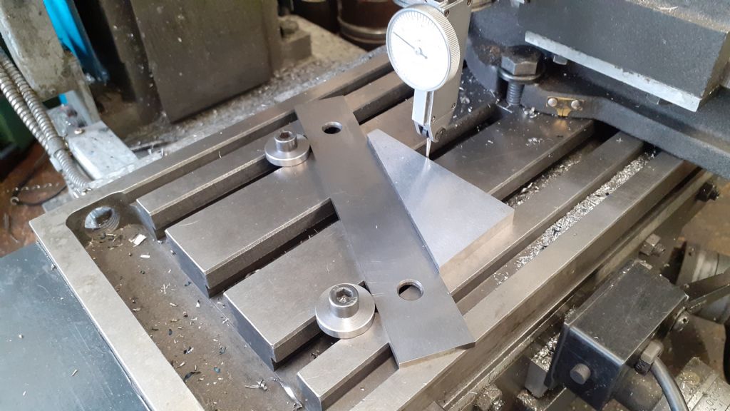

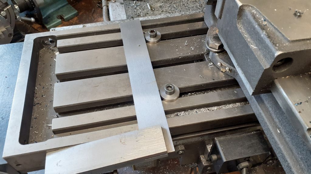

        Anonymous
          For aligning the machine vice I set it roughly parallel using the bolt slots and a T-slot. Nip down the lefthand bolt and then indicate the rear of the fixed jaw. If the indicator moves tap the vice to bring the indicator back to the original reading. Repeat as needed. Tighten both bolts and do a sanity check pass. The whole operation takes less than minute to get within 1 thou in 6".
          For aligning parts on the table I use two methods. One, a length of gauge plate in the T-slot as a fence. Two, I made a couple of cylinders with spigots that are a close fit in the T-slots. These can then be bolted as far apart as needed. The two cylinders were ground as a pair, so they are within a tenth of each other. My mill is industrial, so the T-slot is aligned with the ways. The methods don't work if the T-slots and ways are not aligned.

              Much the same as Andrew here with regards to dti on the vice fixed jaw and a couple of round bosses with spigots that can be fitted to the tee slots.

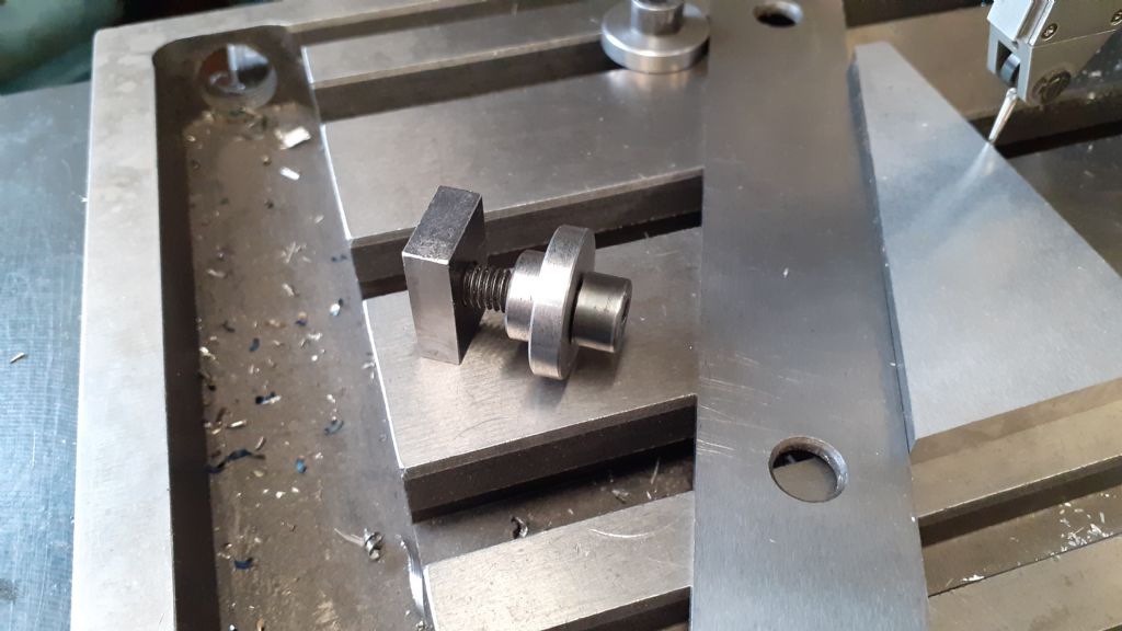

                  Ok so do the boss/spigots need to be bolted down into the slot or can they just be dropped in and held by hand until the workpiece is secured?

                      Anonymous
                        Posted by Dr_GMJN on 14/05/2021 14:56:42:
                        I bolt down as the work is often on parallels, so I can drill through, and the cylinders would tilt when the work is tapped into contact:
                        Mid left above is a third cylinder, of a different size, used as a stop. I forgot that I made two short cylinders, mostly for stops on the CNC mill, but also used to align parts on the manual mill, see bottom right:
                        Andrew

                          I also bolt mine down, you don't just have to use them for work along the table you can also set them at right angles or at an angle set with a square or DTI. I could do with making some taller ones but usually just stand a tall block in front. If your tee slots are out then just make the spigot a bit smaller, rest a straight edge against them and adjust until the straight edge runs true.

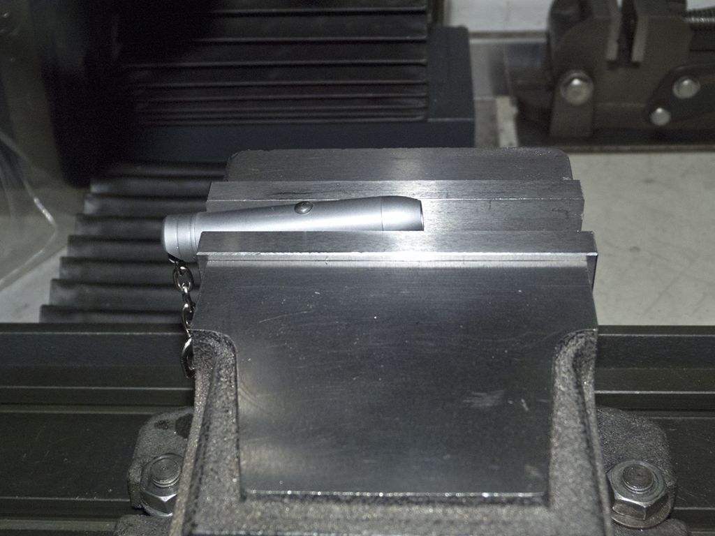

                            Re "Are there any tips/tricks/standard procedures for doing this more efficiently? "
                            Not professing this to be more efficient, nor is it a standard procedure but it might qualify as a tip……..
                            • Ensure vice is pulled back so mounting bolts are tight against T slots, tighten bolts enough for light grip.
                            • Use one of the methods (dti against a parallel?) for aligning your vice with the mill table wound right out – or in – so its hard against the stop. Tighten the vice down.
                            • Lightly clamp a laser pointer (ideally metal bodied, there''s one for GBP1.99 on Fleabuy) in the vice jaws so the spot shows on a far surface.
                            • Now you need a vertical line right under the point (I find thin black felt tip line on small piece of baking foil glued to wall is best with a red laser).
                            • Despite the invited ridicule, I find this to be reproducibly accurate with the mill table in original full out (or full in) position to reset the vice parallel to table movement.

                                  Posted by Fowlers Fury on 14/05/2021 16:33:39:
                                  Ive not got hard stops on the table.
                                  Doesn’t your method rely on the laser axis being absolutely co-axial with the body? I’ve had a couple of laser collimaters for my telescope, and even with those the dot describes a circle on a distant wall, if the body is rotated in a v-block.

                                          "I've not got hard stops on the table."
                                          I should have been more explicit. By "hard stops" I meant at the end of the lead screw (threaded rod) which moves the mill table i.e. the point at which the table wont move further. It is the reference point for repeated measurement.
                                          "Doesn’t your method rely on the laser axis being absolutely co-axial with the body? I’ve had a couple of laser collimaters for my telescope, and even with those the dot describes a circle on a distant wall, if the body is rotated in a v-block. "
                                          Apologies for previous brevity again. I don't believe that "being absolutely co-axial with the body" is too critical providing the laser pointer is held in the vice jaws at the same angle to the horizontal (hence shining on the cross lines on wall). The cross lines in the workshop are about 4 metres from the laser source so when lined up, it repeats the original, DTI-based, set up accurately enough. I do check from time to time and haven't found significant change. Below is a picture taken of the laser spot centralised.The image is poor as the laser spot didn't focus well.
                                          One of those many jobs awaiting my getting 'a round tuit' is to mount the laser pointer in a substantial block which would sit within the vice jaws at the correct angle and orientation just to save a few minutes each time.
