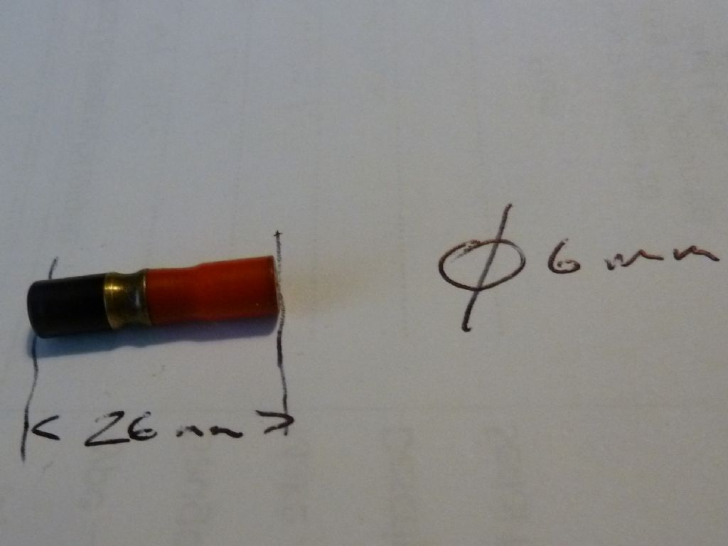

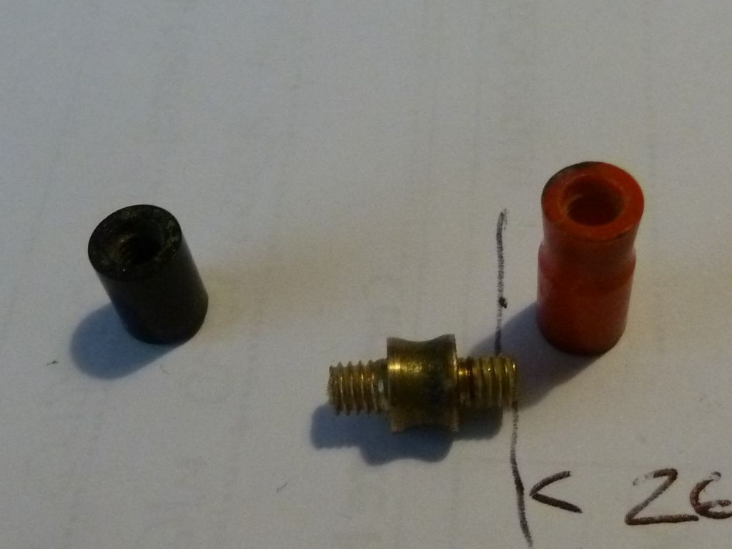

      Found this in one of Mum's old button boxes.
      Red & black plastic with brass centre portion so suspect electrical, but no real idea. The ends of the caps are not pierced.
      Any clues?

        Circlip
          @circlip
          Push button part of a switched lightbulb socket.
          Regards Ian.

              Posted by Circlip on 24/10/2017 14:27:44:
              Regards Ian.
              Yes indeedy! Takes me back 40 years or more to playing with abandoned bits form my dads shop. Two sprung contacts and this between them. Press in red and the contacts sit in the groove in the plastic, press in black and the contacts are shorted lighting the bulb. Similar thing usually part of a table lamp bayonet socket.

                Possibly came out of Mom's sewing lamp and ended up in her sewing box.
                Unless she thought because of the groove around the middle it was a toggle like those wooden ones they had on the old black duffel coats back in the day (if you had them there?)

                  Looks like part of an old insulated terminal to me

                    I think the lamp switch takes the honours.
                    Until Neil mentioned it, I had not registered the significance of the groove (detent?) in the red plastic part.
                    A pint will be supplied on demand to the winner (Circlip) in the Castle, Wem between 1930 and 1932 on the 30th April next year.
