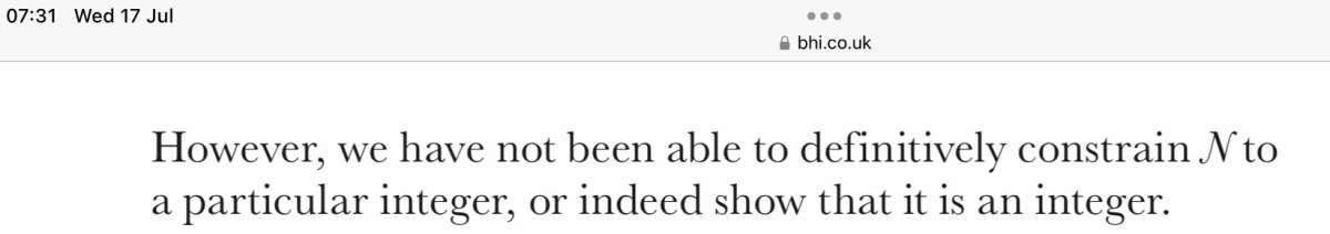

                            #741687
                              … not really conclusive
                              IMG_9926
                              #741695

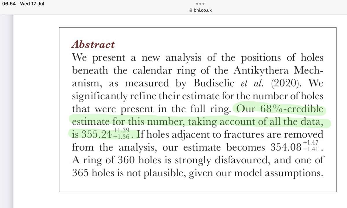

                                Lest it becomes lost in the noise … I must share this which [after all those big words and hard sums] I consider to be the punchline:
                                IMG_9927
                                #741745
