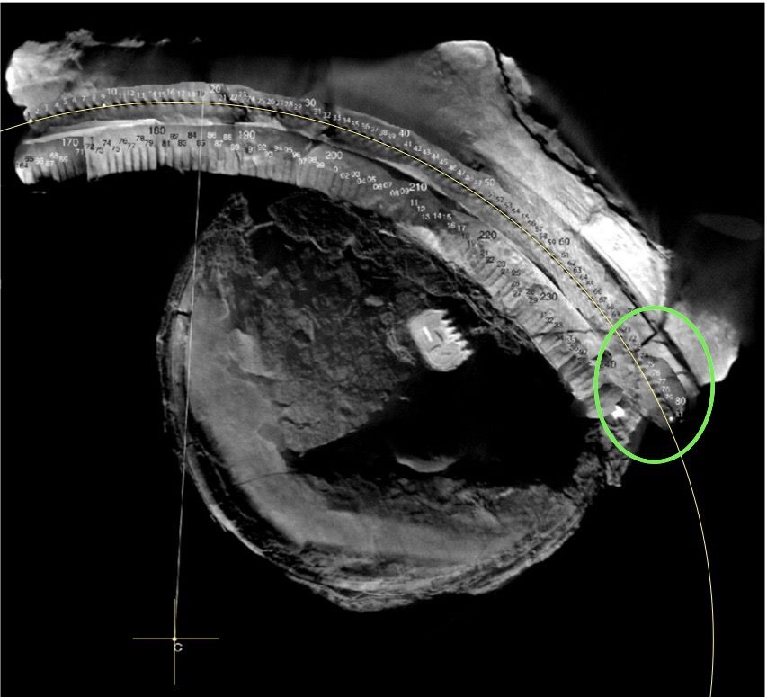

          Posted by Michael Gilligan on 05/10/2021 15:08:59:
          Thanks, Neil … it also answers the question posed in my P.S.
          But, unfortunately, I am not entirely convinced by their Least Squares Fit
          … see the substantial deviation from the circle within my green Region of Interest :
          If we are trying to decide how many holes there must be in the full circle, then we need a good estimate of its radius.

            Posted by Michael Gilligan on 05/10/2021 18:03:53:
            That also looks like an area of damage, I suspect that without all the corrosion it would no longer be attached to the rest.
            #565719
              Posted by Dave Halford on 05/10/2021 20:28:43:
              Good point, Dave
              … so we’re down on valid hole locations
              #565741

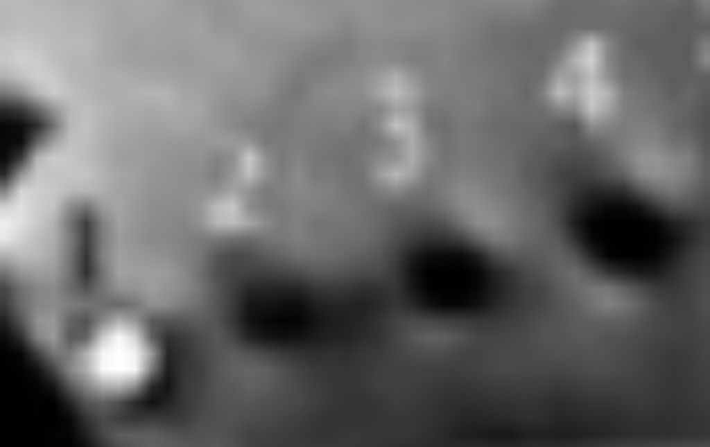

                Taking Neil’s best available image : **LINK**
                https://www.researchgate.net/figure/Fragment-C-showing-degrees-of-longitude-on-the-zodiac-scale-as-well-as-the-holes_fig5_252678779
                They have obscured the hole numbered 1, so I suggest we need to start at 2
                The presumably-displaced group starts at 73 … so realistically we have 2 to 72 available for investigation.
                I plan to measure the angle subtended by various groups of holes and do some simple statistics
                … The big problem is the low resolution of the image, and therefore the difficulty in locating centres of holes !
                360/355 is difficult to distinguish from 360/354 when you are measuring fog. …
                  The paper mentions the fracture.
                  On the plus side, i measured the distances from hole 1 to 41 and 41 to 81 as being the same.
                  (They shouldl have numbered the holes 0-80 IMHO).

                      (a) True, but [rather worryingly] they appear to be using those displaced holes
                      (b) What were you measuring ? … chords and/or subtended angles ?
                      (c) Agreed
                      Note: The white dots at [or near] holes1, 9, and 81 are theirs, not mine.
                      … and I don’t think they are sufficiently accurately placed to decide between 354 and 355

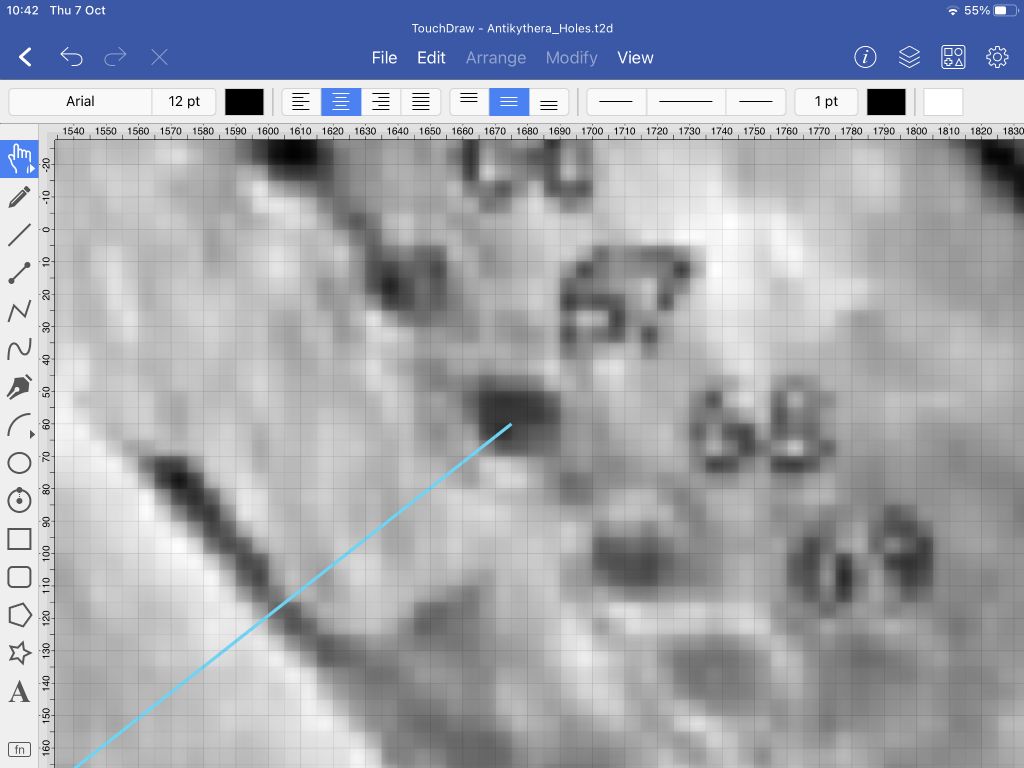

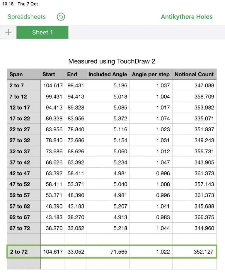

                                Well … I’ve had a go, and it’s even worse than I anticipated crying 2
                                First I scaled the photo up by 500% and then drew lines from the marked centre to [my best estimate of] the centre of various holes, and recorded the angle subtended by each five steps.
                                Tabulated and calculated:
                                The result is, to say the least, unconvincing !
                                It is, however, reasonably predictable when we remember that tiny angular difference between 355 and 354 holes.
                                If anyone would like to repeat the exercise, as a check on my work … Please Do

                                  Here’s a ferinstance of the fog which we are attempting to measure:
                                  dont know
                                  #565916

                                          Quite so … but the measurements of the available fragment [or rather it’s X-Ray image] have been used in the attempt to determine that number.
                                          My own feeble effort has demonstrated [to my own satisfaction] that such determination is basically futile.
                                          Personally … I think we have a ‘duty’ to discuss such matters.
