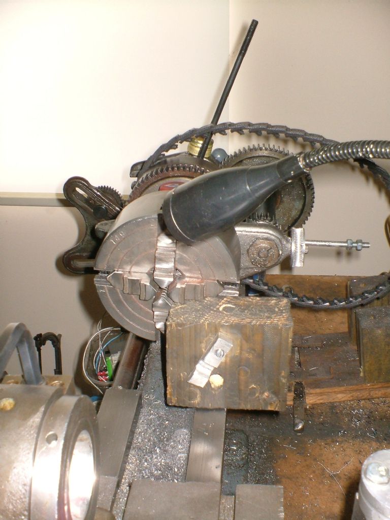

                Just run your lathe backwards on the backgear by hand to unstick a chuck
                I put a block of wood braced on the bed under a chuck jaw and voilla!
                With a backgear lathe you never have a stuck chuck
                I have put a bar in the oil hole of the pulley to give me more control

                        Ady your statement that with back gear you never get a stuck chuck,there is also a very good chance that it will result in back gears with a few teeth missing. use a rag with a drop of 3 in 1 oil to wipe the nose thread,should a lathe be left left idle for a long time then loosen or remove the chuck. Especially on machines that have a pumped cooling supply of soluble oil.
