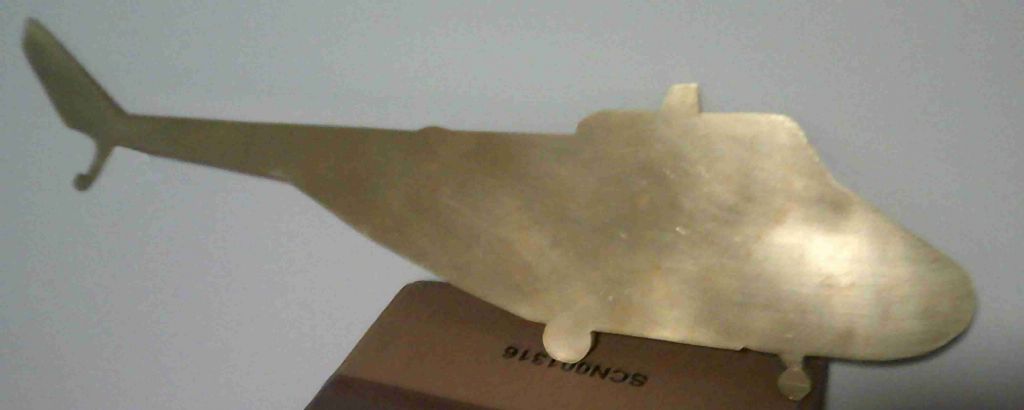

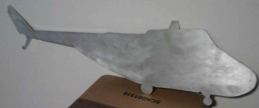

        G'day all.
        Had a severe attack of 60s/70s work-related nostalgia and started to quench it with a couple of potential wind vanes. The first was in brass sheet, the second in thicker ali. My limited knowledge says that the ali version would be the better base. If this is agreed, the intended finish would be S&R helo yellow (Halford rattle can) but what surface preparation is required and (more importantly) what sort of final coating would best withstand constant salty air exposure? Suggestions most welcome with simplicity the priority!!
        Thanks in advance
        rgds
        Bill

          If restricted to aerosols I'd sand or blast it and etch prime, colour coat then use a car sill or motorcycle fork paint protection lacquer.

                Plus one for etch primer, nothing will stay on aluminium for long without it. At this time of year consider using a workshop heater to get reasonable drying time. It has been 0 to 1 degree here in rural Midlands early some days.

                    Aluminium, prime with zinc chromate, then paint with a 2 pot reaction lacquer, but with you being close to the sea, if you want it in metal, go for stainless steel, 1.5 mm to 2 mm, or plastic.

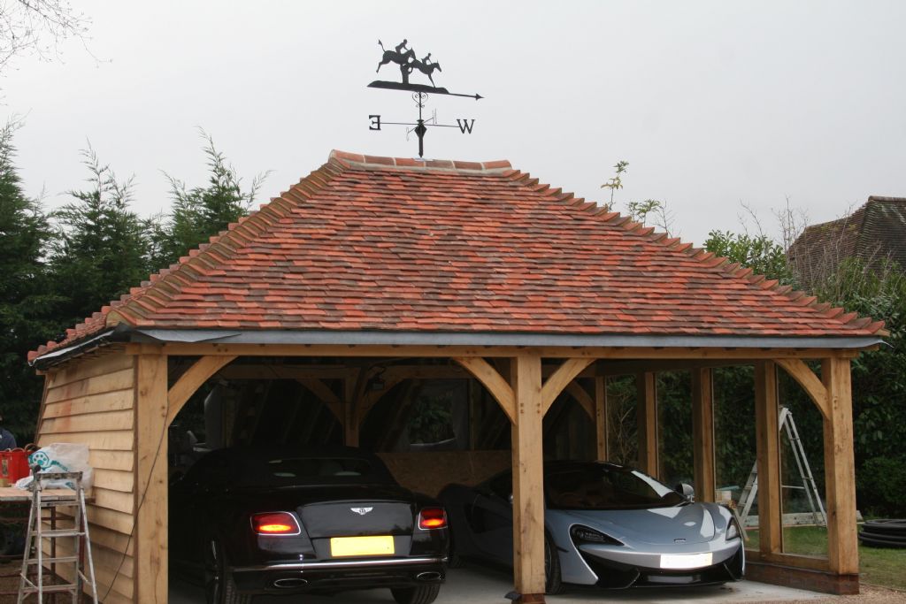

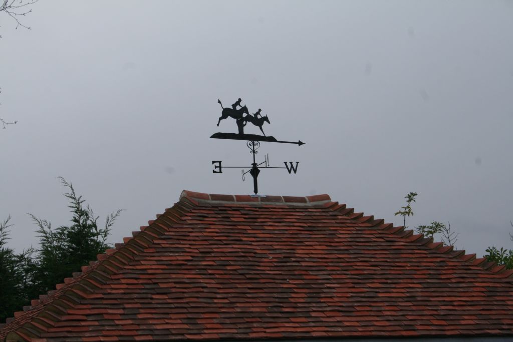

                          I made one a couple of weeks ago , I just painted it black ..no salty atmosphere around here though. laugh
