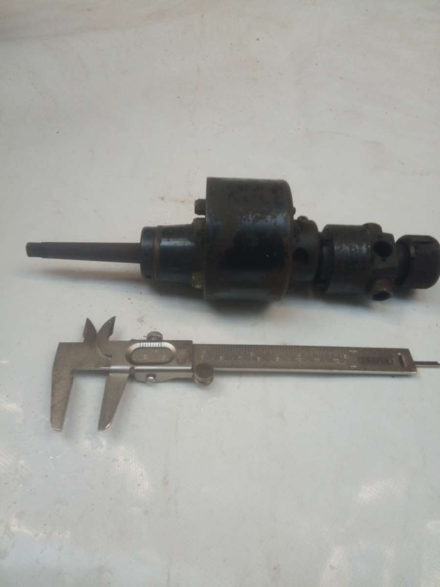

      IMG_20240110_111154
      As the title, any contributors know what this thing is.
      Thanks in anticipation.
      Dod
      #710391
      malcolm wright 3
        @malcolmwright3
        Tapping head for a pillar drill
        #710407
        Colin Heseltine
          @colinheseltine48622
          Archer Tapping Head
          #710413
          dodmole
            @dodmole
            Thank You for the information now all I need to do is to free it up, clean and then find a use for it.

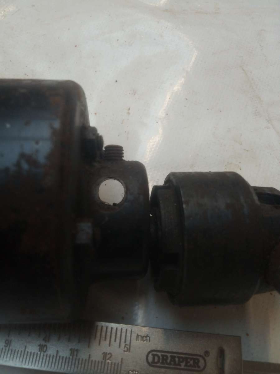

            Nigel Graham 2
              @nigelgraham2
              It should have a fairly long arm projecting from, probably, a tapped blind hole in the side of the body. This rides against the drilling-machine column to prevent the tapping-head spinning with the rotating spindle.
              If missing it’s just a plain length of mild-steel with a short thread on one end to match the device.
              Use it at lowest machine speed – mine is on a “Progress 2G” machine in low gear and lowest belt speed.

                <p data-wp-editing=”1″>IMG_20240110_111325</p>
                #711435
                dodmole
                  @dodmole
                  That there hole there I presume.
