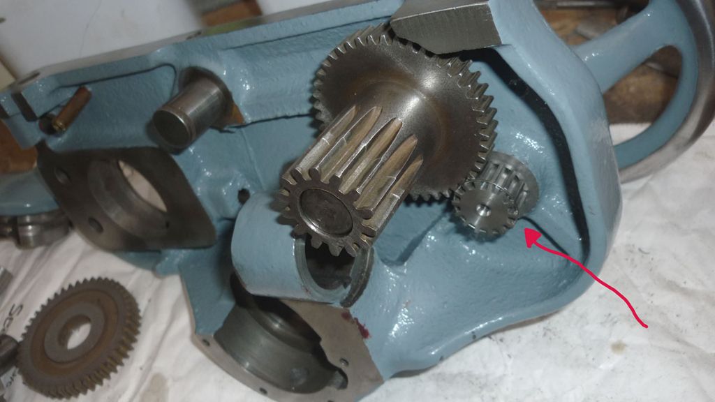

      Haven`t had time to try this rotary table yet as been busy restoring a much larger mill.
      But thought i would give it a try on my mini mill.

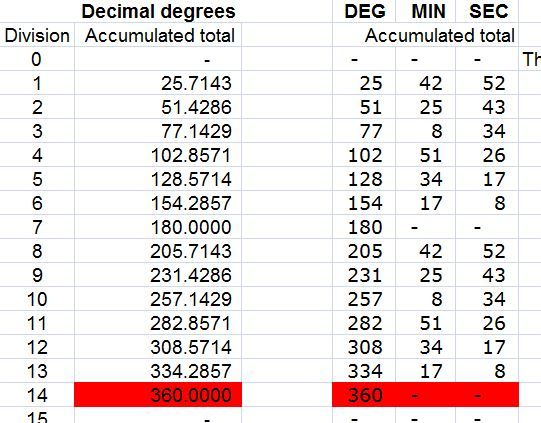

      How do you cut a 14teeth pinion gear without dividing plates?? The table is 72:1 ratio so 5 degrees per revolution.
      I stress that ive never used one before. I have a arbor and the right cutter size(14dp 14 1/2 PA No.7) .
      The photos show what i want to do , its the pinion gear for the apron handwheel. I have two worn ones and on this apron the hole for some reason is almost  3mm larger than it should be and someone bushed the pinion shaft with brass. The hole should be 15mm or thereabouts and is now 17.3mm .I cant believe the hole had worn so much in something that is only turned slowly even under powerfeed. The pinion gear on the left of the top picture is how thick it should be,

        I came up with this but how do i do it??

          If you go over to the Homemodelenginemachinist.com forum, someone just today posted a thread on Using the Rotary Table that includes a pretty handy downloadable 25 page PDF instruction manual on how to do it.
          Here **LINK**
          Basically you will have to use the graduated collar on the handwheel to advance the RT by 25.whateveritwas degrees at a time. Maybe not as accurate as indexing plates but good enough for a rack feed gear I reckon.

            Posted by mark smith 20 on 29/10/2016 12:24:54:
            Use this, and make a temporary dividing plate [seven holes or notches should do nicely]
            http://www.cgtk.co.uk/metalwork/reference/divider
            #263614
              I probably should have mentioned:
              With a 72:1 ratio, and a seven hole plate; you then want five full turns plus one division, per tooth.

                #263628
                  Wrap a bit of paper around the base of the handle and mark it so it's one full turn. Take it off and divide it into seven sections as accurately as you can.
                  Number the lines 0-6. take cut one line up with 0, cut two five turns + 1, cut three five turns + 2 and so on.
                  You should find this is easily accurate enough for your needs.

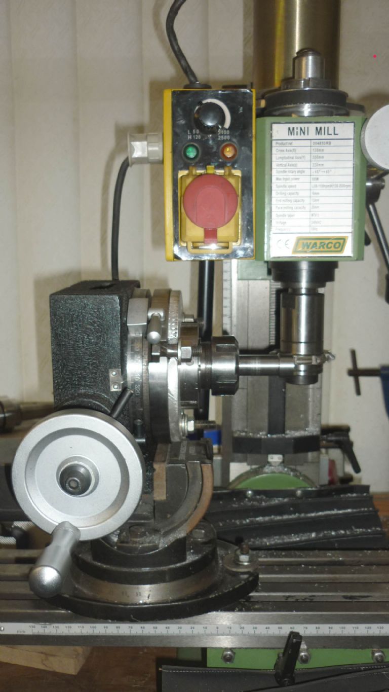

                    Discovered i couldnt quite mounted the table securely and havent any clamps suitable ,so set it up in the vice like picture , will this work or too unstable . I tested the cutter on some aluminium and it worked fine ,full depth with little vibration.
                    Problem now is im finding it hard to see the dials due to the position of the set up. It will have to wait till tomorrow now.surprise

                      I dont want to rain on your parade but the rigidity of the whole setup is suspect.
                      For a start, since you have a milling machine you could make whatever is needed to mount the RT direct to the bed. Another issue is that the cutter is a long way from its bearings, Also the job itself has more overhang than ideal.
                      The table bearing in RTs are generally pretty basic and some appear to rely mostly on gravity to keep the one main load bearing surface in contact.
                      Regardless of the size of the mill, the less you have to raise the head of the milling machine the better, yours is only a small machine and it has the extra flexibility introduced by the column tilt feature.

                        Ian, no problem at all, it looked less than ideal to me , so i may make some clamps ,i have another bigger mill but don`t have much tooling as yet for it or actually finished setting it up. .

                          Get rid of the vice and minimise overhang. Also, if possible provide tailstock support, even if it's only a block with a rod in it that has a 60º taper on the end.

                            You could do what I did to my home made RT – I screwed a 10mm thick plate with two fixing slots to one side of it. A bit of care meant that it's accurate enough to sue one edge of the plate with a square for setting up.

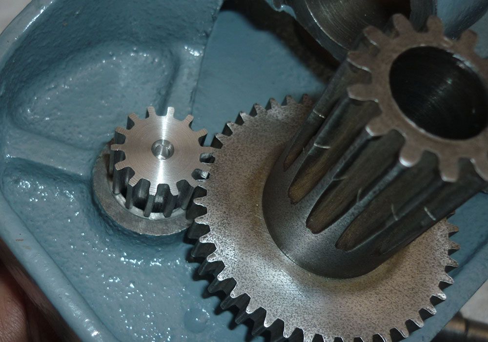

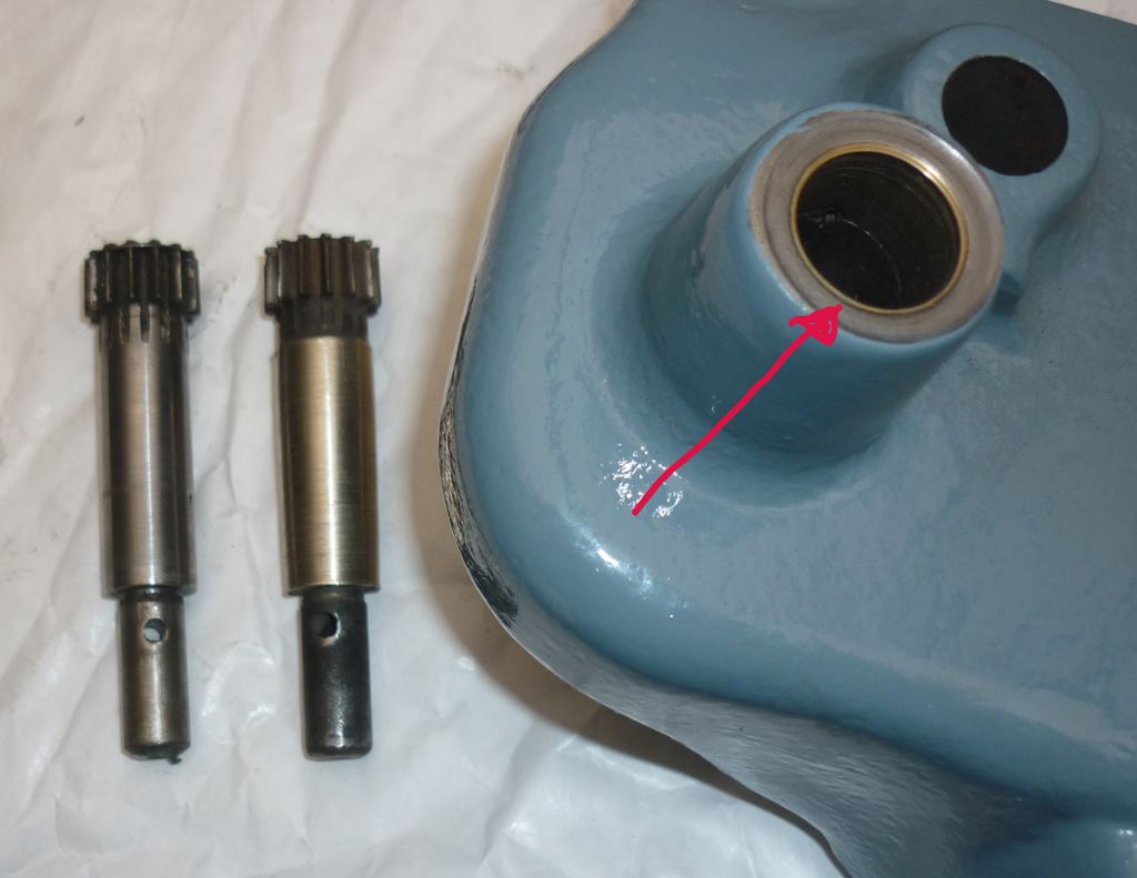

                              Well thanks for all the advice i managed to get it cut using the set up i had above but moved the blank into the collet chuck further . I worked ok as far as my limited experience goes with no vibration of the set up.
                              The shaft and gear work fine and a big improvement on how it was. Because of the thicker shaft the order of asembly has to be slightly different as the shaft hits the large gear next to it when your putting it in otherwise!
                              I now have to cut a very thin groove for a wire circlip thing on near the end of the gear . This holds on the floating larger double gear next it. Whats the best way of doing this a fine slitting saw?
                              Thanks

                                  I don't want to pee in your soup, either, but those tooth profiles on the pinion don't look right to me.  Too much material taken out at the root. Compare them to the tooth form on the larger gear and the gear cutter, for that matter. I guess it will work as long as it doesn't have to take too much torque.
                                  Edited By John Hinkley on 30/10/2016 16:06:05
                                  #263821
                                  mark smith 20
                                    @marksmith20
                                    John , you may be right i don`t know ,as i said its my first attempt. Remember the other gear is worn as well.
                                    Do you mean ive cut slightly too deep?
                                    Its bound to work better than what they were they were worn to sharp points.
                                    The cutter match the other gear tooth profiles exactly , so not sure how it can be radically different .

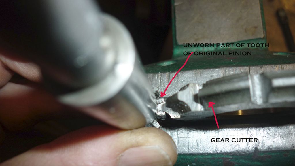

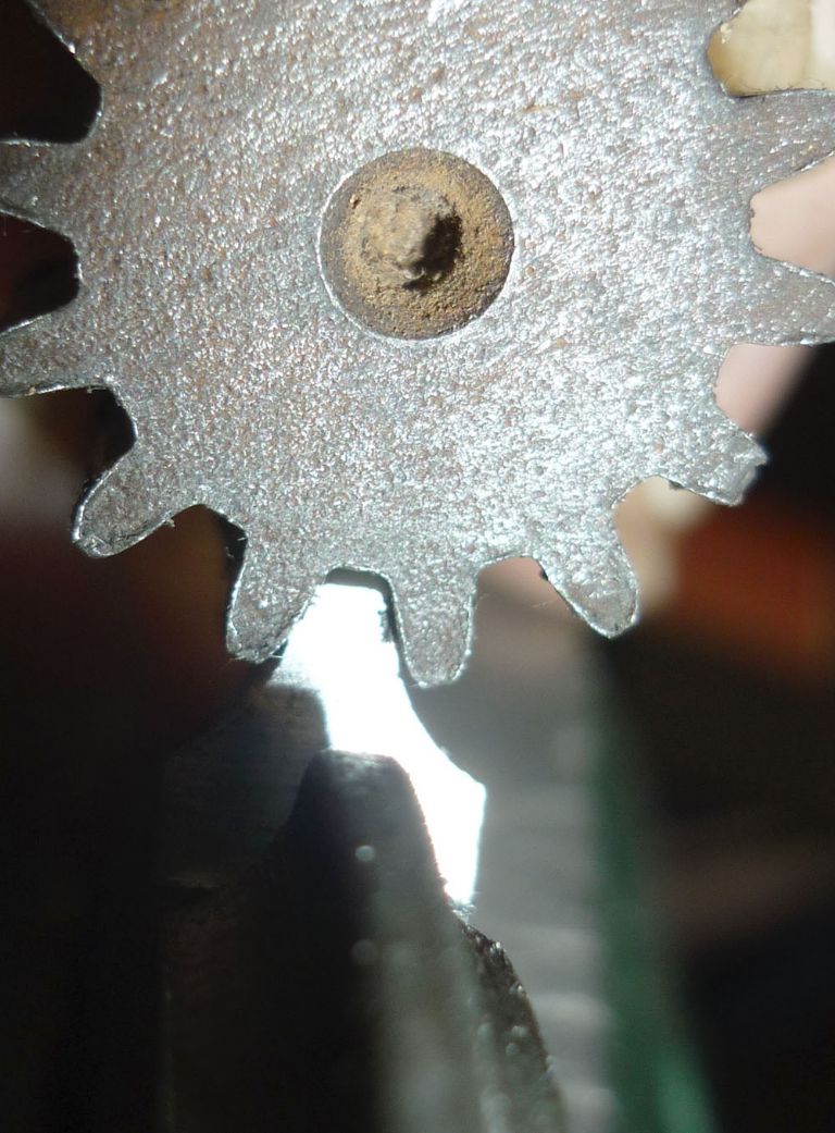

                                      Heres the gear cutter compared to the original pinions teeth taken on the unworn parts , the cut new one matched as well.
                                      The photo of the three pinions side by side with the new one,the new one gives the appearance of a deeper cut as the shaft is thicker so it has cut deeper into that part . The original shaft was supposed to be 15mm approx but the new one is 17.4mm.
                                      The cutter in the second photo looks off but that is just shadow caused by the flash.
