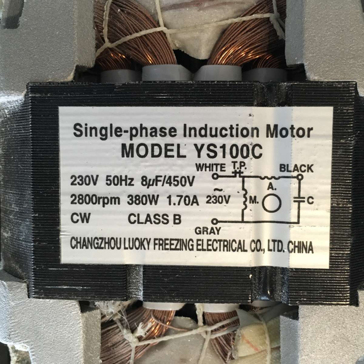

                    First let’s confirm, yes the motor is [as mentioned in the instructions] bi-directional.
                    With no other connections, I have done some approximate resistance measurements with my old analogue meter:
                    Motor Black to Motor Grey is 60 Ohms
                    Motor White to Motor Grey is 30 Ohms
                    Motor White to Motor Black is 30 Ohms
                    … ergo : I think TP might just be ‘Tapping Point’ or some-such.

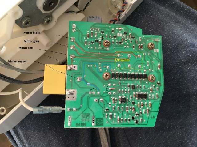

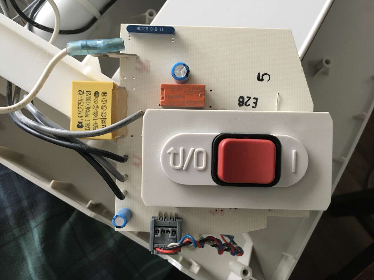

                    For completeness, I have also taken a photo of the top of that PCB
                    … the long blue piece is a reed switch that detects the presence of the collecting bin.
                    … I presume the Yellow capacitor has something to do with the direction-switching.

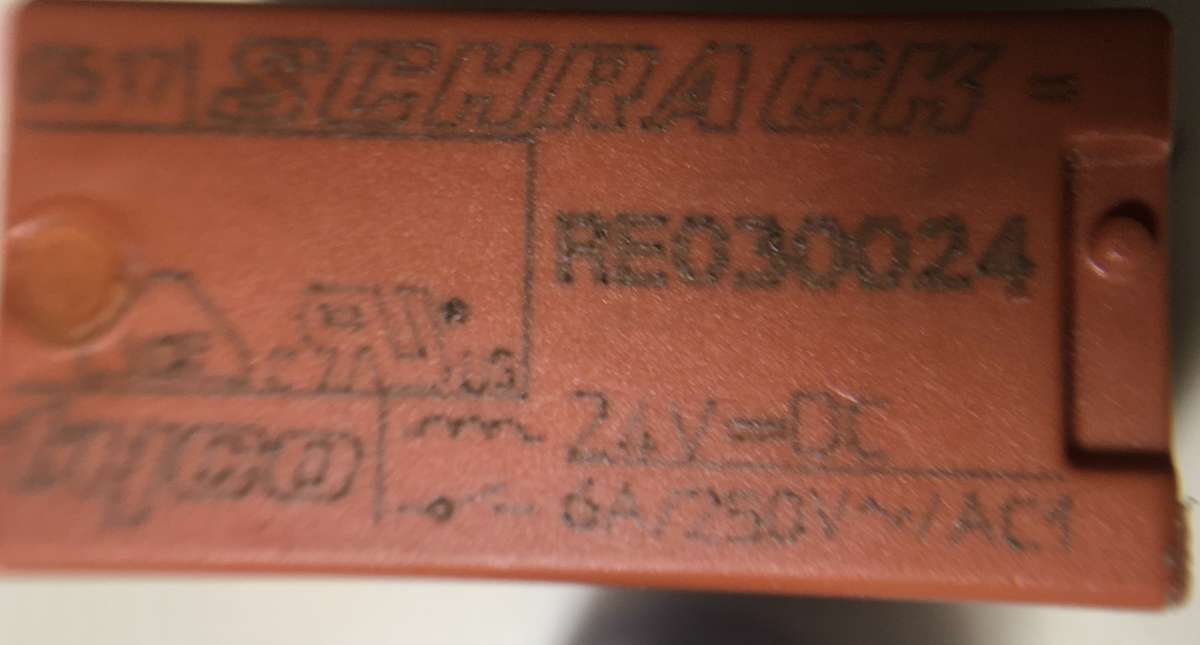

                    … the little Orange brick could be a relay [need to get a better image of it]
                    … the Grey connector goes to the optical detector

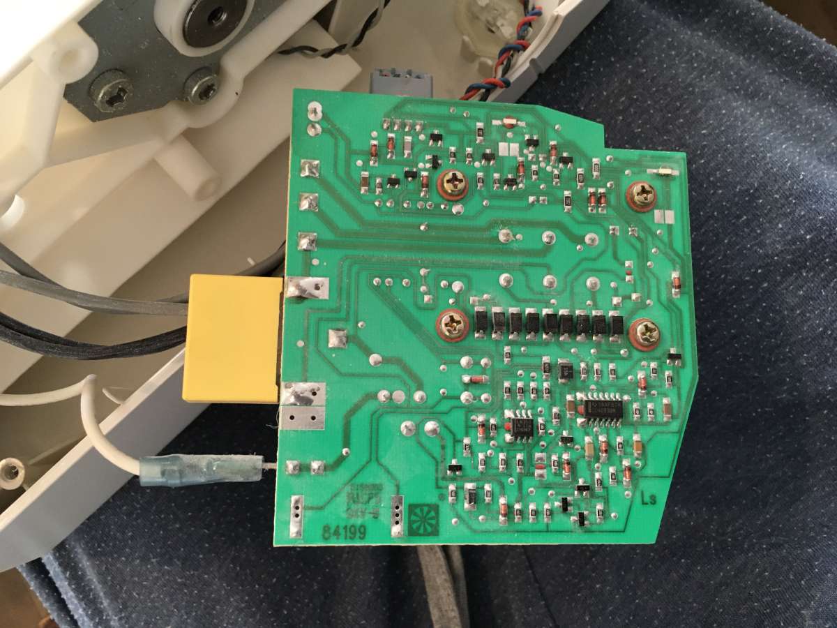

                    #724764
                      Dreadful photo, but I think it shows all the important numbers

                        Hi Michael, Connecting the  mains to black and grey is NOt the corrrect way to check the motor. With the black grey and white wires from the motor NOT connected to the cirguit board connect one side of the mains (Say neutral.) to the white wire. Connect live to the black wire. The motor should rotate in one direction. Then transfer the live to the grey wire. the motor should then rotate in the other direction. (If it just hums then the capacitor is nost likely the cause of the problem.)
                        NOTE The capacitor must still be connected to the black and grey wires from the motor for this test.

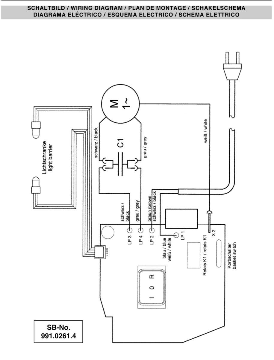

                                    Les Jones 1
                                      @lesjones1
                                      Here is a link to data on the small relay.
                                      I think the yellow capacitor 0.47 uF capacitor drops the mains voltage down to to a low level for the electronics befor it is rectified and regulated to supply the electronics. ( It will have a reactance of about 6.8 K ohms at 50 hz.)
                                      edit01 - Copy (Small)
                                      The blue track shows the path of mains neutral via the relay contacts to the white motor wire. The brown track shows the path of mains live to the black or grey motor wire via the rocker switch which selects the motor direction. The other pole of the rocker switch seems to rout the output of the 0.47 uF capacitor depending on the position of the rocker switch
                                      Les.

                                          Robert Atkinson 2
                                            @robertatkinson2
                                            Disconnect white, black and grey wires (the ones going to the motor and 8uF capacitor) from the PCB. Using a safe connecion method connect white wire to live 240V supply and either black or grey to neutral.
                                            INSULATE the unused wire!
                                            Apply power and motor should run one way. Changing the wire connected to neutral should run the other way.
                                            Given your previous tests if it does not run like this the capacitor is faulty.
                                            A 10uF capacitor will work OK but is not ideal.
                                            The TP device marked on the motor IS a Thermal Protector. From your previous tests this does not appear have tripped.
                                            Robert.

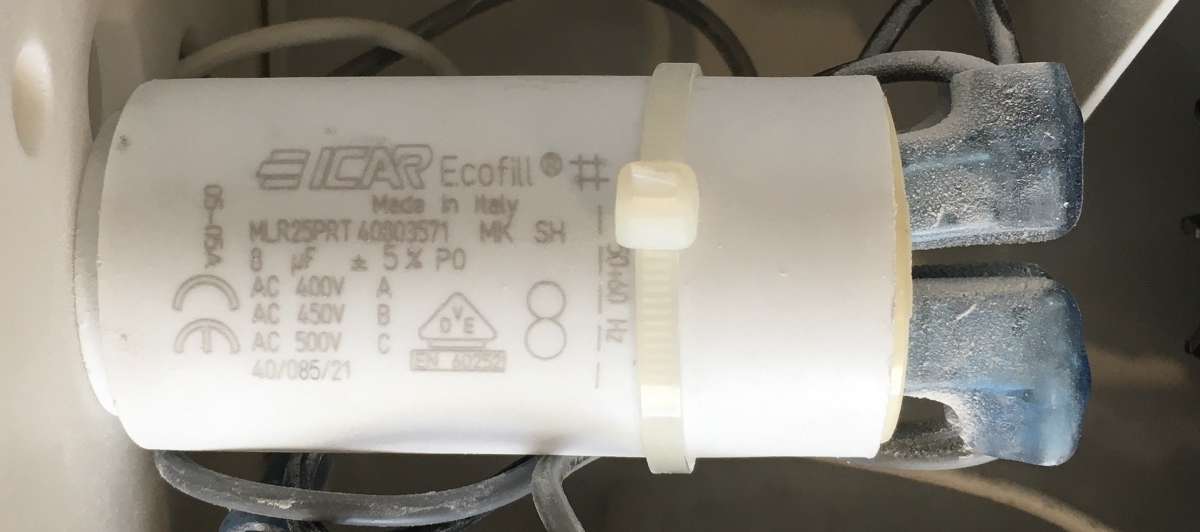

                                            #724983

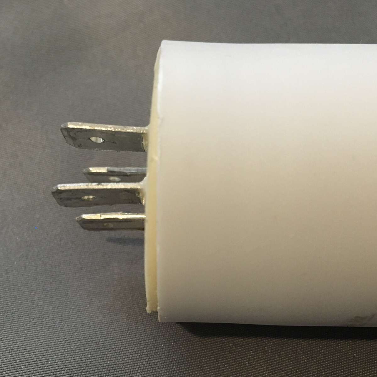

                                              With special thanks to Les and Robert for keeping me Safe and Sane, I am pleased to confirm that the Motor [given a mechanical push-start] runs well, in both directions.
                                              The capacitor, however, is obviously as dead as a Norwegian Blue Parrot.
                                              Having disconnected and removed it … I found this reasonably clear hint that something is amiss :
                                              IMG_9551
                                              Off to look for a suitable replacement now
                                              … having duly noted Roberts opinion that I should stick with 8uF
