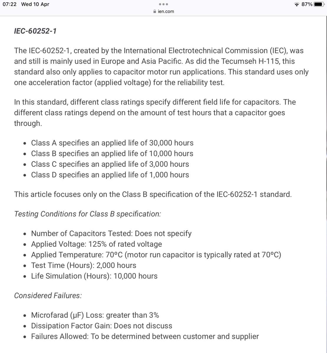

      How much does the quality of these Start & Run capacitors vary between brands ?
      The ebay item to which Les kindly pointed is near the bottom of the price range, and for double that I have found a MECO version.
      https://www.ebay.co.uk/itm/224373277605
      Although Motorcyclists have often joked about the terrible quality of Italian electrics, MECO seems to tell a good story:
      https://mecocapacitors.com/en/company/
      https://mecocapacitors.com/en/products/motor-start-and-run/cmi4-series/
      … and I’ve found this useful note elsewhere:
      IMG_9552
      Any ‘value for money ‘ exercise would  obviously need to include shipping costs, and the estimated cost of failure [!] but I am drawn towards the MECO brand.

        Duncan,
        That test only works with an incandescent lightbulb. They are hard to come by these days.
        Some multimeters will measure capacitance of a capacitor but not many will measure other critical parameters for a motor start capacitor like ESR and leakage.
        The capacitor linked is ideal

          The Meco capacitor spec gives a design life of 10,000 hours which is presumably continuously running, so a long time in terms of a shredder in a domestic situation. Stop start usage probably reduces the life expectancy though.
