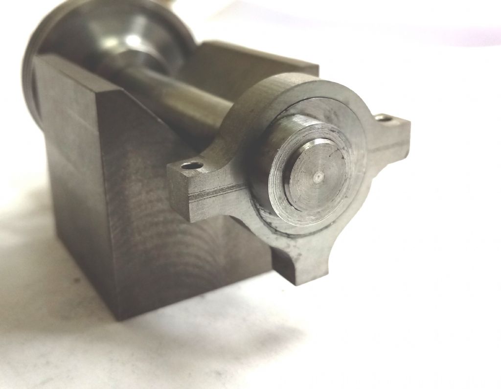

        Ron Laden
          @ronladen17547
          Eccentric strap in cast iron it's the best I can do with it.
          The wall thickness is tad heavier than the drawing and I have left all 3 lugs at 6mm, pleased with the fit to the eccentric, should run well.

            That should do the job.
            Can't remember now but did you use a larger dia crankshaft as the boss for the eccentric looks thinner than mine?

            Ron Laden
              @ronladen17547
              Hi Jason, yes I had 10mm ground bar at the time and used that, probably a bad choice and should have turned it down to 8mm.
              As for the thin walled boss, Shhh… your not supposed to notice things like that, all I can say is blush blush​​​​​​. Anyway I have just sleeved it to 14mm which looks a bit better.

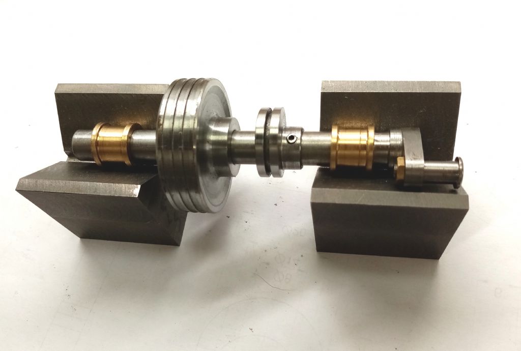

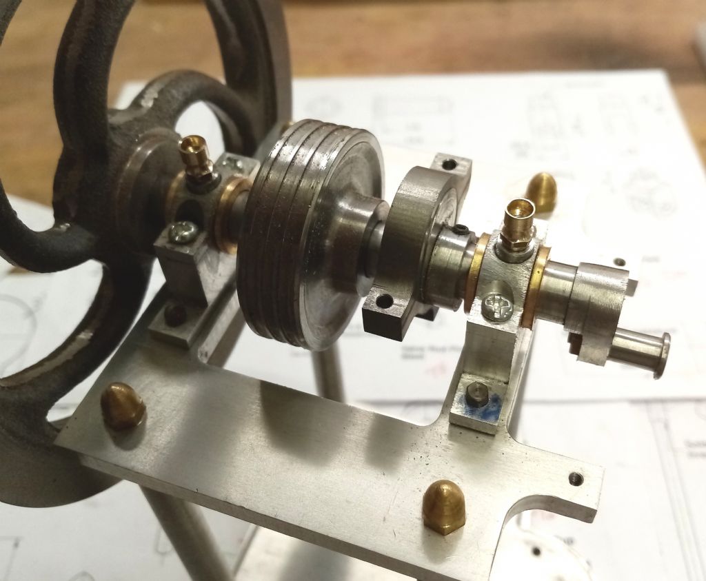

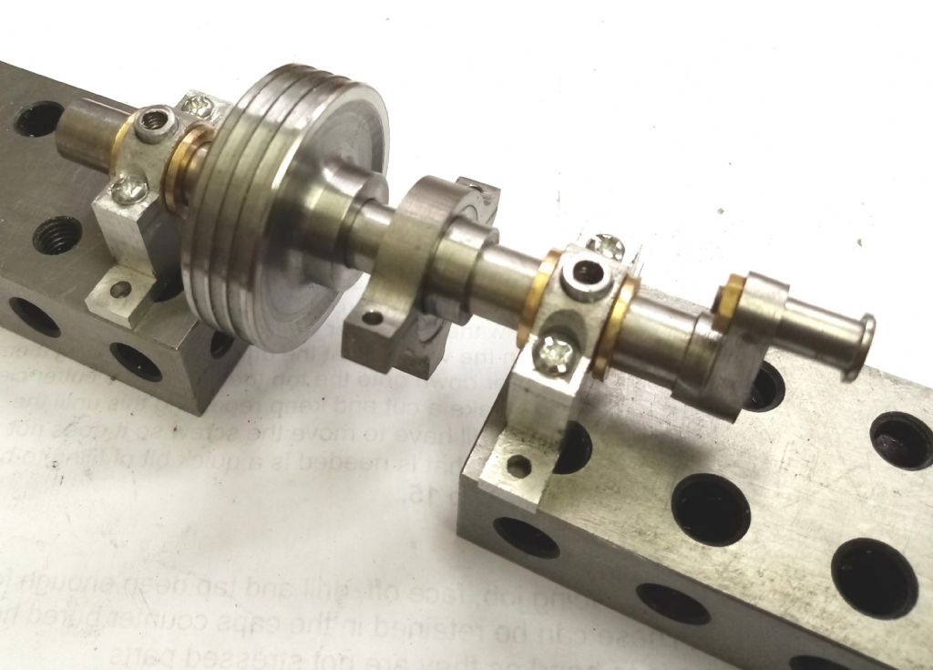

              #486651
              Ron Laden
                @ronladen17547
                Bearing pedestals done just need a debur and a clean up.

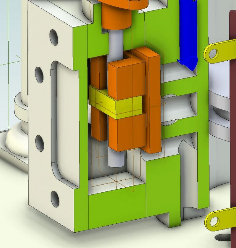

                      Jason, the valve rod is centered in the valve chest 5mm from the cylinder face. Half the width of the valve nut is 2.3mm plus the 1.0mm step in the valve slot plus the 2mm thick valve face which totals 5.3mm.? am I missing something..?

                        I am being dim this morning if I read the drawing correctly I would have seen the nut doesn't sit on the 1.0mm step but having said that I still can't see that the dims put the valve face to face with the cylinder..?

                          Ron, sounds like you have got your nut the wrong way round and are putting it into the slot for the rod, if assembled correctly there is room for the valve to lift off the surface.

                            Hi Jason, I am in the process of finishing the valve parts and I am thinking of the parts fitting together as per your assy above so I think I have that correct. I was assuming that the valve would be a close face to face sliding fit with the cylinder with next to nothing in the way of any clearance, is that not the case..?

                              Posted by Ron Laden on 22/07/2020 08:28:09:
                              Ron, this is where you are going wrong, if you look at that sectioned drawing I posted earlier you will see that the 1mm step is at the bottom of the rod slot not the nut slot.
                              This means that the nut is free to move off the face by 0.7mm ( 5 – [2 + 2.3]). This ability of the valve to lift off the surface is usual on slide valve engines as it allows any condensate that may gather in the end of the cylinder to be pushed out by the piston rather than being trapped and causing a hydraulic lock. As this engine has no drain cocks it becomes a more desirable feature.
                              In operation the steam or air entering the valve chest will push the face of the valve against the port face this is why it is important to ensure the valve moves freely on the nut/rod so that it can take up it's own position though not so free that there is slack at the end of it's stroke.

                              Ron Laden
                                @ronladen17547
                                Thanks Jason, I did realise eventually blush that the 1mm step was at the bottom of the rod slot but I couldnt understand the 0.7mm movement but with your above explanation now I do, I had no idea it worked like that.

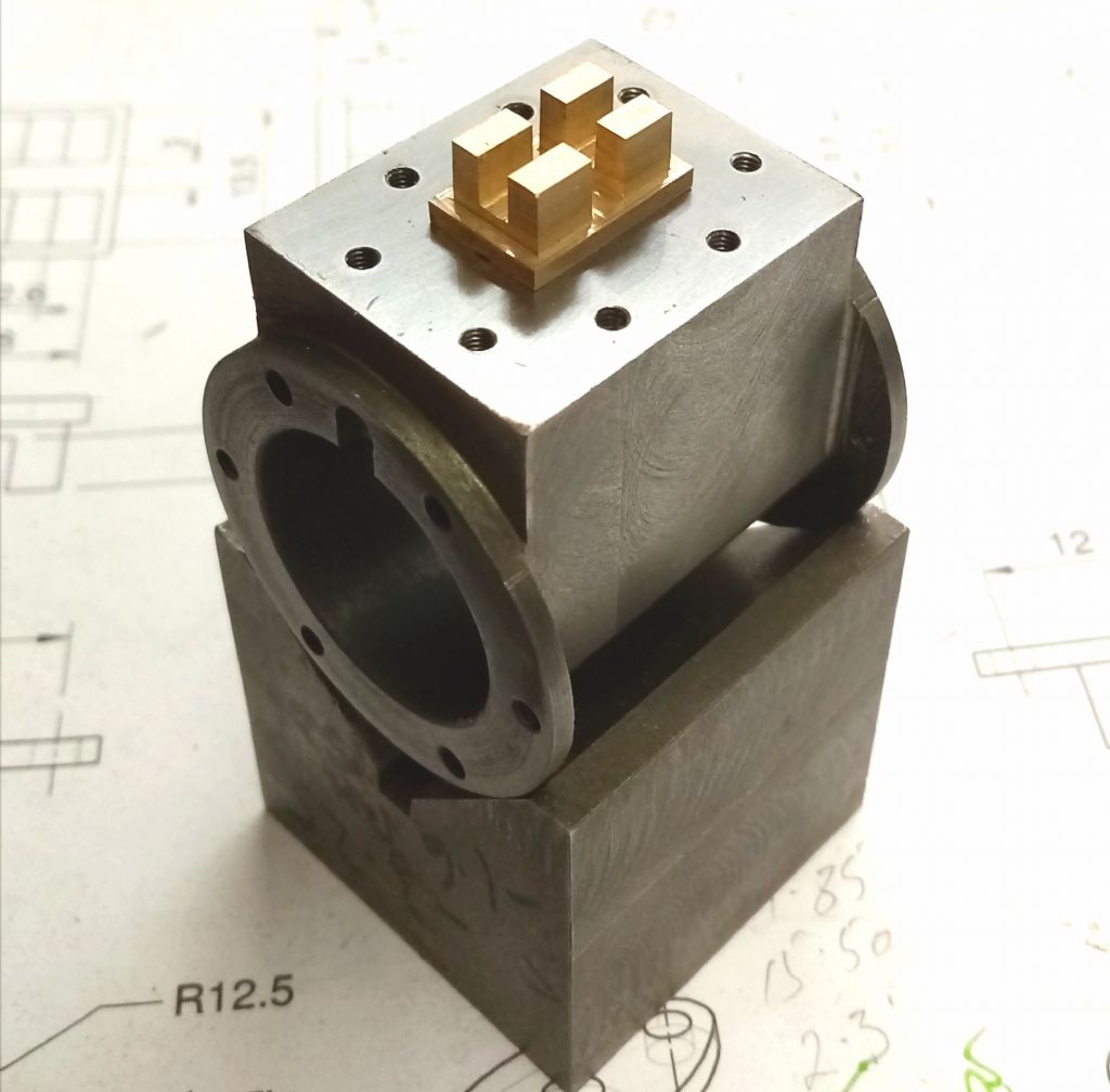

                                Ron Laden
                                  @ronladen17547
                                  The Class 22 is awaiting a track test (next track day in two weeks) so thought I had better catch up and make the last few small parts for the Muncaster.
                                  I made the valve this morning which seems to have turned out ok, Jasons drawing calls for bronze but not having any stock at the moment I went with free cutting brass in the hope it will be ok.
                                  The rod slot is 2.6 mm wide x 4.0 mm deep and the nearest cutter I have is a 2.0 mm HSS 2 flute uncoated, the top end speed of the mill is 2500 rpm and I was a bit concerned how it would cope running at less than half speed. However it was fine and turned out ok, I started with a couple of 0.25mm cuts then increased to 0.5 mm and it cut just fine as did the two side cuts of 0.3 mm to achieve the 2.6 mm.
