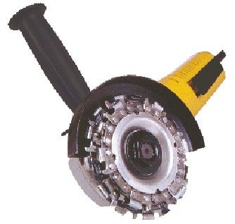

                    I don't know about you ,
                    but I don't have the nerve to use a blade like this :-
                    I don't want to be nominated for the Darwin awards

                      A tool for making chases in walls?

                        very easy to use and very messy.
                        use one when making log hides for reptiles, def need full face mask though.
                        throws out nice bedding to go in with rabbits.
