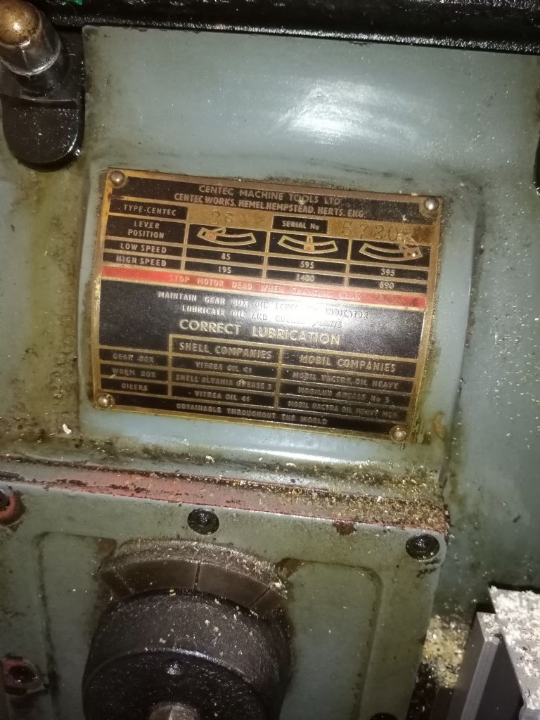

                                I have found the letters CTE B GM stamped in the dove tail on top and B32 20 on the front. I'm told that it's serial number is 5398 but I can't find that on the machine – where might it be ? The lates .co manual the drawing may well be an autimil as it shows a INT 30arbour. Noel
                                #599424
                                Dave Halford
                                  @davehalford22513
                                  the very last 2B's came with the int30.
                                  The serial number is on the brass speeds plate, Duncan's is 5720
                                  Edited By Dave Halford on 26/05/2022 20:10:45

                                    My Centec 2B has INT30 spindles, and they're far better than the Morse taper ones usually encountered. A gentle tap on the end of the drawbar frees it easily. I don't know when it was made.
                                    I retained the motor location in the cabinet, dug out the star point, rewired it to delta, and run it from a VFD. I can't emphasise how much of an improvement this is to a fixed speed single phase motor. It now has instant reverse too, so tapping under power is no problem.
                                    Here's a photo of the serial plate.
