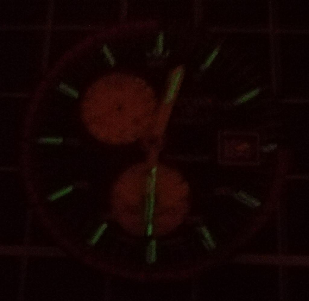

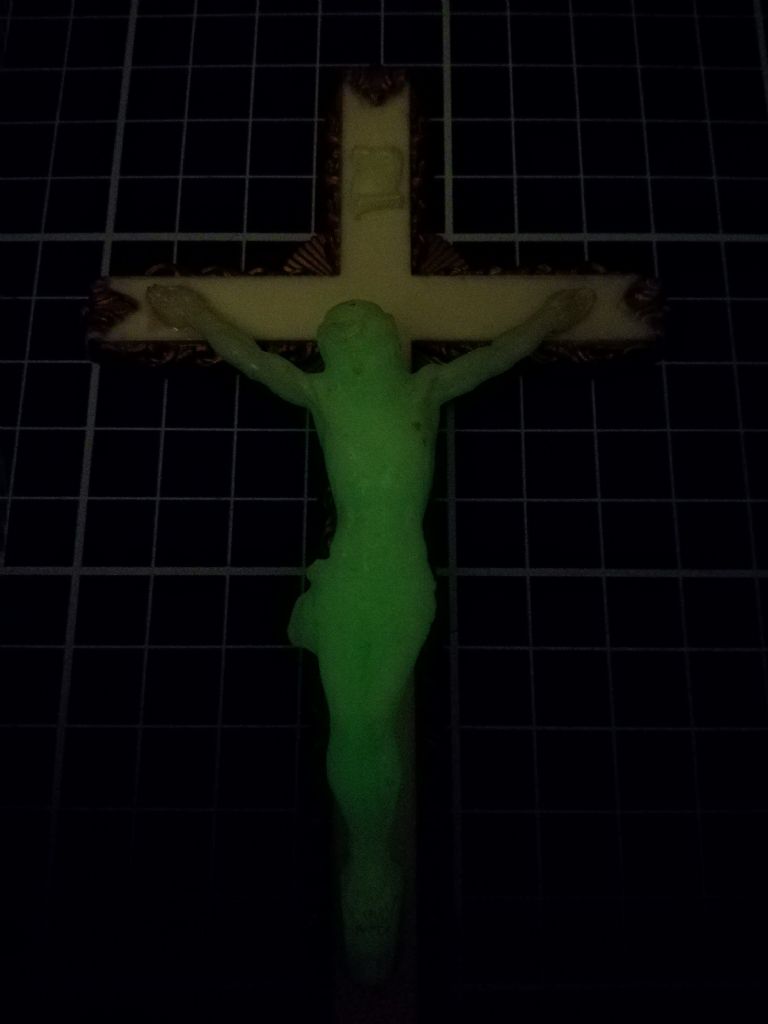

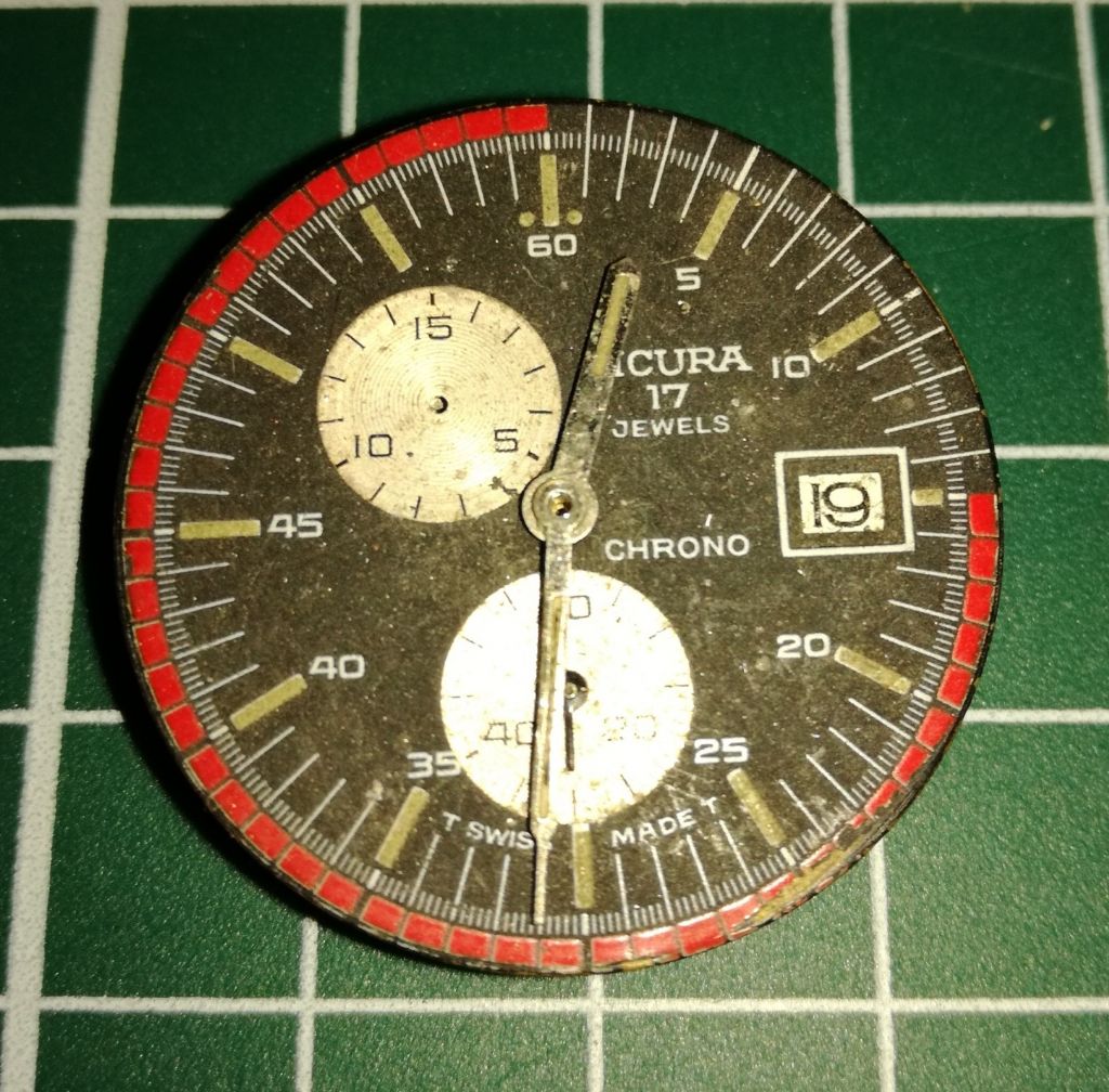

                                                  Hi, like a lot of people, I've had a few watches with luminous hands and the main five minute positions. The photo below shows the remains of one that I had many many years ago. The luminous parts will still glow for a couple of moments when exposed to the light on my phone camera for about a minute, but it took a few shoots to capture an image, as the luminous glow disappeared as quick as a flash, and the bottom photo shows them at about half the brightness from when I switched the camera light off.
                                                  My younger brother and I were given a Crucifix with a luminous figure, by one of our parents friends when I was about eight, and these would glow quite brightly, longer than it took for us to fall asleep, it still will glow for a while after shining an LED array battery hand held light on for about a minute, although it has been stored in different boxes/draws for most of my life.
                                                  Regards Nick.

                                                      Nicholas
                                                      Your watch dial doesn't use radium but uses the "milder" Tritium based luminescence indicated by the "T" either side of the Swiss Made legend.
                                                      CS
