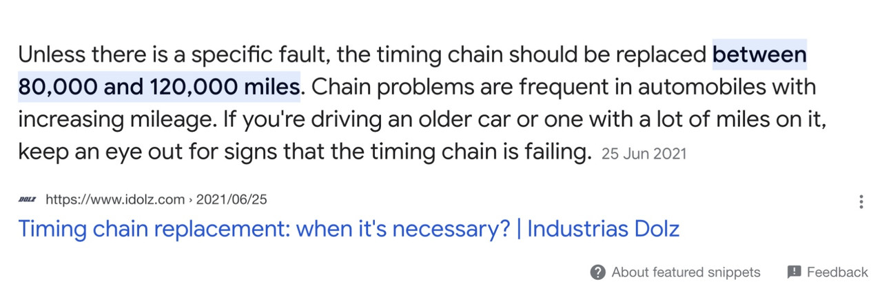

                                                  I seem to remember that for some models Ford said the Cam Belt doesn’t need changing and should last the life of the engine. The quoted life in one instance being 88,000 miles I believe.
                                                  When I worked as a Ford mechanic many years ago I carried out a service on a Ford Cortina MK5 with just over 100,000 miles on the clock. It was only a year old! And no, I didn’t change the cam belt.
                                                  A quick Google says chains don’t last any longer?

                                                    Google and idotz.com??? I'd not trust that. Chains do normally last longer than belts and all I've seen were "on condition" so changed when they start to rattle etc.
                                                    Engine toothed timing belts without tensioners do exist. Ford and Volvo at least use stretch belts on some engines. SWMBO's 2l automatic Focus has one. Needs a special tool to put it on. The toothed "timing" drive belts used in a lot of industrial equipment are often used without any tensioner other than inital adjustment of a pulley position. But they don't tend to have the same loads and speed range as engine timing belts.
                                                    Robert.
