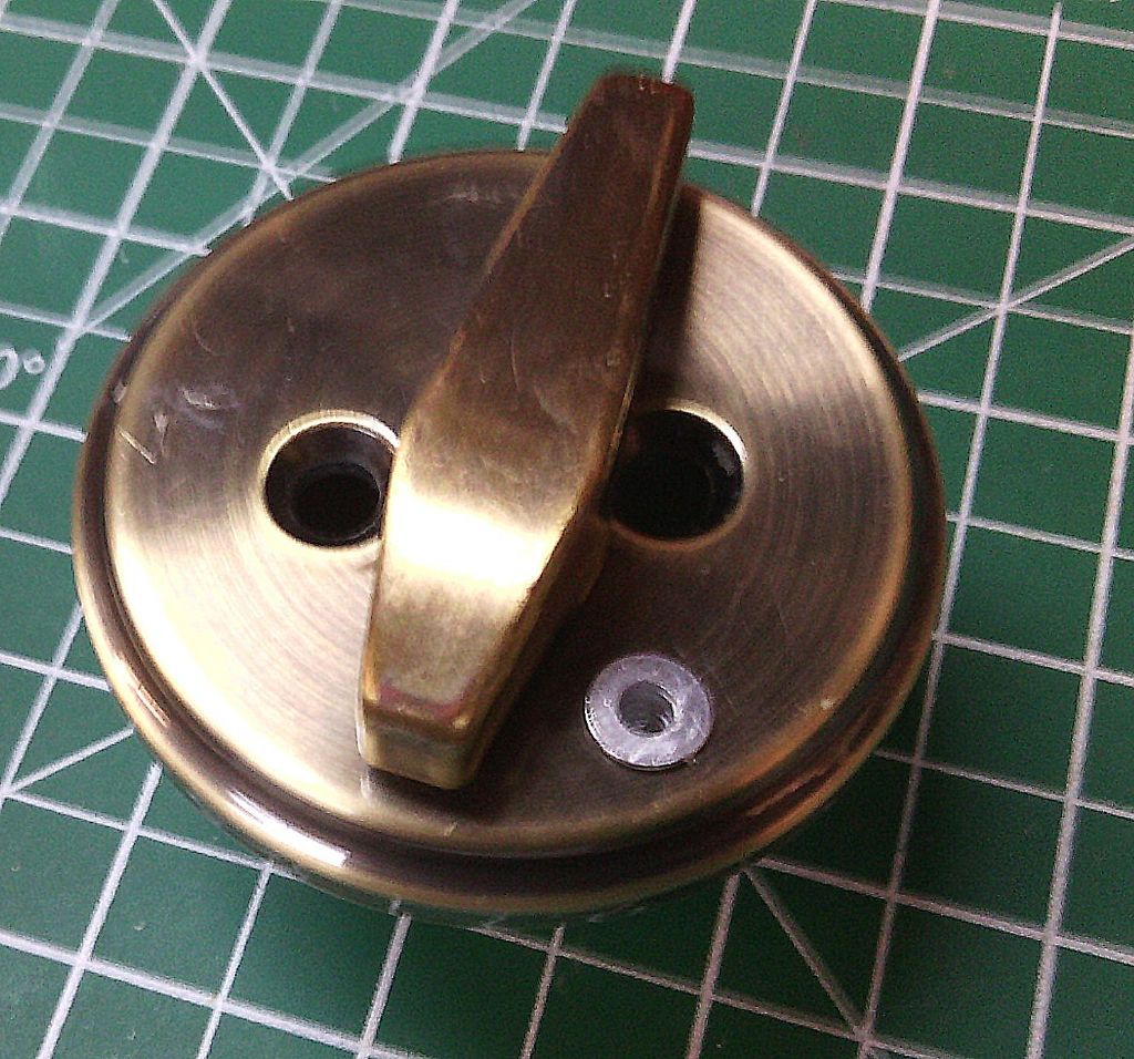

        I'm pretty sure there are others here who have a loved-one with Alzheimer's who also "wanders" and are therefore faced with the problem of making their home "escape-proof".
        I've been through the door chains, childproof doorknob covers, chimes that go off when the door opens (though not for metal doors). None have been completely satisfactory (ask my local police constabulary).
        I hit upon a simple idea shown in the picture which may be of use to others with the "standard" Yale lock. The silvery part is a Rivnut. When I want to prevent egress I install a SHCS (Allen screw) in it. (At first I used a plain screw and kept a key handy but I've since changed to a screw with a press on thumbscrew head which is much easier).
        In principle, the Rivnut can be installed from one side without removing the lock-plate. In practice, Yale seems to have used a number of designs for the plate both pressed and cast so it's safer to remove it a position the Rivnut in a clear area.

          Why not just fit a rack bolt?

            Yours looks like a reasonably good solution, Peter.

              I couldn't get a locksmith to fit me a mortise lock on the inside here. (It's possible that it's illegal).
