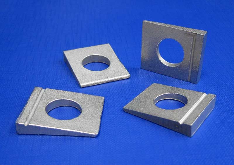

                                            Hopper
                                              @hopper
                                              Does it have to be ally? You can get steel tapered washers made for putting under nuts when bolting through the tapered sections of large steel I beams or channel. They are a square shape with hole in the middle and tapered in cross section to match the I beam shape. Or could you use sections cut out of a large I beam or channel, on the tapered flange sections? (Groping in the dark here without knowing the application!).
                                              Edited By Hopper on 08/03/2018 01:51:59

                                              Brian Wood
                                                @brianwood45127
                                                Hello Brian Sweeting,David Standing and Hopper,
                                                Thank you for the new ideas and contacts to test out, but I ruled plastics out as the pressure application onto the tapered face will be line contact and local deformation of the plastic is a real possibility; even shattering can't be ruled out. Metal is the favoured material.
                                                Hopper's suggestion is however a real gem, I was not aware of these special washers and in the right size they may well be just what I am looking for with appropriate adjustments to my ideas to accommodate them in this application.
                                                To answer you question though, aluminium is not essential, it was considered simply because I thought that an extruded taper shape offered the best compromise over rolled steel where that shape just isn't an option.
                                                So thank you indeed for your suggestion, you may have also saved me the trouble of cutting to length as well as an added bonus! Do they have a name so that I can look at the sizes that are available?

                                                #344952
                                                Hopper
                                                  @hopper
                                                  Brian, if you Google Tapered Washers, all will be revealed. I think they should be available from good industrial fastener suppliers as they are a commonly used item.
                                                  They come in all sorts of sizes. I've used the ones about the size you might need many a time when working power-station and mining construction (back when Noah was still a midshipman) where steelwork is being bolted together with large (1/2" BSW and upwards) bolts so I'm sure if you scout around you will find something to suit.
                                                  As an aside, they are darn handy too as wedges for setting up machinery level when installing. And could probably be adapted to removing drill chucks off arbors etc.

                                                  #344953
                                                  ianj
                                                    @ians
                                                    A search for beveled/taper/wedge washers brings up loads of results.
                                                    Hopper beat me to it,must type quicker!

                                                    Brian Wood
                                                      @brianwood45127
                                                      Hello Ian J,
                                                      Thank you, had I known of these I would have gone straight to them. I have a sample set of 10 on order
                                                      I think my search is now complete, these I am sure will do the business
