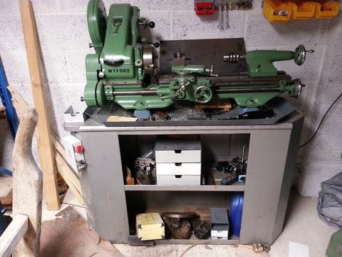

      I have recently bought a tired Super 7 that I intend to restore.
      An immediate requirement is to put it on a stand. But even 2nd hand Myford stands or cabinets seem expensive relative to the initial cost of my machine!
      I know I could bench mount it with a tray. But I wonder if anyone has tried using an alternative stand/cabinet such as a Warco item….
      http://tinyurl.com/cz8cv2c
      This looks pretty cost effective when I see cabinet prices on fleaBay. I know this may not be the precise answer but I am pretty sure there must be other perfectly good 'Chinese' cabinets out there…
      Any ideas?

          #118300
          NJH
            @njh
            Well my S7 came with a stand but, when I look at the price , it is a bit eye watering! If you do go along the Myford route I would recommend their splashback which is a very robust and well finished affair. Not cheap, I conceed, but it does rather finish the thing off, provides somewhere to put "stuff" so it's close at hand and avoids swarf getting down the back of the machine and coolant being sprayed over the walls!
            Here is a pic.

                                      #118368
                                      Sub Mandrel
                                        @submandrel
                                        Hmm. Mine is made out of 3×2 – timber that is! but then I only have a feeble mini-lathe

                                        Hillclimber
                                          @hillclimber
                                          Many thanks to everyone for their input, which I really appreciate.
                                          A solution has emerged in the midst of this. A forum member has offered me an industrial cabinet (holy grail etc) at a reasonable price….
                                          cheers, Colin
