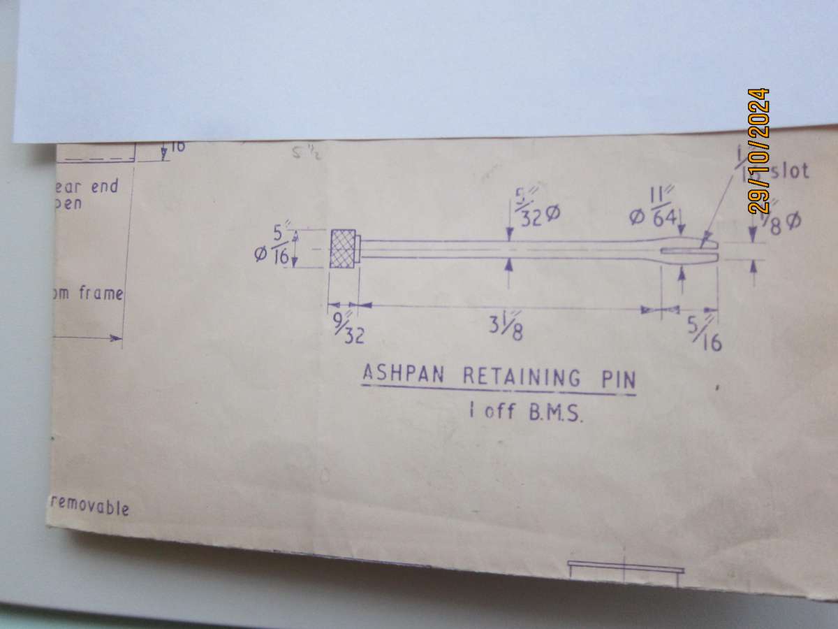

      The attached photo shows an image of the ashpan locating pin drawn up by Martin Evans for his 3.5ins gauge Rob Roy locomotive which I would like to take as the basis for another design. Before setting out on making something up I would be interested to know if there are any other possible designs out there which might be considered first. The tricky bit of course is the end section which prevents the pin from dropping out during a run with potentially damaging results to the engine. Any thoughts on alternative methods of securing the pin would be gratefully received.

        what about the flick over clevis, that you have to hold straight to be able to take the pin out?

          I made one of mine with a bayonet fitting at the handle end, similar to a BC light bulb

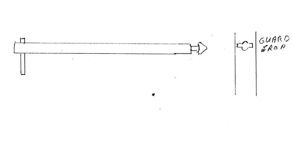

            The pin on my loco goes through the rear guard irons to retain the ash pan. It is shaped like this. It  is 3/16″ dia. CRS and the dart on the right end is filed flat to go through the slot in the right guard iron,  the handle is just a short length of 1/16″ dia. CRS silver soldered into the end.  In use it is slid through the left guard iron then through the two sides of the ash pan and with the handle on the left horizontal the dart on the right end is put through the slot in the right guard iron and is then given a 90 degree turn so the handle hangs down retaining the pin in. I have never in 30 odd years of running the loco had it move.

                Simple and effective!
                My Society used similar on a 5″ g. Maid of Kent it owned.*
                The pin went through holes in the frames rather than guard-irons, and rather than a handle indicating the dart orientation, the face of the knob was painted white with a small red arrow.
                It worked well, but I would add what makes such an arrangement effective is a tube right across the ash-pan to guide the pin across the chassis.

                  If the pin goes through the frames where there is lots of room then the dart end could be simplified by turning a cone on the end of the pin and putting a cross pin through just behind the cone. The hole in the frame would be the same as in my guard iron except that the central hole would be the dia. of the rod. I couldn’t do that with my loco (5″ga NER 0-4-0 “Gemma”) as the guard iron is only 5/16″ wide.
                  As Nigel suggests a tube across the ash pan would make installing the pin easier. Mine doesn’t have it, and it is a bit of a fiddle finding the hole on the far side of the ash pan, although not too bad.

                    Note that a guide-tube will not allow a pin or other fitting through it.
                    So, place the locking arrangement on the handle end of the support pin.
                    The simplest way is to put a keyhole slot in the frame, with the stem part pointing vertically towards the frame top, and one-sided cross-pin in the support-pin. A dart type lock would also work here, with the dart section formed on an extension to the inner end of the operating-knob.
                    The main point is that the knob and lock are on the same end of the pin, allowing that free passage through a cross-tube and the far frame. A short taper on the far end of the pin will assist insertion.

                    The main problem with the type of pin retained by a small cross-arm pivoted in its slotted end, is that it would need operating from both sides of the locomotive. These also tend to be of fairly large diameter to be robust, needing a larger guide-tube and holes through the frames and ash-pan, than otherwise necessary.
                    A 1/4″ dia pin should be fine for a 5″ g. loco; 5/16″ or 3/8″ for 7¼” g.
                    Make the holes and guide-tube of generous clearance, as the ash-pan could distort slightly with use. Especially if anyone quenches it with water after dropping it – not good practice anyway, to be used only where the fire has to be dropped somewhere dangerous, but I have seen this happen many times in ordinary disposal. Quench the embers, not the metalwork.
                    Basically, the simpler the better!

                      Nigel the clevis arrangement I mentioned only folds in one direction so if its folded and hanging down twist 1/2 turn and it should align and pull out.
