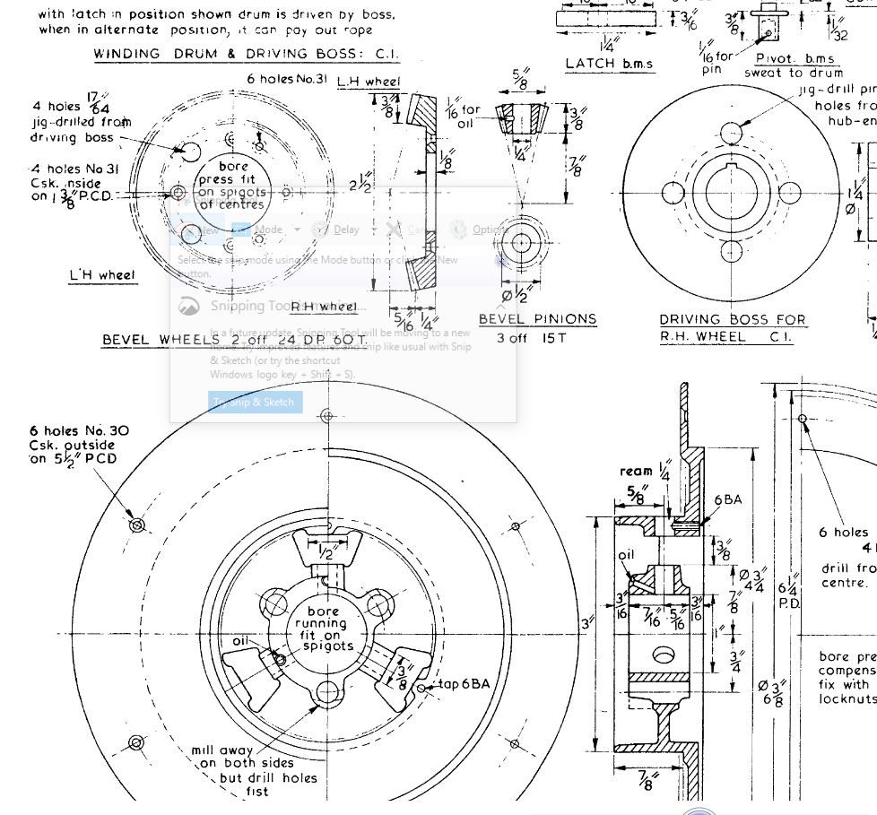

                                #586109
                                Anonymous
                                  Posted by Dougie Swan on 18/02/2022 15:42:23:
                                  Sorry for no pics but it's a pain having to load them to the album first then onto the thread
                                  Conversely it's a pain having to second guess about parts with which we're not familiar. smile
                                  Glad it's been fixed, but I suspect the shmming has hidden the original problem rather than solved it. Is the backlash consistent or does it vary as the bevel gear is rotated?
                                  Andrew

                                    The Fowler has a shim washer that sets the spacing between the two halves of the diff which is machined until you have minimal backlash but not too tight to bind, as it uses cast finish gears a little adjustment is needed on each engine.
                                    For Andrew (and others) enlightenment extract from Allchin drawings
