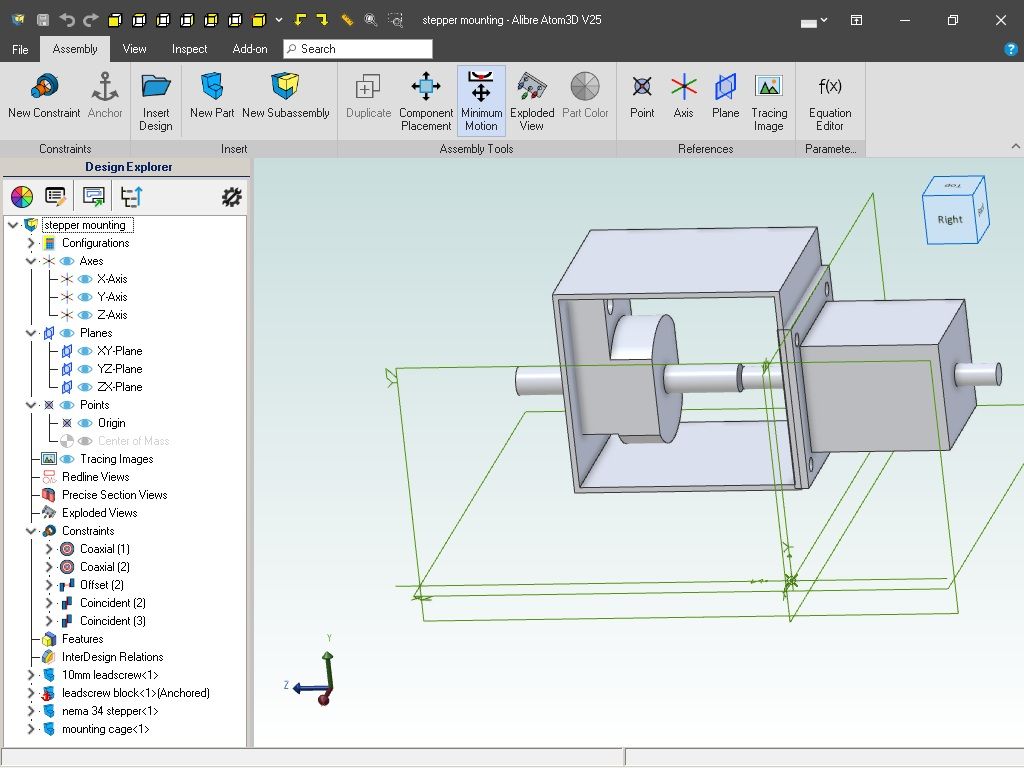

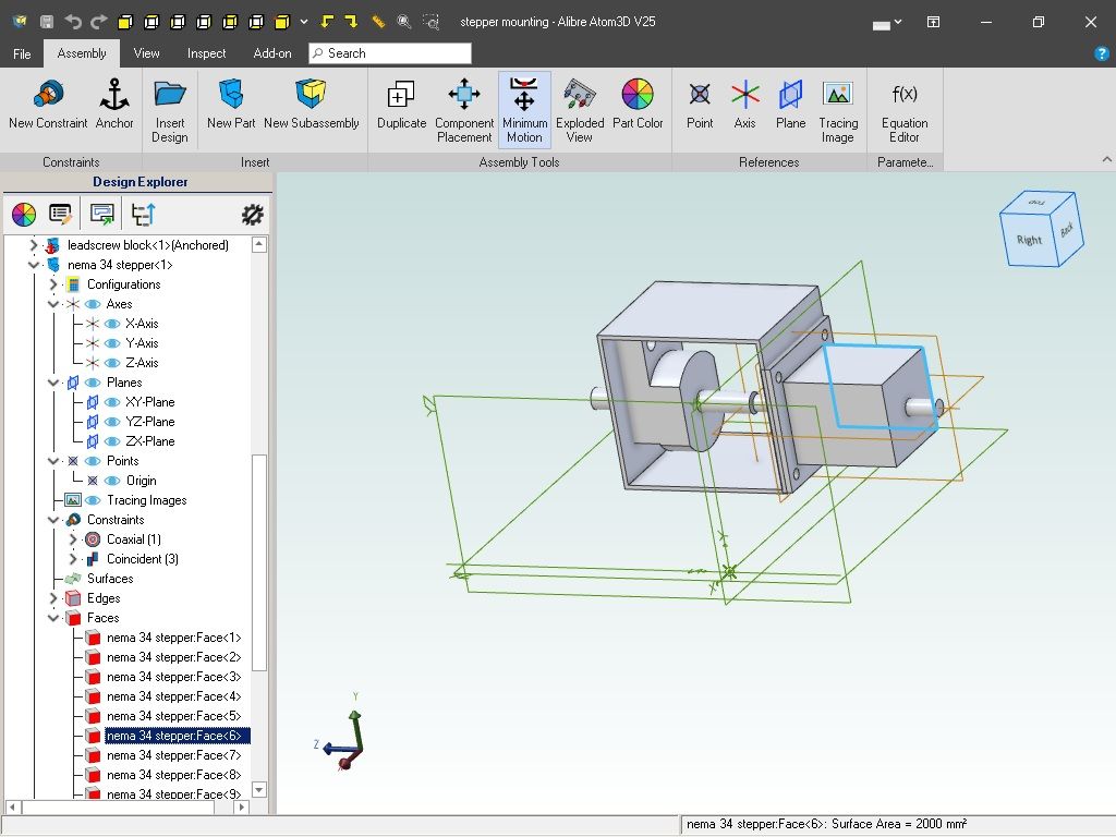

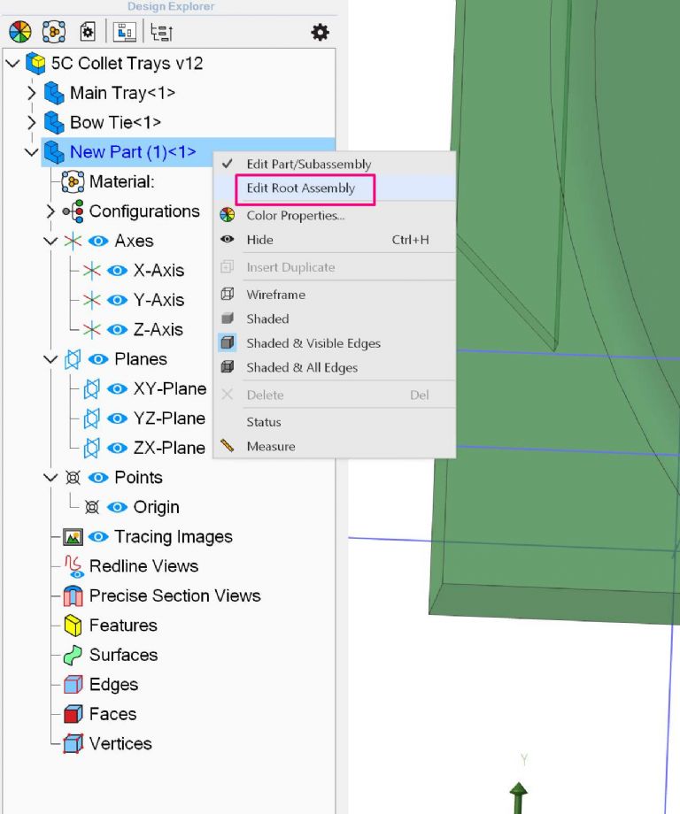

      After a long holiday in the Slough of Despond (not of Berkshire) I've tentatively picked up Alibre Atom again.
      On several occasions I accidentally picked "New Part" instead of "New Design" in Assembling something. Disastrous! That loses the Assembly drawing!
      The little back-stepping arrow on the tool-bar is inactive in that situation; so is there any way to recover the assembly-drawing immediately prior to the mistake? Or is it lost, at least back to the last Saving?
      Also, can a part be constrained only once? I'd concocted a simple shaft with several parts along it*, but having placed imported components concentrically on the shaft, I could not see how to put them in face-to-face contact. You cannot select a surface facing away from you. Anyway, even trying it only raised "Over-constrained" warnings.
      (Nor come to that, how to place a Part at a set distance along another.)
      [*Part of a back-gear type speed reduction for driving a horizontal milling-machine. I was not so daft as to try to represent the gear-teeth, but drew the two wheels by their pitch cylinders.]

          I go to File/save and it drops you back into the main screen
          Then cancel the save dialogue box
          It's an awkward fiddly bit for a newbie that needs sorted

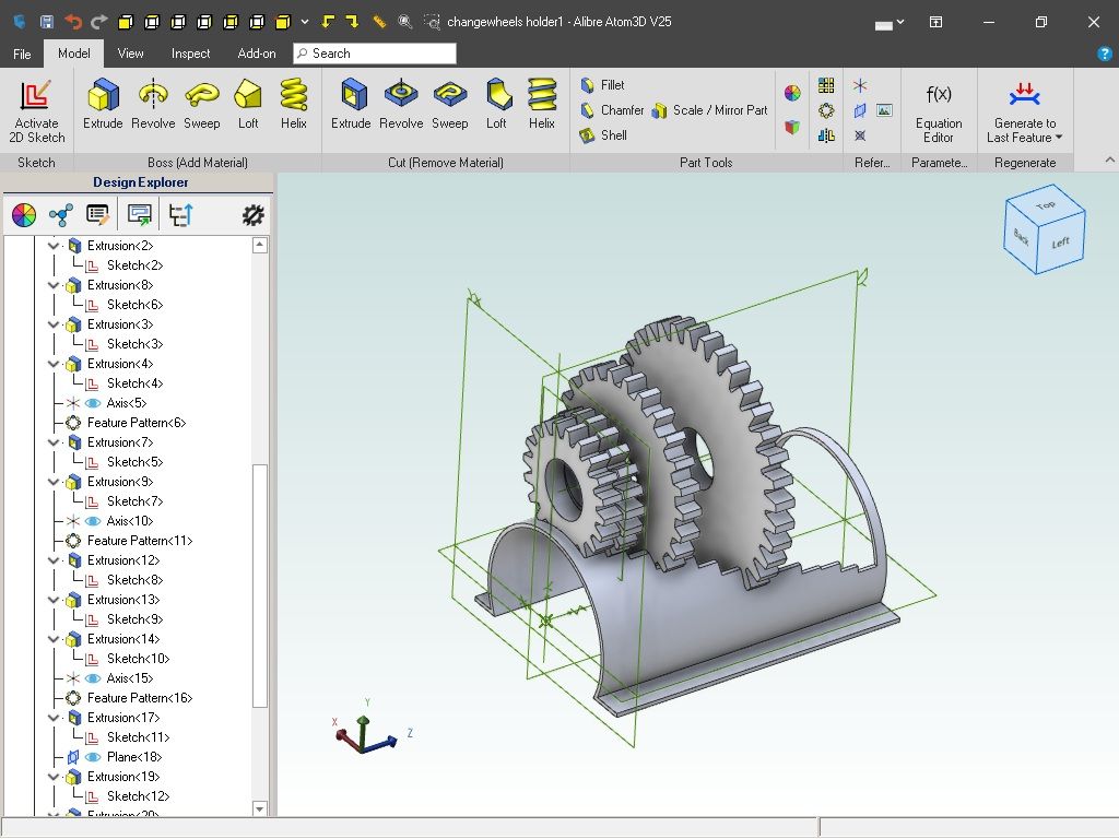

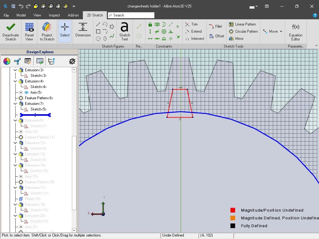

            You can generate reasonable teeth with a single simple pyramid extruded into a wheel
            Then do a feature pattern around the wheel
            Proper teeth use a lot of memory

                " is there any way to recover the assembly-drawing immediately prior to the mistake? Or is it lost, at least back to the last Saving? "
                When I started in CAD (many moons ago) I got into the habit of saving what I was doing every 10-15 minutes. Only takes a couple of seconds to click on the save icon. Then you have only lost minutes work and not hours.
                If you have made a mistake in a part, do not save it as you exit and do not save any assemblies that contain the part, otherwise all parts in the assembly will be saved and updated with the mistake.

                  New part/design
                  If you click the wrong insert part rather than insert design it is just a case of then clicking the "save" icon top left and when the box comes up to save the new part click the "cancel" box and that will then take you back to the assembly you were working on.

                    Drawing gears just as circles and cylinders is an old manual-draughting convention, but I don't think it would hurt at least at my level in CAD; and in any method the pitch radii are what dictate the shaft centres. I know it would be necessary at a more advanced level needing a more realistic image, or of course designing the gears themselves. I realise the trap in this simplification is not leaving enough space around the wheel for the tooth addendum.
                    I have though discovered the radial copying tool, and used it in this particular exercise for a ring of screws or pins.

                          Another way to recover from an accidental New Part, is to right click on the New Part in the Design Explorer, then click 'Edit root assembly' – this returns you to the assembly level.
                          You can now click on New Part (in Design Explorer or the 3D workspace) and press Delete on keyboard.

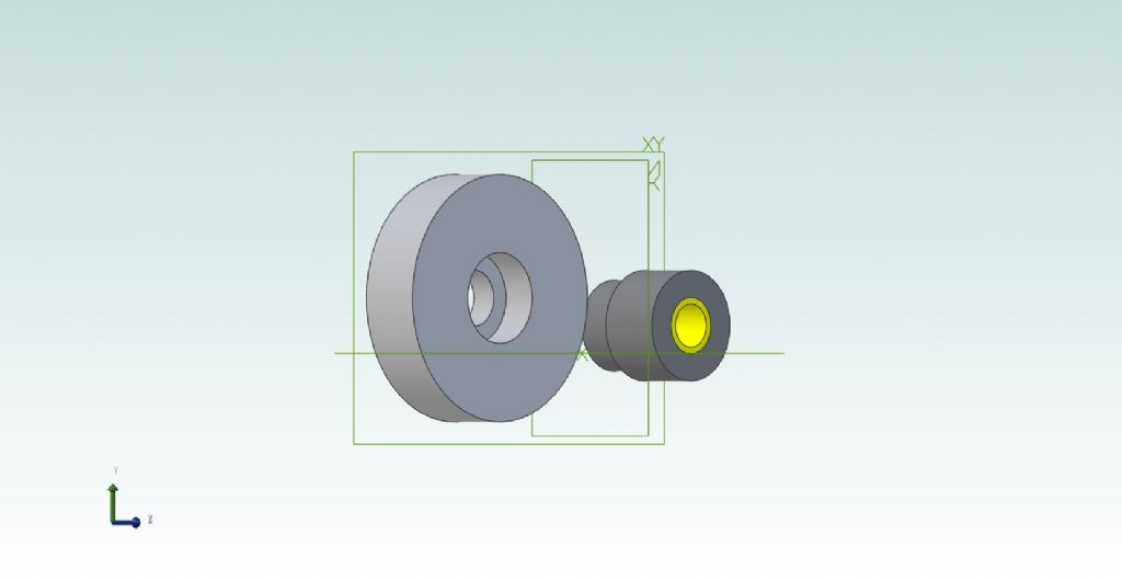

                                        What more are you wanting to do?
                                        You said it is a spigot and something that fits on it. You said you have done the concentric constraint (hole on spigot)
                                        You now say you can have the part with the hole in it the right way round.
                                        All that is left is position along the spigot which I described yesterday and is done by using "offset" if you don't want your chosen two faces inline with each other.
                                        Post a photo or screen shot of where you are at and tell us what you want to do. Or post images of the two parts and tell us how you want them to go together even a fag packet sketch will do.

                                          This is it. They are meant to represent two stock gears, by their pitch cylinders.
                                          The spigot on the smaller one is as manufactured, intended to fit in a recess bored in the larger wheel, though not to full depth to give a small clearance between them..
                                          That was the one the wrong way round, but I managed eventually to twiddle it round – once you told me how!
