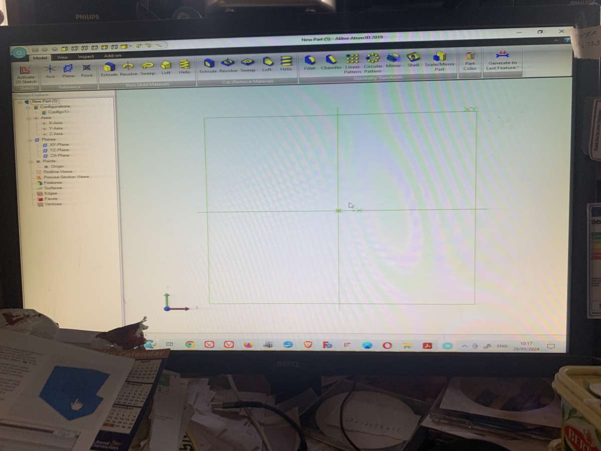

                                                #710457
                                                Graham Titman
                                                  @grahamtitman81812
                                                  I have decided to try to teach myself alibre again and fell at the first hurdle i cannot find the circle command .Iknow it is the 2019 version but surly it will not lose parts of the program by not being used.IMG_2783
                                                  #710458
                                                  John Hinkley
                                                    @johnhinkley26699
                                                    Graham,
                                                    Your screenshot shows that you aren’t in sketch mode. Select a plane and go to “activate sketch”.  The circle command icon will appear on the toolbar, along with all the other drawing tools.
                                                    #710460
                                                    Graham Titman
                                                      @grahamtitman81812
                                                      Thanks John but clicking on activate sketch does nothing it flashes but nothing changes.
