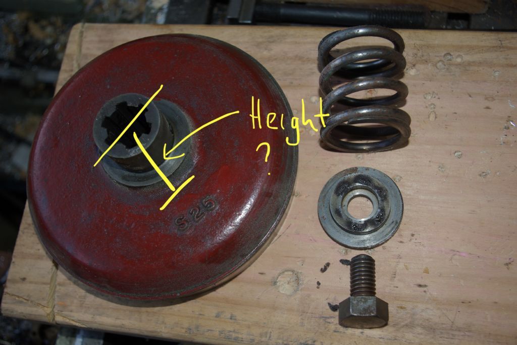

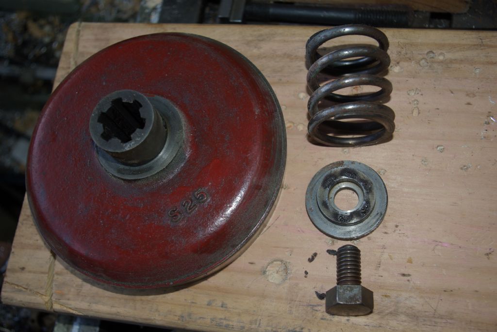

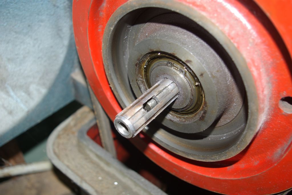

      I would really like some advice on an old Alba 1A shaper that I've just started to strip and clean.
      I would just like to know if you all think it's worth my while carrying on with the job. it looks like it's had a rough ride at some point, with broken components (externally). Inside, the gears all seem spot on.
      I feel like I owe it a new lease of life as it's been sat in our allotment shed for well over ten years now.
      The clutch looks very non standard as does the operating lever and its operating eccentric thing. Honestly, any help or advice would be very much appreciated.img_6287.jpg
      Cheers

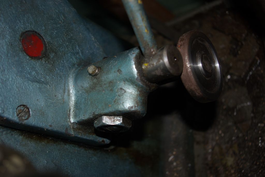

          Geoff Brearley
            @geoffbrearley24273
            Hi John,
            that would be very helpful thank you. Any measurement or photographs would be great too.
            the part that is most confusing to me is the helical part in my last photo as it looks like it’s been filed to suit the random clutch that’s fitted.
            thanks
            geoff.

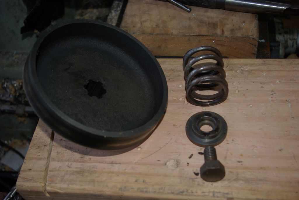

                    #484008
                    John Olsen
                      @johnolsen79199

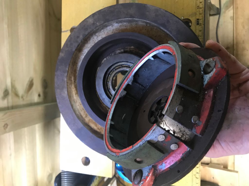

                      Hi Geoff, Well, your clutch is definitely a stranger. As you will see from the photos, it is supposed to be a cone clutch. Presumably it was giving trouble and someone has gone to a lot of bother to fit something different. I don't know why, since the original works quite well, and it would be easier to fix that if it wore I should think.
                      The way it works is that the pushrod from the other side pushes on a pin that goes through the spline part of the clutch inner and works in a slot through the splines on the shaft. So the big spring on the end is pushing the inner part into the cone on the big pulley when the clutch is driving. All very simple. I know cone clutches fell out of favour very quickly on early cars, but for the loads and speeds here it seems very adequate. After all, mine must be well over fifty years old now and works fine.
                      I hope the pictures are reasonably self explanatory. As for the way forward getting parts is likely to be a problem unless you are prepared to make them. If you would just like to get it going for a trial, you could just try locking up the clutch somehow, and just switch the power off when you need to. That is more starting loads on the motor, but would be OK for moderate use.
                      regards

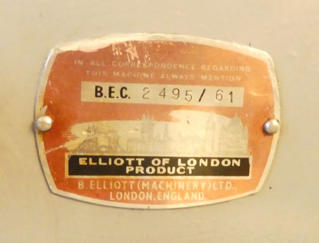

                            Hello George – My Alba 1A has this plate on the side. I know it reads "Elliot" but they bought Alba out IIRC around 1959/60. I read online somewhere that to date the machine reverse the third and fourth numbers on the plate which would make mine 1959.
                            Geoff – when I repainted mine I did very little scraping as the very thick paint covering was marred only by some really deep cracks so before rubbing down I filled the cracks with body filler and then painted.

                              Hi John,
                              Thank you so much for going to the trouble of sending me those pictures. It's really appreciated and now makes perfect sense.
                              I might be able to make a new cone using the splined hub off my 'bitza' clutch setup. Just need to find a suitable bit of material, not something I'd have laying around at that size. Do you happen to know the height of the cone when its sat on your bench and the larger and smaller diameters of the cone? If she's back together now, don't worry about it. I have a feeling mine will always be a bit of a mongrel anyway.

                                  There are old new Alba shapers and newer new Alba shapers. The later versions all have the motor in the base. Older versions (some were fitted to a precarious looking pillar) may have the motor fitted to the rear of the machine or may have no motor at all but were driven by a lineshaft or wall mounted countershaft. There are detail differences between some of the older ones. Power crossfeed was fitted to all machines, vertical feed was an option.
                                  daveb

                                      OK, some points arising from various posts…
                                      Looks to me like Geoffs machine is the later model, as is mine.
                                      The dating trick does not seem to work on mine, since the number ends with 16/99 I suppose that might mean machine number 99 from 61, eg 1961, but I dunno.

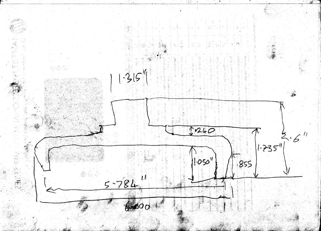

                                      I've made a pretty horrible sketch of the clutch inner which I hope will help Geoff. The vertical dimensions were taken with a Vernier height scale, I would trust them to within about 5 thou or so. The others are with digital calipers so are probably a little better. The smudged one is 6 inches.
                                      regards
                                      #484198
                                      Geoff Brearley
                                        @geoffbrearley24273
                                        Hi John,
                                        Again, thank you so much for doing that and all your help.
                                        That’s my kind of drawing, nothing horrible about it 👍🏻

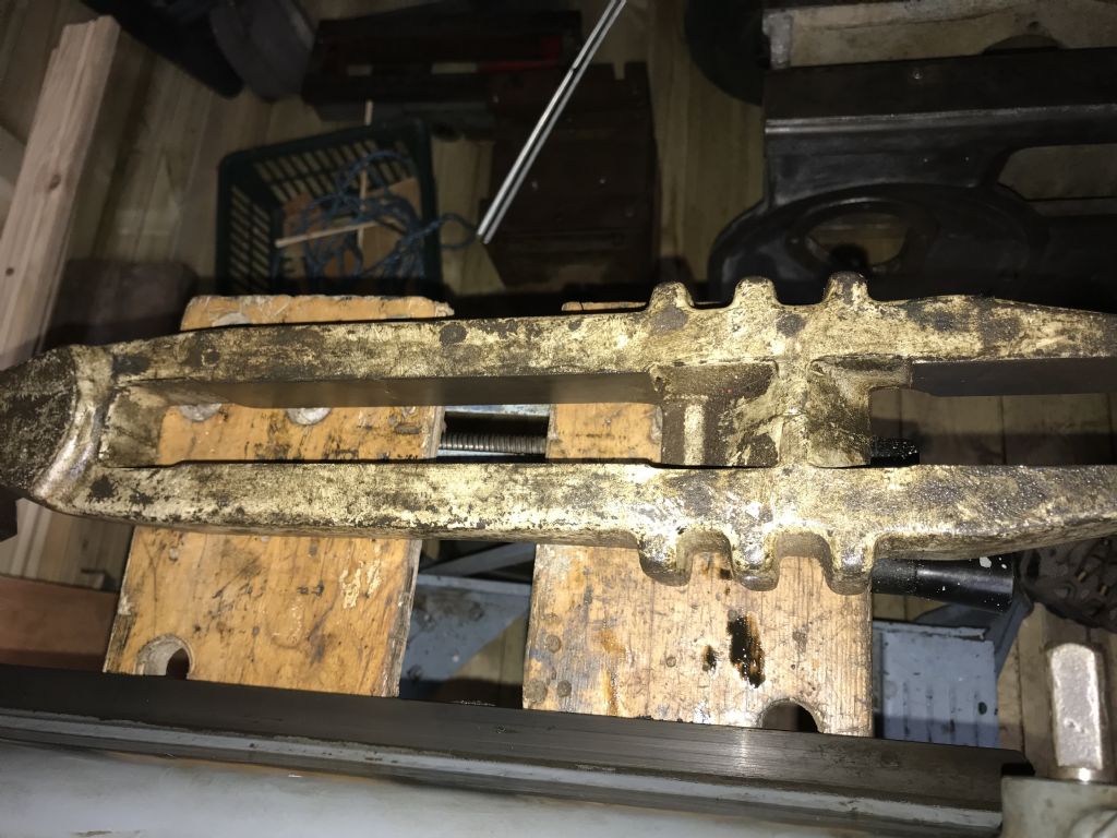

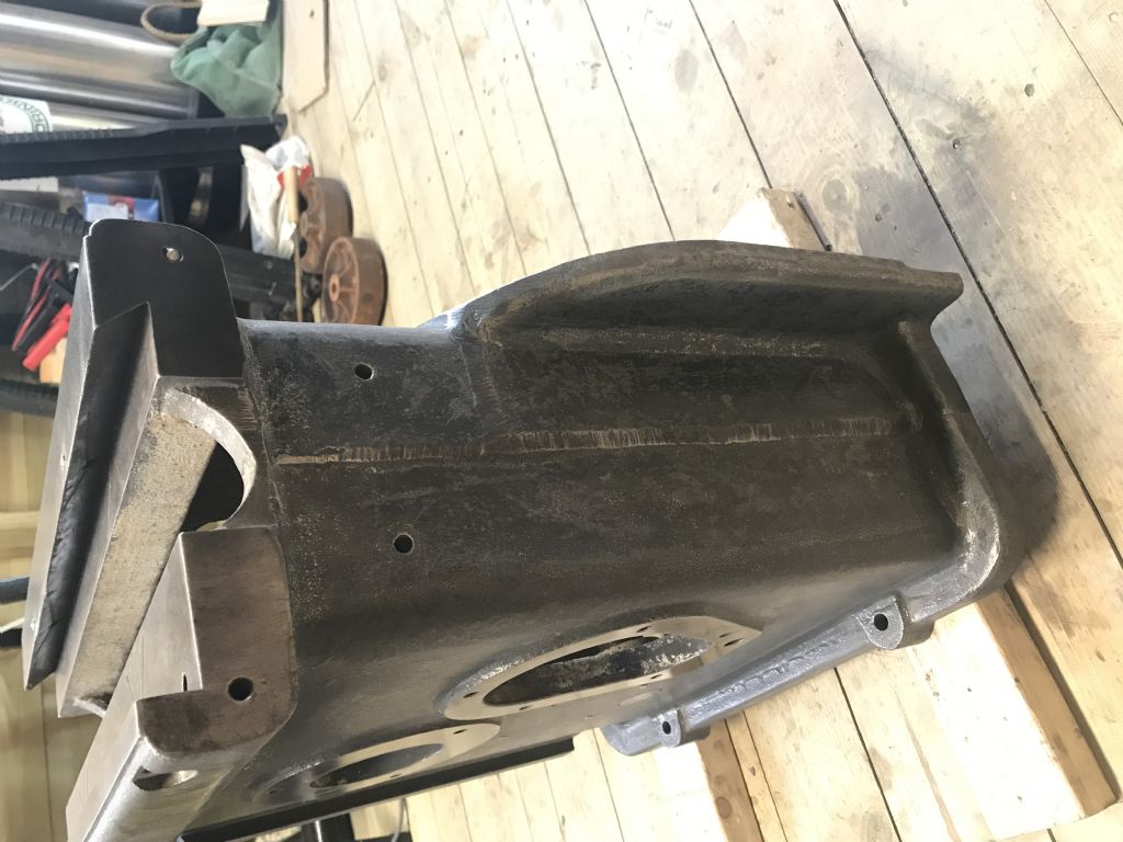

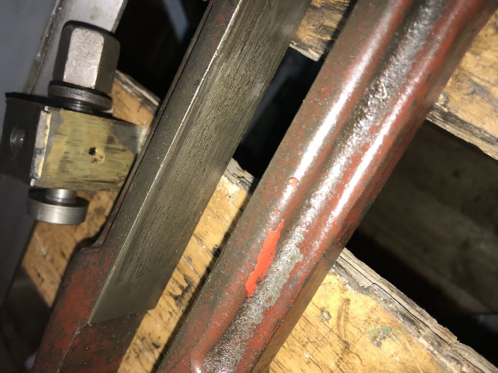

                                          #485684

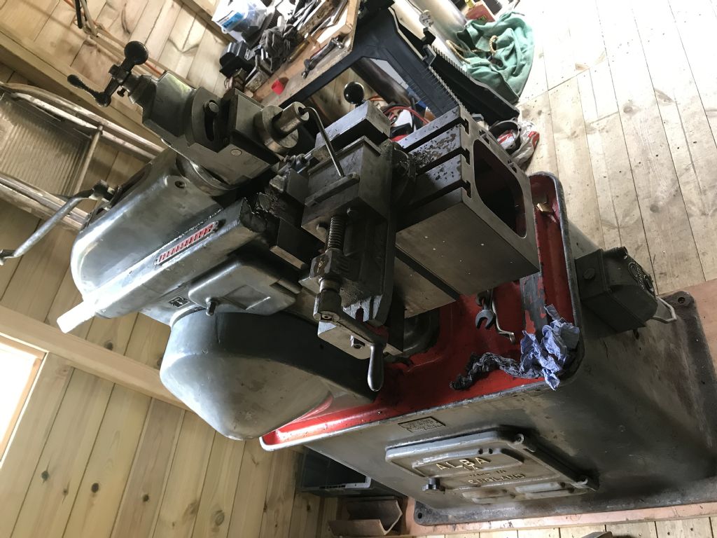

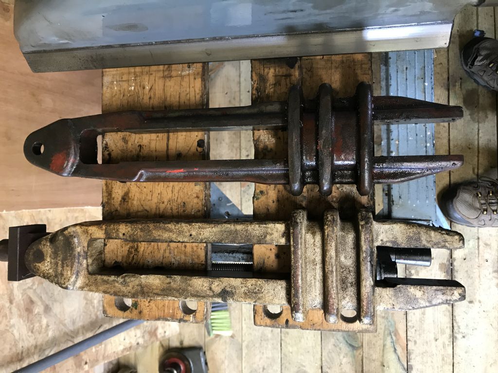

                                          Geoff Brearley
                                            @geoffbrearley24273
                                            9100c72a-afaa-4028-b707-4f838aed9963.jpega2fb9e5e-0c2d-4474-9590-df2583c45387.jpegad763f1b-76e8-4967-a2f8-dc63443560b9.jpeg5603e3a7-5b1d-4a58-8def-513715f7a616.jpeg1702f0a9-6df0-456f-8be1-7eff7424771f.jpeg85977889-45b2-4acb-9f8c-c1ece72d53f0.jpegd770c7fd-29bb-4454-9cb8-0c4ba45f8fc2.jpege0d97caf-9d57-4db0-872d-85519948a03e.jpeg 5cec2473-465d-4ee1-836d-c59b846d324a.jpegSo, I decided to buy a second Alba 1A that came up for sale locally. This time a complete machine thankfully. My thinking was that it would help me to rebuild the original one and then maybe I could sell it on and free up a bit of money.

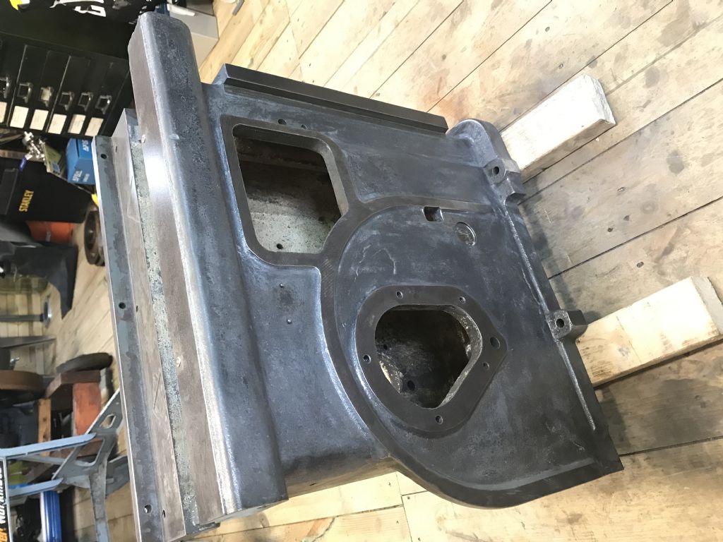

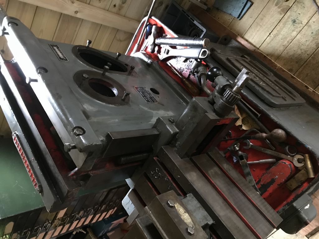

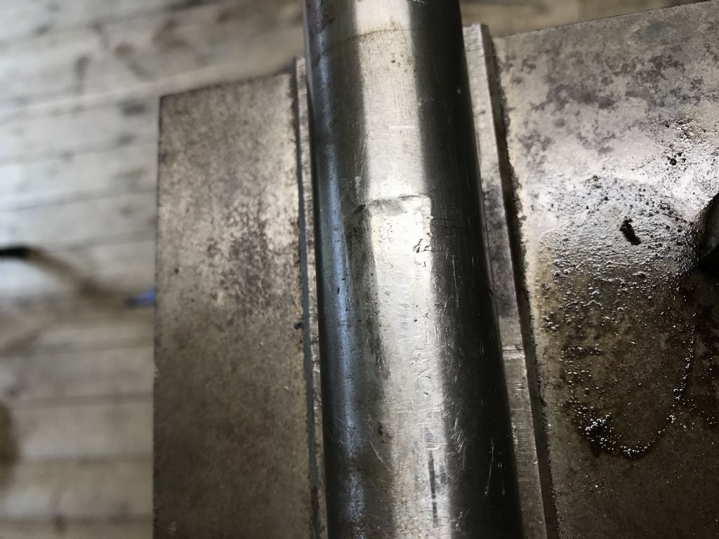

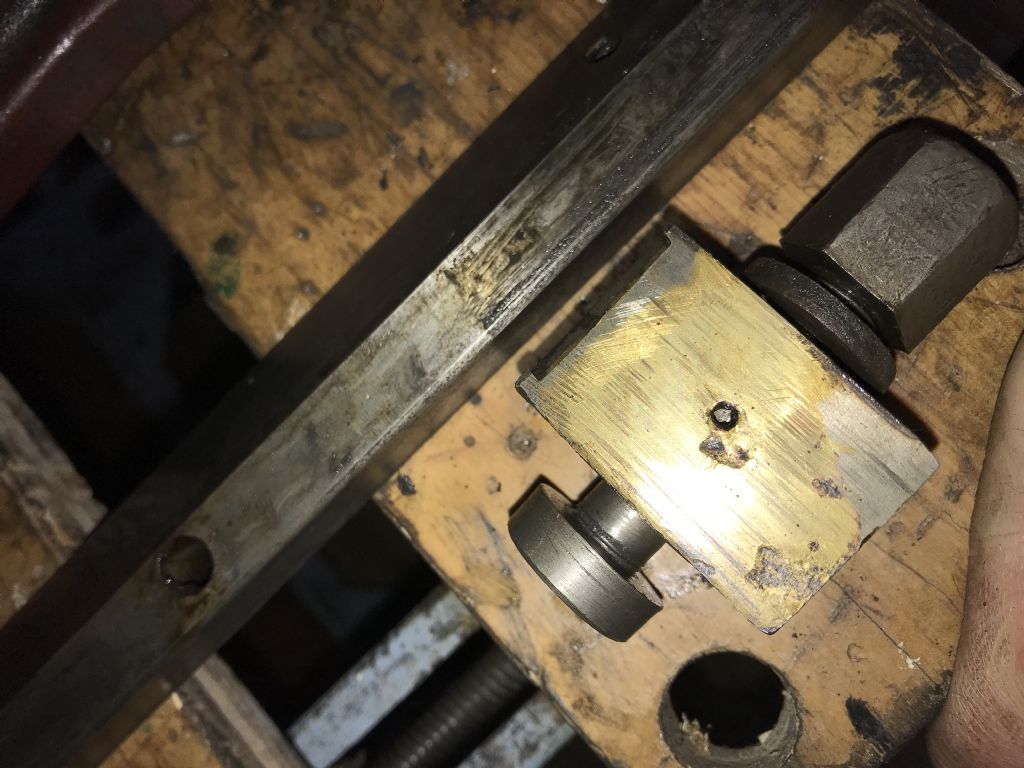

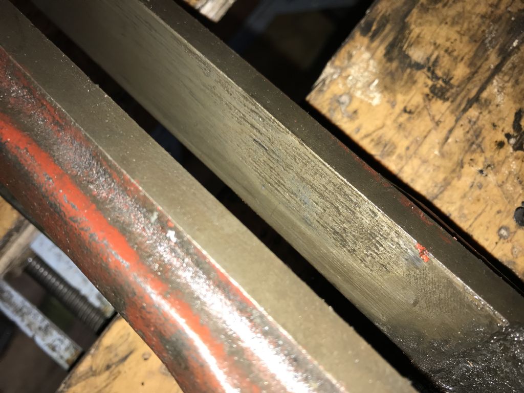

                                            I think I was wrong.
                                            the original machine was painted white inside, my new toy is red inside. Don’t know if this is an indicator to some of you? Differences I’ve noted so far are: the shape of the rocker arm castings, the angle of the dovetails on the ram. There are other subtle differences too.
                                            So, the rocker arm and die block are badly worn on my new machine, as is the rocker arm pivot and it’s fork on the rocker arm. I feel a bit stupid for spending quite a chunk of money on it and it’s really not useable. I almost took it on face value that it was in good order but should have spent more time going over it first.
                                            I’ll have to get it working now as I’ve invested too much time effort and money into it. My problem is that I don’t have access to a milling machine to allow me to do the work.
                                            does anyone know anyone in the north east (preferably Teesside) that might be willing to take on the task for me.
                                            I was hoping to be shaping like a goodun by now.
                                            #485688
                                            John Olsen
                                              @johnolsen79199
                                              It is interesting that there are differences in the castings like that, you would think that once you had a set of patterns they would keep being used.
                                              My one is painted red inside, but I can't be sure if that is original or not since I think the outside had been painted by the last owner. It is a nice eggshell blue hammerite finish.
                                              I'm a bit far away to be able to help with the machining, the nearest river being the Waikato rather than the Tees. It does look like you have got a good vice with it.
                                              regards

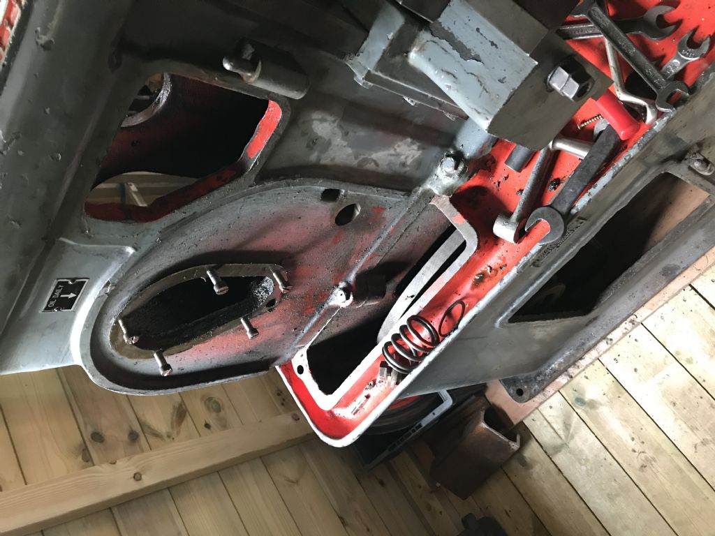

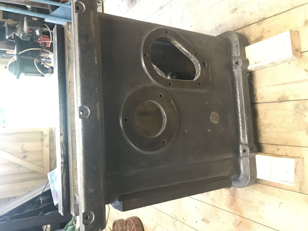

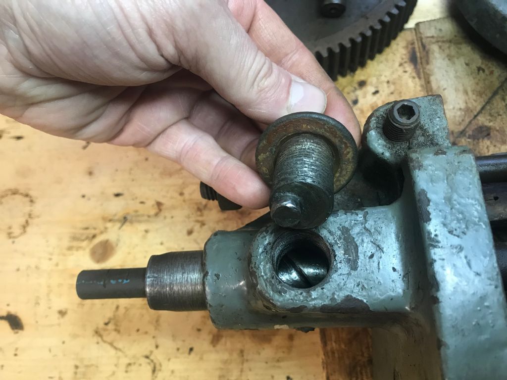

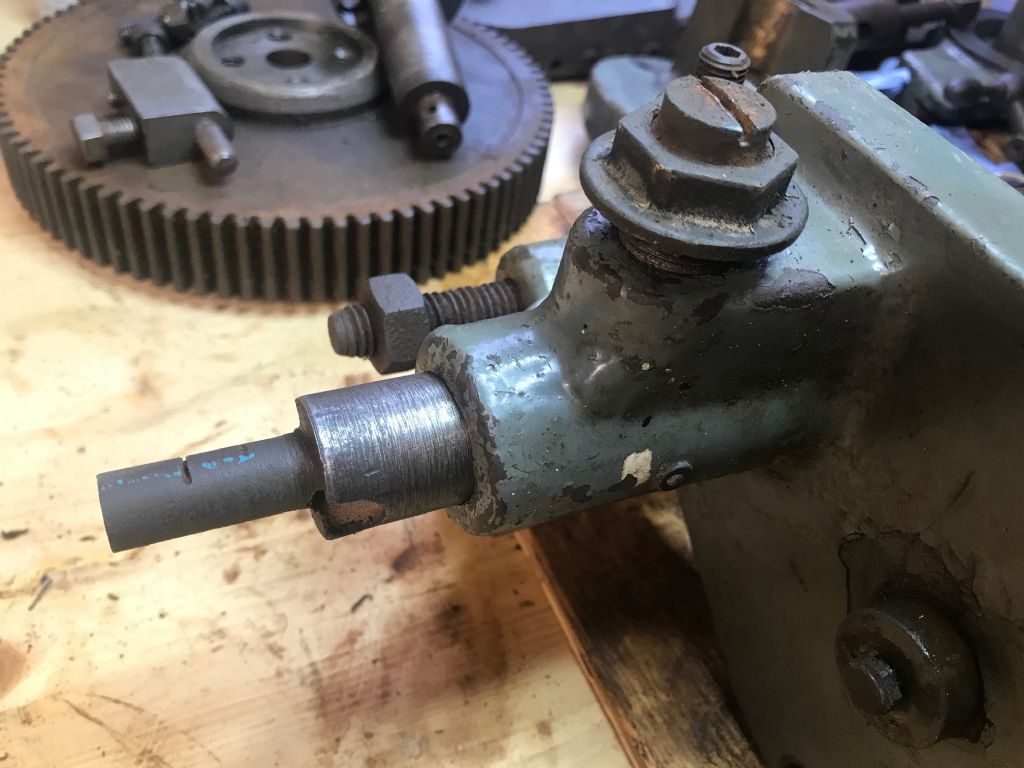

                                                  Well, shaper number 2 is now in a million bits.
                                                  Ive spoken to a local engineering company who said that they can do all the work that’s needed. Hopefully it’s not going to cost an arm and a leg.
                                                  Here are a couple more pictures of the progress. I actually managed to get the big pivot pin out of this one. You can see the wear. The company that’s agreed to do the work said they would put a PB sleeve over the pin.

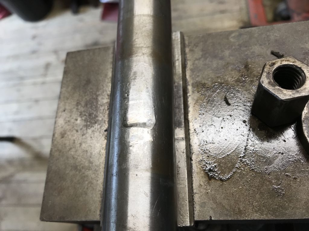

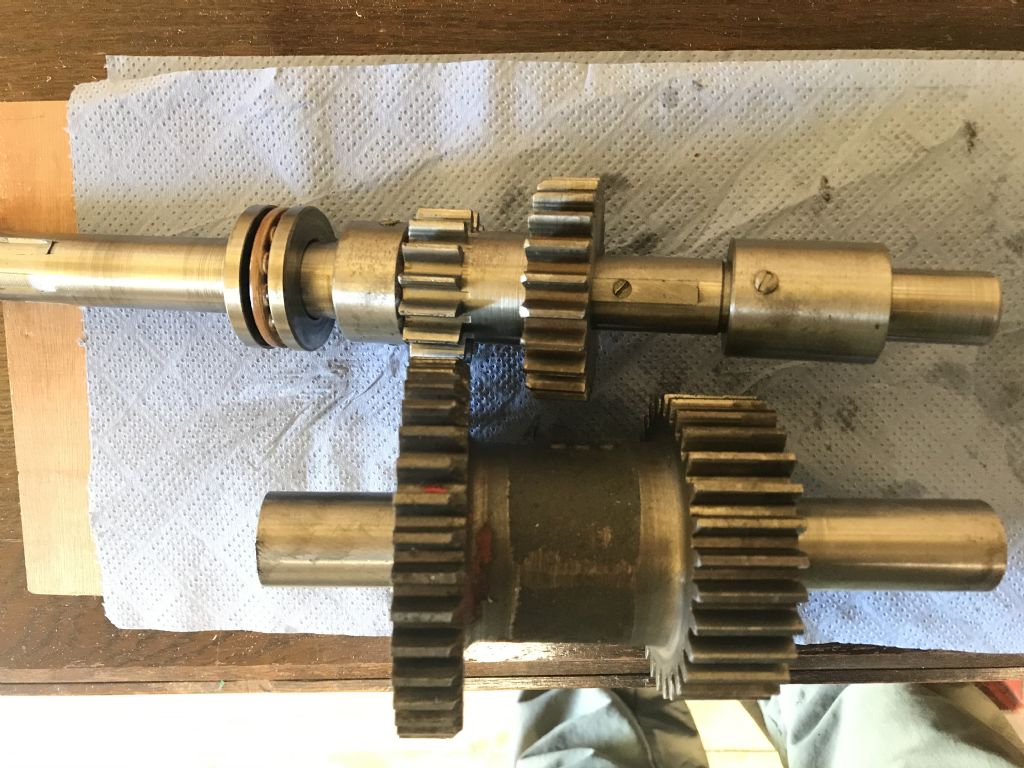

                                                  #488560

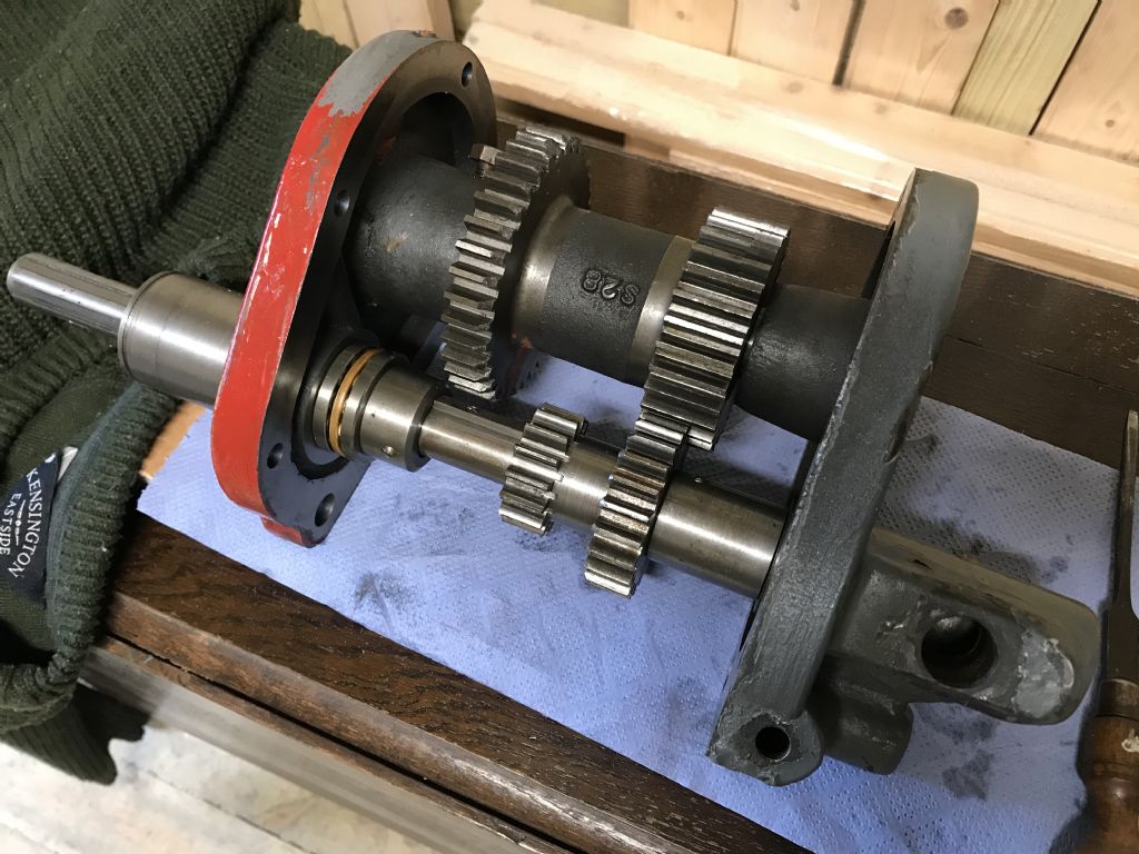

                                                  Geoff Brearley
                                                    @geoffbrearley24273
                                                    #488562
                                                    Geoff Brearley

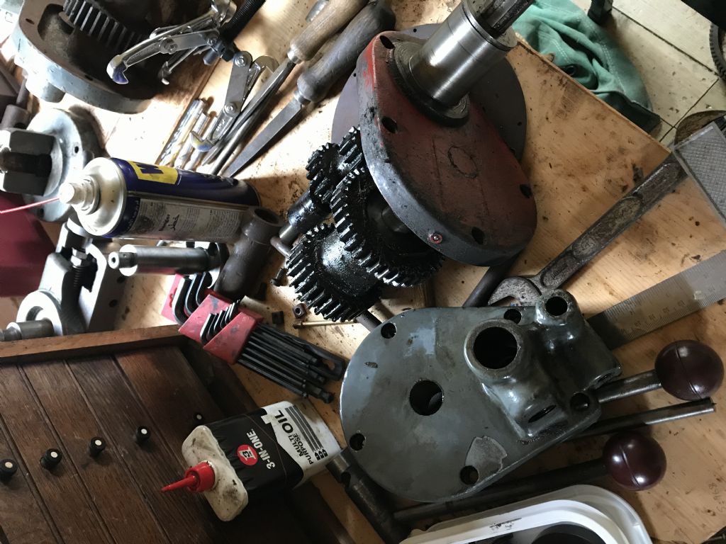

                                                      @geoffbrearley24273
                                                      update:
                                                      The connecting rod, block and pivot pin are away to be re-machined. A new block will be roughed out for me to finish when it comes back. The pivot pin will be turned down , a sleeve made and also a top hat to close it off.
                                                      The gearbox is all cleaned up now and ready to go back in. There are a few teeth with the edges broken off, but still enough meat on them to operate ok.
                                                      Geoff.
