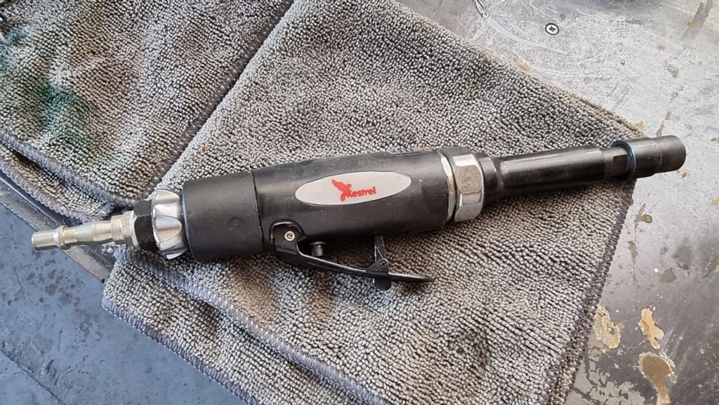

                                            Stephen, i commented earlier in this thread , but omited to say. Using a die grinder or any air tool can be ran from any compressor. It is the time thing. Example. I used one & other air tools to mirror polish a Suzuki motorcycle frame & swing arm. I was using the tools all day long. The compressor was pretty much flat out all the time. If i had a small job to do then your small compressor may well do the job. Pic shown of mine. US pro tools do one as do Bergen tools. Then the trusty Draper ones. Too many to list. Electric ones i cannot comment . As an aside if you do go the air route you need a good set of ear defenders as they are noisy sods.
                                            Steve.
