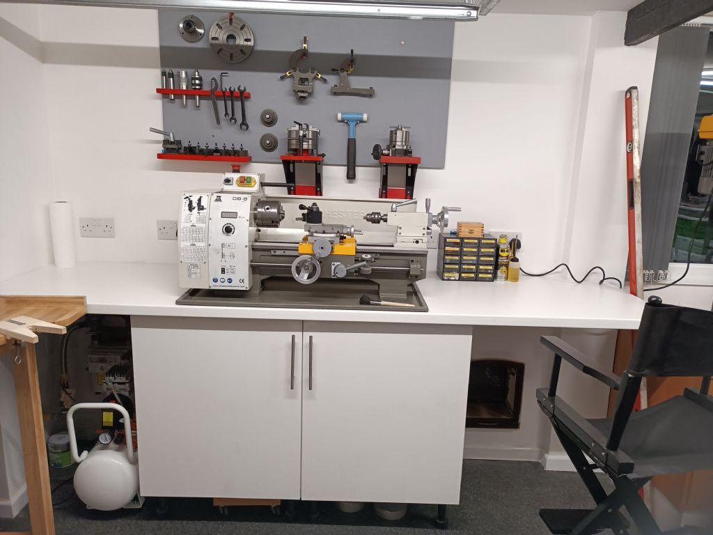

                  Gerhard Novak
                    @gerhardnovak66893
                    new workshop 9I have a similar model from Vevor, 750W, 30l tank. I suppose it comes from the same factory than the Hyunday ones, but as it is non branded it is much cheaper… (140&pound. I am extremely happy with it, as I am not using a pneumatic hammer or similar air hungry tools it does its job. Running a Stuart engine: no problem at all. I have a no9, with 1 1/2 x 1 1/2 it is comparable with a victoria from size point of view, no need for a bigger compressor at all.
                    I can run my compressor in the middle of the night without getting the whole street out of bed. Really silent. See it on the left hand side of  the lathe cabinet.
                    Edited By Gerhard Novak on 31/01/2022 21:38:41
