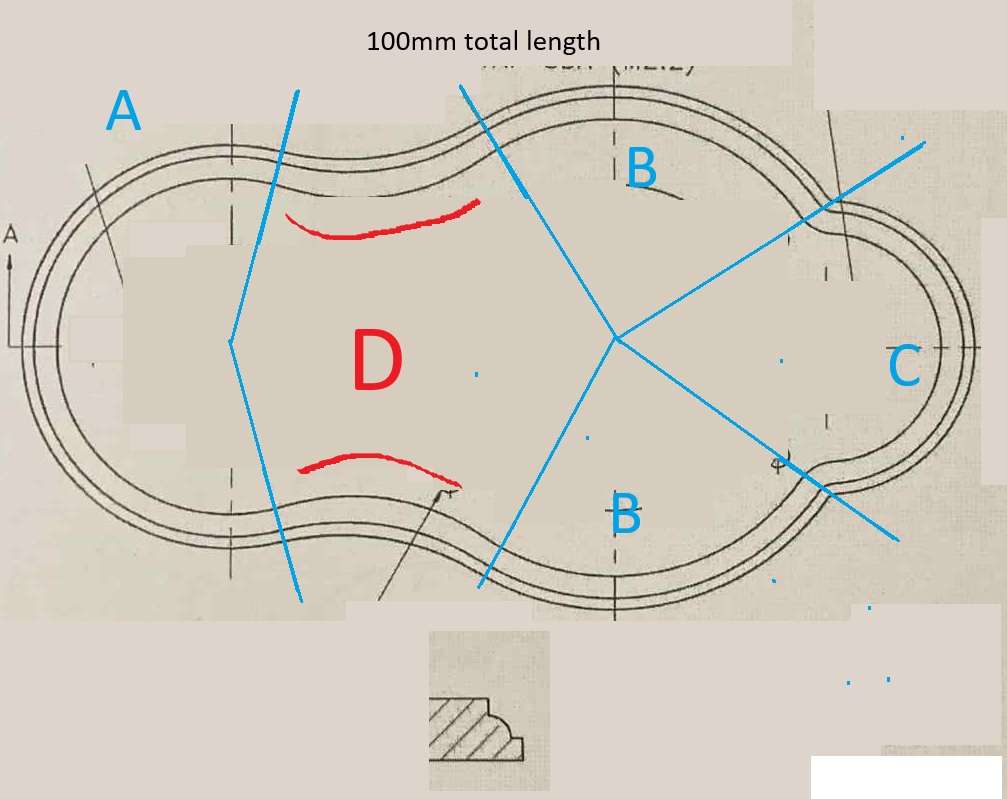

      I thinking of making a Bensen vertical steam engine and this is the base plate for it. I haven’t yet worked out how to machine it. I’m hoping someone might be help me out with soem advice.
      The base plate is about 100mm long by 75mm wide. I might make it out of aluminium. I have a mill and a rotary table.
      So for section A, B and C I thought I would use the mill and with pivot it around the centre of the circular segment  using my rotary table. I’ll use a R3 end mill cutter to get that concave radius around it.
      How can I machine section D and get a similar R3 profile?
      Thanks, Greg

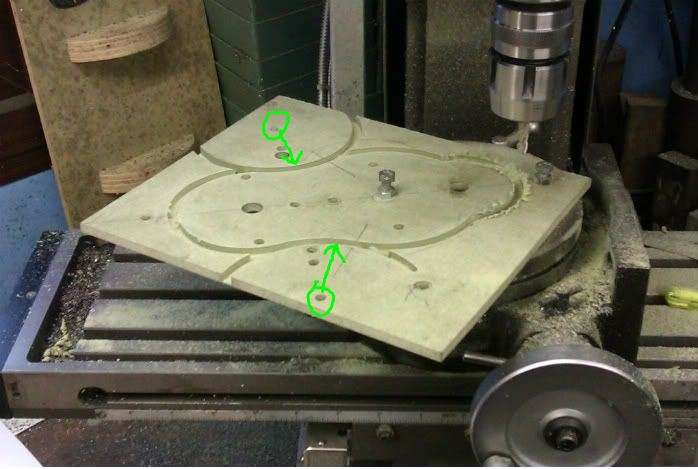

        There are two ways depending on what size material you start with.
        If you have a large sheet you can mark the ctr position of the two “D” arcs on that. You then just need to locate those marks centrally on the rotary table, clamp the plate in place then offset the mill table and machine the arcs.
        If you only just have enough for the part then it can be mounted on a sub plate that only need be MDF or Ply just something to mark those ctr positions on.
        This shows the two ctr positions outside of the actual part. You would just substitute your aluminium plate. Then I would sugged milling almost right through with say a 6mm cutter then change to your R3, alter the offset of teh mill table and cut the profile.
        bb base

          Thanks Jason. That’s very helpful. I thought for the concave radi to would have required the base plate to be too far offset from centre to mount on my rotary table (150mm), but I hadn’t thought about using a larger plate to start with to keep it all rigid.
          I’ll draw the base plate up with the pivot points to work out how far I need offset it, and then work out if I go with a larger plate or mount it on something like it looks like you’ve done.

                    I did consider suggesting the boring head for the main concave parts of the base but that still leaves the question of machining the 3mm quarter round detail. Doing it as I suggested allows both to be done at the one setting on the rotary table so reducing the number of setups and possible inaccuracies that may result.
                    I’m not sure how a boring head would work for the 3mm convex radii as you would not be able to swing a small enough circle particularly at the B/C junction and would also have to pack the work up to allow the boring had to pass beyond the bottom of the work
                    If using a subplate I would not be too worried about true edges for a job like this. Sharpie mark in the middle your blank stock will allow you to position your mill spindle over it and then set out the holes from there – both the ones for the external pivot points as well as those to locate ctr of cylinder, column and pump as well as any screw hole sto fix the cylinder base and column base. You then just need a peg in the rotary table’s middle and can locate all the arc centres from the holes. No nee dto us ean edge.
                    Yes a square and true datum edge and end are useful on some occasins but no nee dto overthing a part like this.
