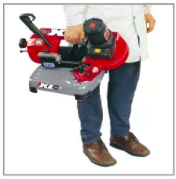

              Go for a small portable bandsaw, can be picked up with one hand and put under a bench if you are tight for room and at 100×100 capacity far greater than you will get with a small 115mm grinder. A 230mm would eventually cut through 100mm bar if you cut from both sides but they take a lot of hanging onto and you will have a big bill for worn discs
              They will also do the job in a fraction of the time that hacksaw will.

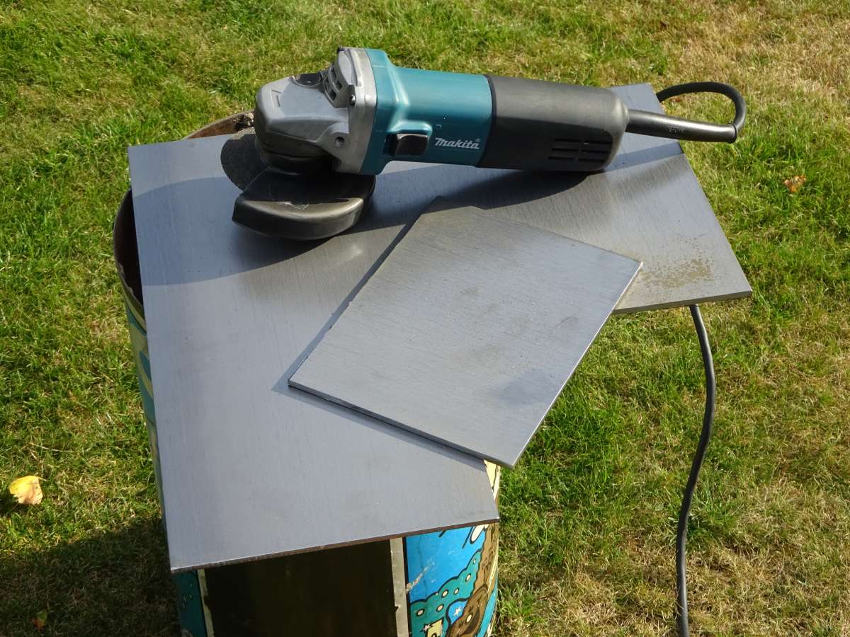

                            Clive the sort of “portable” bandsaw I was talking of is the Femi which I also have, similar style can be had for less. Not the Lidl type which are essentially handheld machines though you can get “chop” stands for some of them. The Lidl/Parkside one is available with the chop type stand.
                            I have not got round to making a table for my Femi as the throat is a bit limiting anyway so am happy to grab the 115mm grinder when sheet & plate need cutting. Having spent a lot of time on building sites I am quite happy using them but if anyone is getting on a bit and your grip is not so good then freehand may not be the way to go.

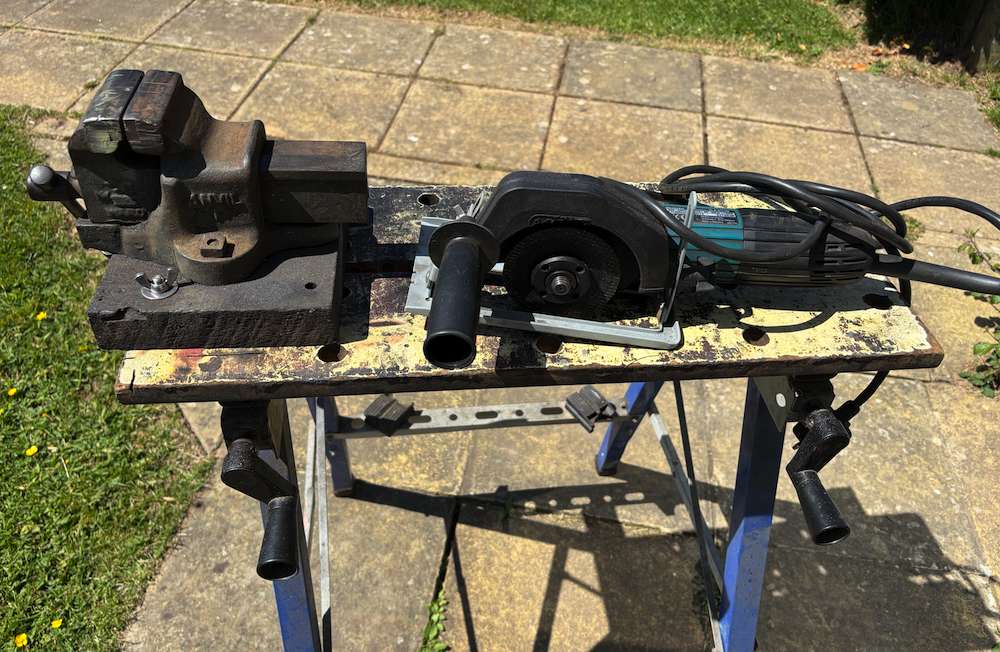

                                  This is what I have for take it outside to abrasive cut, grind or flap wheel clean with a hand held grinder jobs.
                                  Outside Grinding Set-up R
                                  Mains powered Makita was going spare after deciding all battery was the way to go so it lives permanently on the slider base. Base was £12.00 off t’net I think and very effective. I borrow the long arm guide I made for my circular saw when I want straight cuts. For simple chops on stuff held in the vice the battery Makita comes out.
                                  Vice is nice but it does make the workmate knock off heavy and unbalanced when moving.

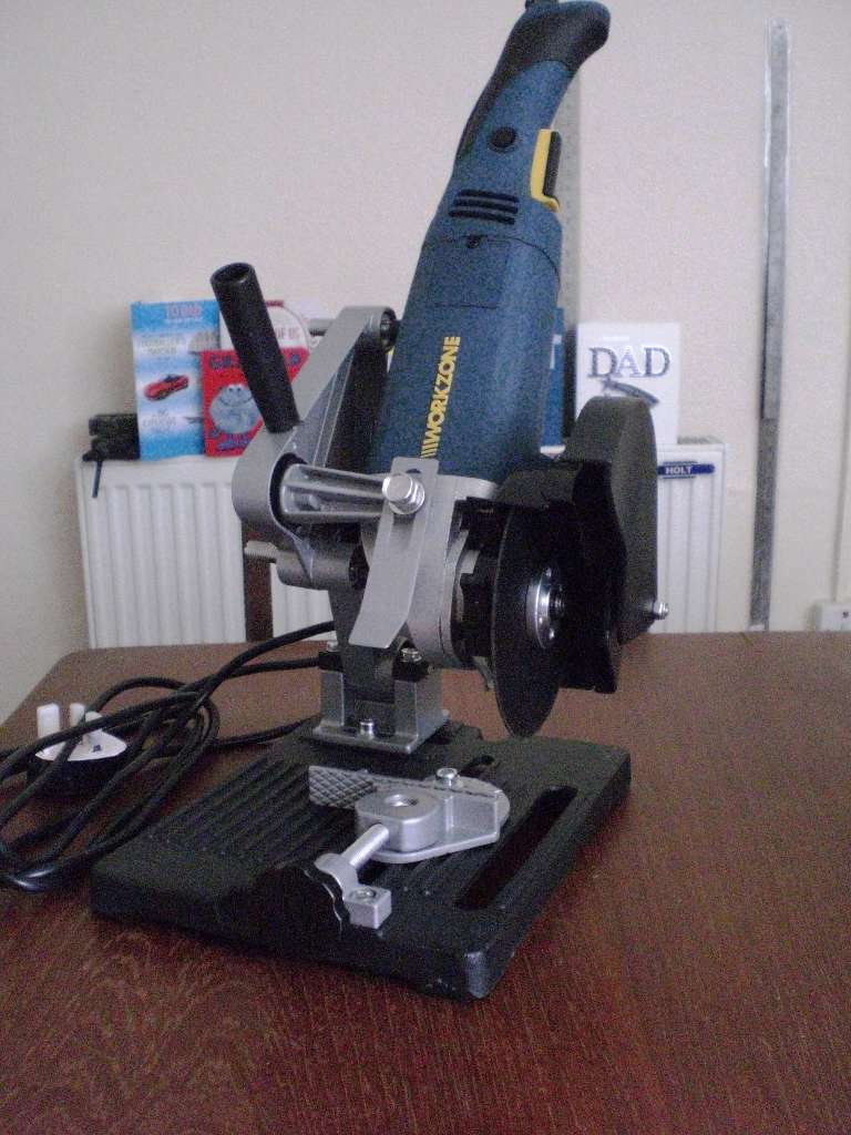

                                      Hi, with any hand held angle grinder of any size, you should use both hands when using it, and have the correct disc for the material that you are grinding or cutting, and has been said, you can get them for steel, stainless steel, concrete, aluminium, and many others, including some plastics. I bought a 5 inch one from Aldi’s some years ago, and got a chop-saw attachment to go with it.
                                      CIMG2082 (768x1024) (2)
                                      I don’t think I’ve used the chop-saw attachment more than about three or four times since I’ve had it, and I don’t think I’d use it for anything bigger than 25mm in diameter, and cirtanly not contiously.
                                      I have been using angle grinders ever since I left school, and back then, they were the nine inch die-cast type, no mini grinders, but there were seven inch ones, but it was several years before I ever used one of those. The thickness of any material you cut, is only really limited to the size of the disc being used, and maybe other obstructions getting in the way. The most important things to consider are, being physically able to handle the machine, your own ability to use such things in a safe manner, a safe environment, and full and proper PPE.
                                      Personally, if I was cutting up lengths of bar, I would use a power saw, unless I was cutting it up for scrap.
