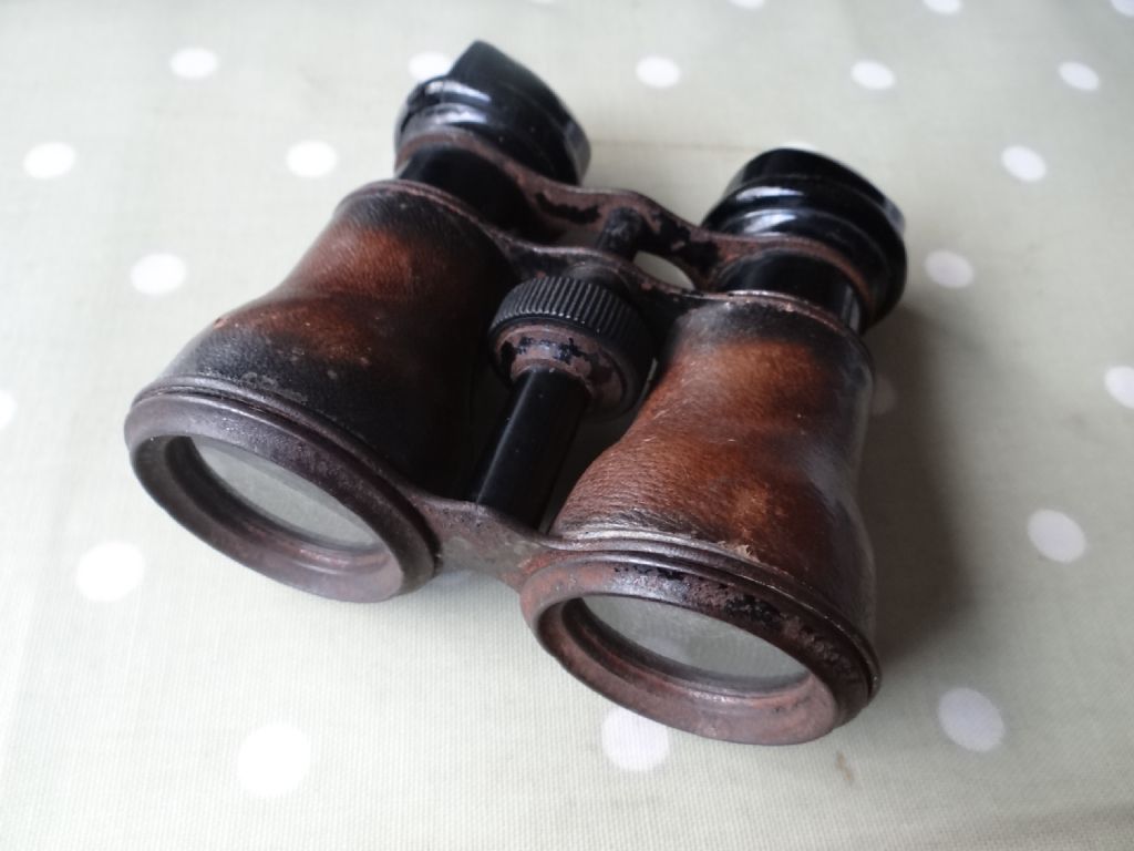

      Not quite a 'scientific instrument', however I've been asked to look at this pair of Opera Glasses, an optical instrument made of brass and steel with leather grips. As they have sentimental value I don't want to make them worse through ignorance.
      The most obvious problem is that one of the eye-piece lenses has slipped out of position probably after being dropped.

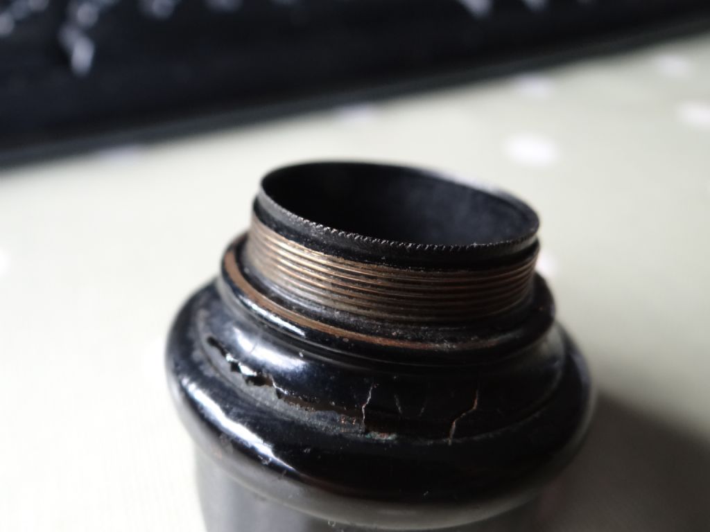

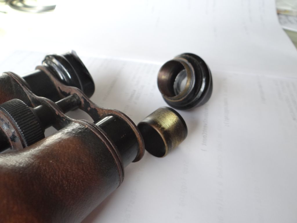

      The eye-piece itself unscrews easily:
      I think the lens is held in position with a threaded inner sleeve. In the photo above the sleeve may be the tube with a serrated top-edge. I've tried unscrewing it but nothing moves.
      Can someone confirm that it is a threaded sleeve (rather than glued, soldered or some other construction) and suggest how to loosen it please?

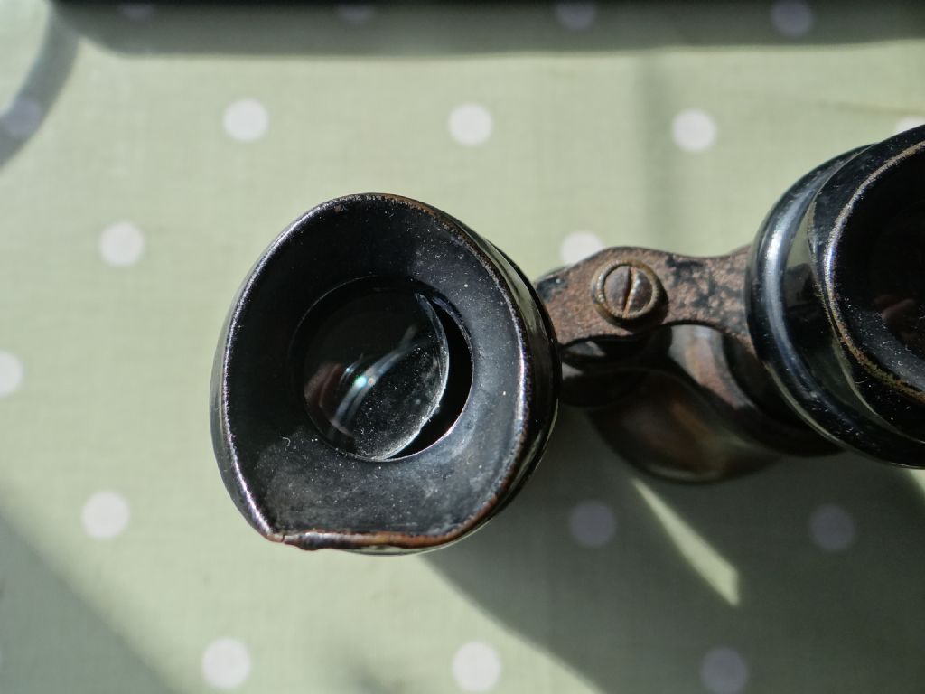

      The second problem is that the body of eye-piece is cracking around it's circumference. (More seriously than is visible in the photo.) Due to it's shape I think the eye-piece may have been made by joining a number of brass pressings together and the join is failing. Can anyone explain how it's made or suggest how the damage might be repaired?
      Thanks,

          I would say you have got a job on with this one. I agree the lens should be accessible via the serrated sleeve. The snag is that the brass is v thin and the threads fine so any jolt will tend to cross a thread or put the sleeve out of round. I would cautiously grip the edge of the sleeve with a stumpy nose plier and use that to try and undo in the usual direction. Don't overdo it or the sleeve will tear or cockle up. That should free it up till it is finger free. Maybe a taste of light oil before you start.
          The eye-piece pressing looks more problematic. My guess is that it is a couple of pressings soft soldered together. The snag is that if you take it apart and re shape it then it will be hard to put it back together any sense. To say nothing of re colouring it. Short of facing that problem I would look to making some sort of shaped stake to go inside and try and 'encourage' it back into some sort of correct shape without doing further damage. As I said, this looks a right job, good luck.

              Farmboy is onto the most likely reason for the serrations.
              I suspect the inner lense securing tube was screwed in lightly using a piece of thick leather mounted on a board. the inner tube was then screwed in slowly while the Assembler viewed the position of the lense through the eyepiece.
              Often the lense was cushioned in it's seat with a form of putty.
              Certainly a challenge to avoid more damage and understanding if it's possible to disassemble.

                  Hi, Dave (SoD) – I have an identical pair of these opera glasses, and can confirm that the eyepiece is held in place by a thin metal tube screwed in. The serrated edge you can see is the top of it. The tube is very thin. I was fortunate, and was able to unscrew mine with my fingers. I think Farmboys/Richard2 ideas are excellent – to use either a piece of wood or leather pressed against the serrations to try and move it. I think using pliers of any kind would be a bad mistake – the tube is very thin and fragile. As a guide to how much you have to 'extract', the inner tube is 13mm long, and the upper 8 mms are threaded. Take care putting it back, its very easy to cross-thread it.
                  When I first renovated mine, all the tubes which slide or rotate inside others were full of dust, and therefore difficult to turn – only after I finished did I realise that perhaps if I had used some oil to make things easier, this would have ended up as a sticky paste with the dust, and made matter worse – just a thought!
                  I just took a closer look at the eyepiece of my glasses. I think the eyepiece rim is turned from solid – its certainly heavy enough. The brass tube which protrudes from it (visible in your last photo) fits inside it down to the seat for the lens, and is threaded internally its whole length – it appears to be soldered or press-fitted inside the eyepiece rim. The lens fits inside this brass tube, and is not bedded into anything – it simply sits on the rim inside the eyepiece, and the inner tube (with the serrated top) is screwed down to hold it in place. There is (was) nothing to 'soften' this clamping, such as putty or a leather weather etc, so I guess you must be careful not to screw the inner tube down too tight and crack the lens – as I said, mine were only finger tight – bit stiff to get moving, but then came out easily.

                    Follow-up to my last post – looking at Daves photos of the eyepiece, it does appear to be made up from several pieces, if only because the lens appears to have slid to one side.
                    My glasses look identical to the ones in the photo, but the eyepiece rim is definitely solid, and the outer brass tube goes right down inside it to the lens seat, so there is no possibility, even if it was bent, for the lens to move as shown in the photo, so possibly it is an earlier or later model.
                    That said, it would certainly be possible to make a replacement from the solid, but cutting the threads would be a challenge. The outer brass tube is threaded internally and externally, and it is very fine thread. Possibly you could make up a rim first from the solid, then carefully cut and turn away your broken rim to recover the original brass tube, and solder that into the new rim.

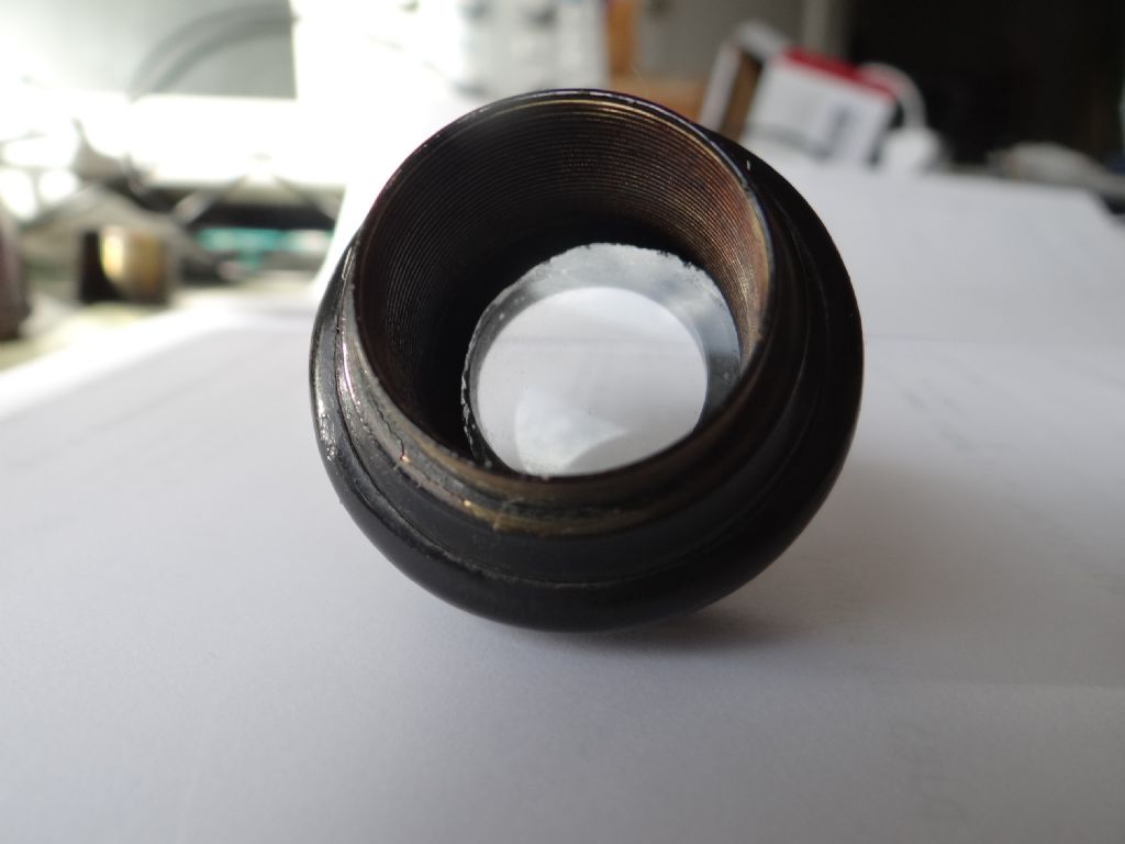

                                      A quick report because other diversions and duties have intruded.
                                      The method was close to that suggested by Ken except I used a tiny drop of penetrating oil rather than alcohol. I guessed that the chunky brass construction and simple uncoated glass lens wouldn't suffer.
                                      Once I got it to move slightly a few gentle tighten/un-tighten cycles loosened it and it unscrewed without fuss.
                                      At that point I expected the lens to drop out. Not so, it's been wedged sideways into the structure of the eyepiece probably due to being dropped. I was able to manoeuver the lens almost back into position, but not enough for it to come out. Sod's Law applies – although very hard to centralise the lens, the blasted thing slips out of position at the slightest excuse.
                                      The edge of the lens is damaged around part of it's circumference. As there's no sign of broken glass inside the eyepiece I think it was nibbled to size by a fitter, possibly during an earlier repair.
                                      I'm tempted to glue the lens back into position. I have the modern equivalent of Canada Balsam to hand and could apply it sparingly around the edges with a needle. Be a few days before I can get back to the repair and I might change my mind : it feels like a bodge.

                                            Hi, Dave,
                                            When I renovated my OGs, i managed to drop the eyepiece lens when I unscrewed the rim, and it was a right b****r to find it again! Your suggestion of Canadian Balsam just about mirrors what I did.
                                            If yours are like mine, the actual 'eyehole' is somewhat smaller than the lens, so in effect it is sitting on quite a wide seat. I simply cleaned up the seat, positioned the rim so it was horizontal, and sat the lens in place. I then used a sharp pointed toothpick to place a couple of tiny blobs of Evostik (impact adhesive) at the edge of the lens, so it was secured inside the eyepiece 'cylinder'. When the glue was dry, I screwed in the retaining cylinder (the bit you have had problems with), and it worked fine.
                                            I used this as opposed to something like shellac because I didn't want the glue to spread around the lens, and fix it permanently, or get onto the lens itself. Very small drops (hence the toothpick) are easy to remove.
                                            Incidentally, the rim of my lenses were not smooth – they have quite a rough finish, with small chips around the edges – they don't matter because they are masked by the eyepiece rim.
                                            The lens doesn't seem to require any 'alignment' as such. There doesn't appear to be any way to adjust it anyway, and there certainly wasn't multiple lenses or packing pieces – these were sold as a relatively cheap pair of opera glasses – simply clean the seat, bung the lens in and screw down the locking tube. It didn't make any visible difference then or now which way around it went – it looked like a symmetrical concave lens.
