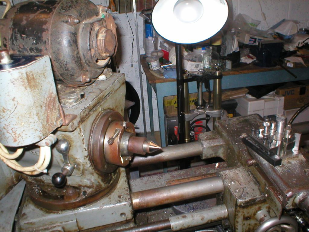

        I am making a tap and die holder. Basically the holder(s) will slide along a shaft held by an MT3 taper in my tailstock
        It might be that I have gone about things in the wrong order. The shaft workpiece started as 25mm dia bar and I cut the shaft onto one end (12mm dia and about 80mm long). I am now holding the shaft in the 3 jaw but even with a centre held in the tailstock there is noticeable flex when cutting the bar to clean up the rough surface before attempting the taper.
        I can see the tailstock flex because the MT3 taper holding the centre is at full extent to clear the saddle and to give a good seat to the the centre into the workpiece
        Do I need to start with a fresh piece of bar and do the taper first and then the shaft? Or try lighter cuts?
        Don’t say use a 4 jaw as that is holding the die holder which has cut nicely and has a nice finish after practising my finishing cuts
        Thanks for any help

                                        #56718
                                        John Coates
                                          @johncoates48577
                                          Update on this
                                          I used the adjustable headstock on my Barker to re-cut the centre and remove the “nipple” at the end. Measured the centre as 60 degrees so set the headstock over 30 degrees (its maximum anyway). Like this:
                                          I then used this method to cut the MT3 taper for the die holder. Set the headstock to approx 1.5 degrees and cut it in no time. Didn’t blue it up and test it in the MT3 socket (will do that later) but just swapped the MT3-MT4 adapter, put the new taper in and cut the end down to 12mm as the shaft for the die holder
                                          Quite impressed by the Barker in this respect. It made taper cutting less of a daunting prospect. As with all my newbie work at the moment, its not pretty but its functional and will get me started tapping and cutting straighter threads !
