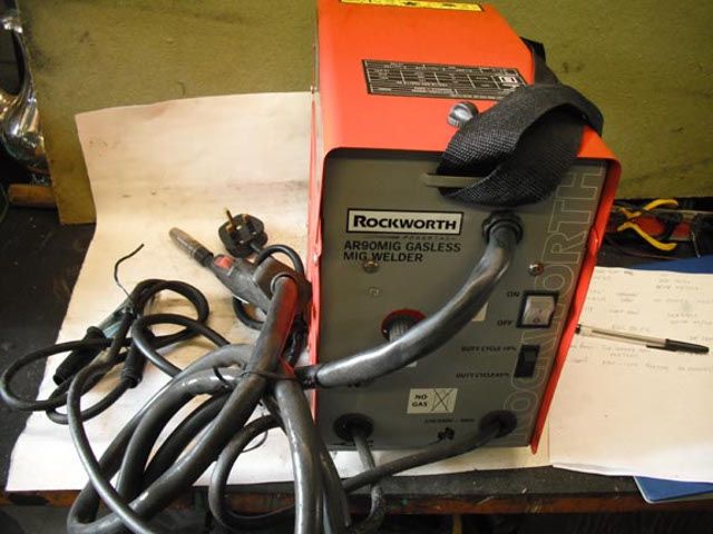

      I've been in electronics for most of my working life and therefore learnt to soft solder very early on. Since retirement, I've taught myself to silver solder/braze. I now wish to learn electric welding. Some weeks ago I had the opportunity to buy a defunct gasless MIG welder, complete with self darkening helmet and various other accessories. I think the guy just wanted rid of it as the price was less than a new helmet. welder.jpg The fault turned out to be really crappy crimps between the aluminium transformer windings and the copper welding cables. Having some aluminium solder, I made some brass sleeves and soldered the joints.
      There was an article some time ago in MEW about converting a gasless welder ot one using gas. This involved reversing the polarity of the welding cables. My welder is AC (about 22 volts off load and not a diode in sight). My question is should I persevere with this obviously cheap and nasty pile of crap or should I weigh it in and buy something decent.

          Hi sounds like you got a bargain and I am no authority on welding but I recon I would flog it and buy a better set. However I would have a think and decide what your requirements now and in the future are likely to be, sheet metalwork, fabrication, all steel material or maybe some stainless and alloy ???
          I feel others will offer more advice but consider the above and maybe add a bit more info

            Hi Anthony, can't say I've ever heard of an AC MIG welder, maybe someone has ripped the rectifier out for some reason and left you with those crappy crimps. I think I would sell it as spares or repair and get a half decent new gas one. The first MIG I had was a gasless one and although it would weld, it left a lot to be desired.
            Regards Nick.
