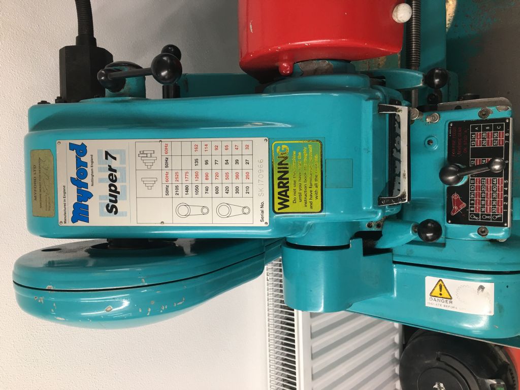

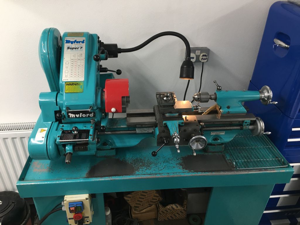

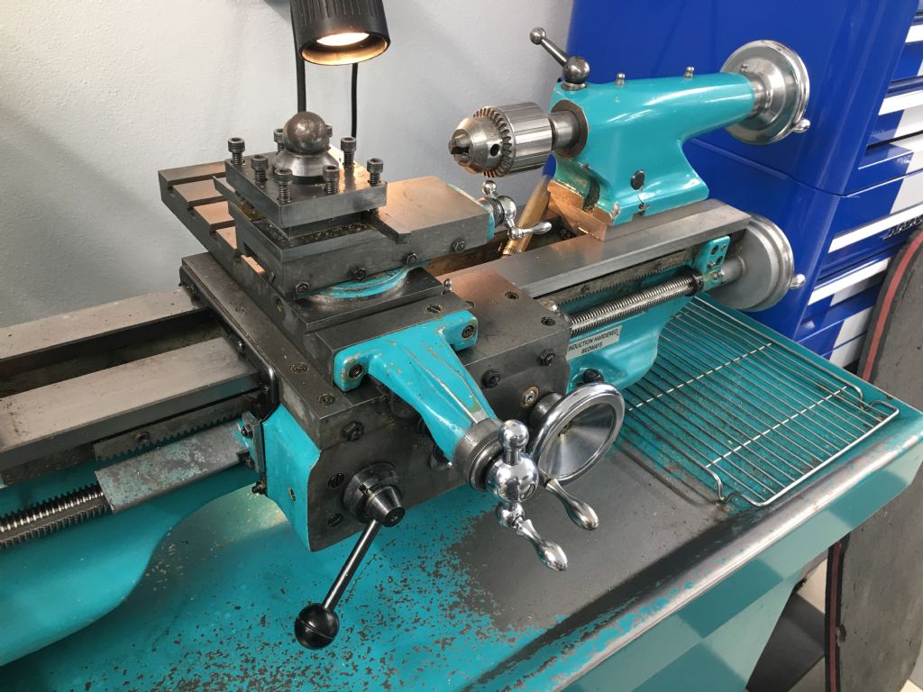

                    Ian Burton 3
                      @ianburton3
                      #338778
                      David Standing 1
                        @davidstanding1
                        Well, plus points are it is a big bore, and has a gearbox.
                        Minus points are it isn't a long bed, and has had a LOT of work, and it doesn't look like it has been particularly sympathetically looked after.
                        Certain big bore parts and accessories are hard to come by/expensive. You still haven't said what accessories are with it, but I would want to see at very least the correct three/four jaw chucks with it, plus the drive and face plates.
                        Given that you have just bought it, I am not sure why you are asking for a value – surely you were happy to pay what you did for it, and that is what it is worth – to you?
                        Myford value is all about condition. I had an almost identical S7 Plus, except it was a long bed, and as new.
                        If yours went on eBay today, I would be surprised if it made, in that condition, more than £3,000.
                        That may not be what you wanted to hear, but you did ask………..

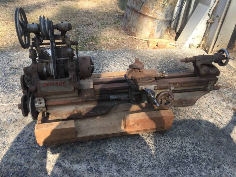

                          EG this local Gumtree example "in good working condition". Really.
                          Apologies for the thread hijack but I think that your S7 looks like a good useable bit of kit. Obviously from the worn paint on the tray and the cross slide bracket it has had a fair bit of use over the years. But that kind of paint loss can happen through using neat cutting oil brushed on in the time-honored manner too. The sulfur or something in the cutting oil is rough on paint. Looking at the bed ways and general condition it looks to have done some work but has not been flogged to death by a long chalk. If you are planning on keeping it, it should do a good job for you, as far as one can tell from the pics.
                          A quick test is to measure the bed. Measure the thickness of the front of the front way, first at the tailstock end then at the high wear area about six to nine inches from the left hand end. More than .005" variation and it's clapped. Then measure the width of the rear shear from front to back in the horizontal plane in the same manner. More than .003" variation and its clapped. These figures are from Myford's reconditioning literature.
                          If on the other hand you are planning to flip it, a quick paint job, keeping the stickers intact, would make it look like a million bucks, well quite a few thousand anyway.

                            It looks in an honest condition so you know what you are looking at, a paintbrush refurb tries to disguise the true condition of a machine. It looks as though it has done some work but could have been well maintained, a smart paint job does not mean a machine is in good mechanical condition. I would want to establish the amount of wear on the bed and screws. If the machine still has plenty of useful life before the bed regrind and screws and nuts need replacing then it could be good for a lot more work. The closer you get to a proper rebuild should reflect in the price. In good condition it would be a desireable machine but if if has been worked to death then the cost of a proper rebuild should be considered in its value.
