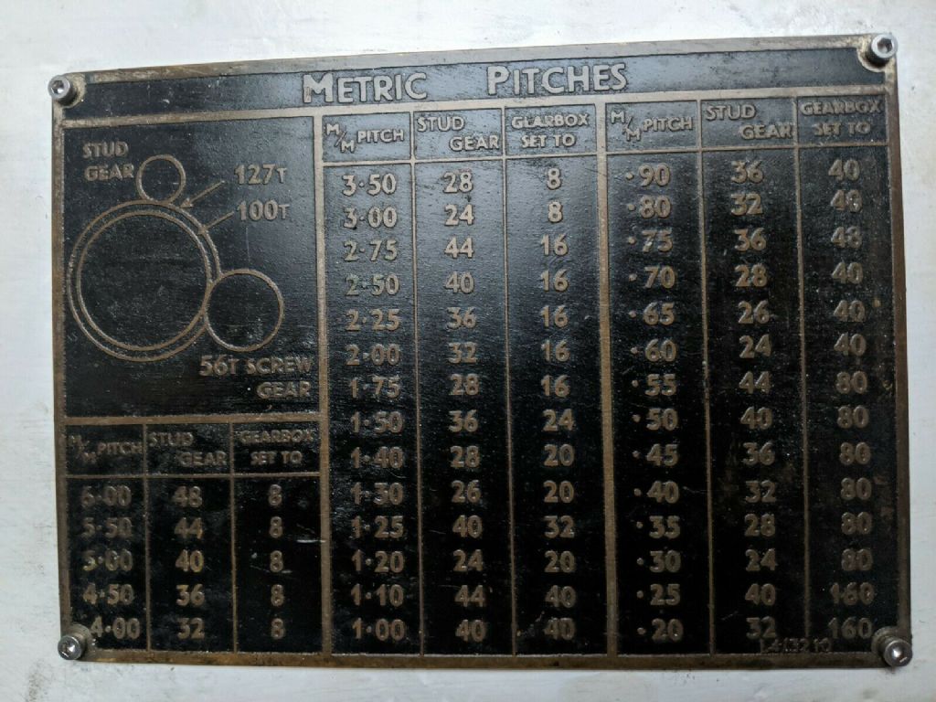

                      I have just cut a really rough thread at the setting shown for 8TPI, and amazingly, it’s correct. My first thread
                      I have that diagram similar to the one you mention with a 100/127 idler. The diagram I have then refers to different stud gears and gearbox setting for different metric TPIs
                      what I don’t get here is that the gearbox has 2 gear settings, and I don’t actually have any of the listed stud gears

                        Looking at that chart it looks like the gearbox has settings for imperial settings from 8 to 160 tpi. The standard set up presumably has the 56 tooth wheel as the screw gear and a 20 tooth stud gear and the 127/100 gear set as an idler. You can work this out from the chart you have showing a 40 tooth stud gear for a 5mm pitch thread and the gearbox set to 8.
                        If you have a 20 tooth stud gear instead you get 2.5mm pitch. If you multiply this by 127 and divide by 100 you get 3.175mm pitch. 8 x 3.175mm is 25.4mm. So with the gearbox set to 8 with the 20 tooth stud gear you will get 8 tpi.

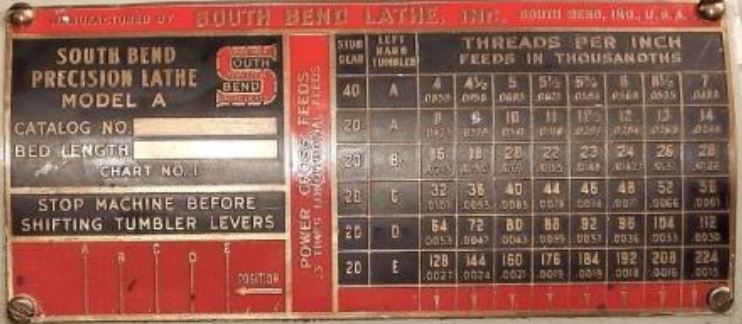

                            Does your lathe have a gearbox with a plate like this?
                            Martin C
                            #473802
                            Jim Beagley
                              @jimbeagley46363
                              Posted by Martin Connelly on 21/05/2020 23:24:54:
                              Martin C
                              Yes, exactly the same.

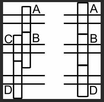

                                Somewhere there should be a diagram similar to this, either on the lathe or in the manual you probably don't have.
                                This not too clear diagram is a side view of the change gears. A is your stud gear, B is your 127 tooth gear, C is your 100 tooth gear and D is your 56 tooth screw gear. The left hand illustration shows the setup for metric thread pitches, the right hand illustration shows the setup for imperial threads per inch settings. In the right hand setup the B gear is an idler and so the tooth count is not too important, I suspect that if you have the 20 tooth stud gear in then the 127 tooth gear will work as an idler. If you had a 40 tooth stud gear then you may find you need to use the 100 tooth gear as an idler.
                                Anyway, from the gearbox plate we see that to do an 8tpi thread we need the stud gear (label A above) to be 20 teeth. We need the left hand gear selector to be in position A and the right hand gear selector to be in the leftmost position.
                                From the gearbox label we can see if we just change the left hand gear selector progressively through positions A, B, C, D and E we double the tpi count with each move. This means we are halving the lead screw revolution (relative to the spindle) with each move towards the right. This is quite typical for a lot of lathe gearboxes with two gear selectors. One selector has this halving/doubling action. The right hand lever has gears with a tooth count in ratios of 16, 18, 20, 22, 23, 24, 26, 28. We can tell this because just changing the right hand lever produces threads with these counts going from left to right on the third row. The actual number of teeth may be double this. This combination of change gears and 2 ratio selectors gives all the threads you are likely to need but is not comprehensive, BA threads for example are not included.
                                I don't know if you have a thread dial indicator but luckily for you an 8 tpi thread and an 8 tpi leadscrew means you can engage the half nuts anywhere on the leadscrew and be in the correct position for multiple passes to cut the thread.

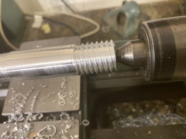

                                  luckily I do have the thread dial indicator and I used it to cut my first (ratty) thread last night.
                                  I do get that the 127/100 gear converts the imperial system to metric threads – I guess I will have to try and source one of these. At the moment there is a simple single 80T idler gear between the 20T stud and the 56T drive gear.
                                  I also now more fully understand the gearbox functionality – thanks.
                                  I guess the 40T stud has also got lost before I had the machine.
                                  Will the Myford gears I see advertised fit? The ID seems the same but I am unfamiliar with PD and PCD.
                                  Best, Jim
                                  ps here is my horrible thread, but it was the wrong insert and the wrong feed but it’s a start

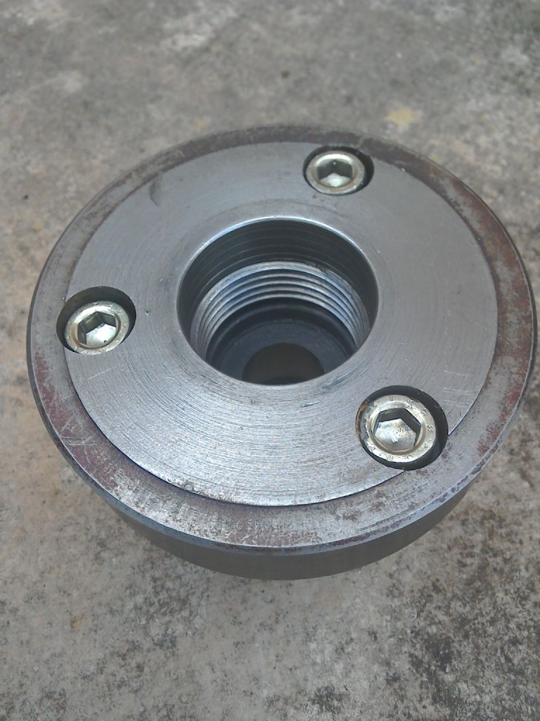

                                      Just a comment regarding thread cutting, this process really does benefit from a quality thread cutting oil. I use a small paintbrush and Rocol RTD oil but others are available.
                                      The other thing I have done is an aluminium dummy spindle nose (not bored) to check the threading progress in backplates as is cut. Before you start on an actual backplate this would make a good project to practice threading on. I'll dig out either the dummy or an existing photo.
                                      Martin C

                                        Great minds actually. It was also my intention to make a dummy spindle nose to check the threads, plus it’s going to be simpler for me to start with the external I think. I’ve got some MS steel blanks of the right size in order too.
                                        move got some Moly cutting grease. Maybe that’ll work.
