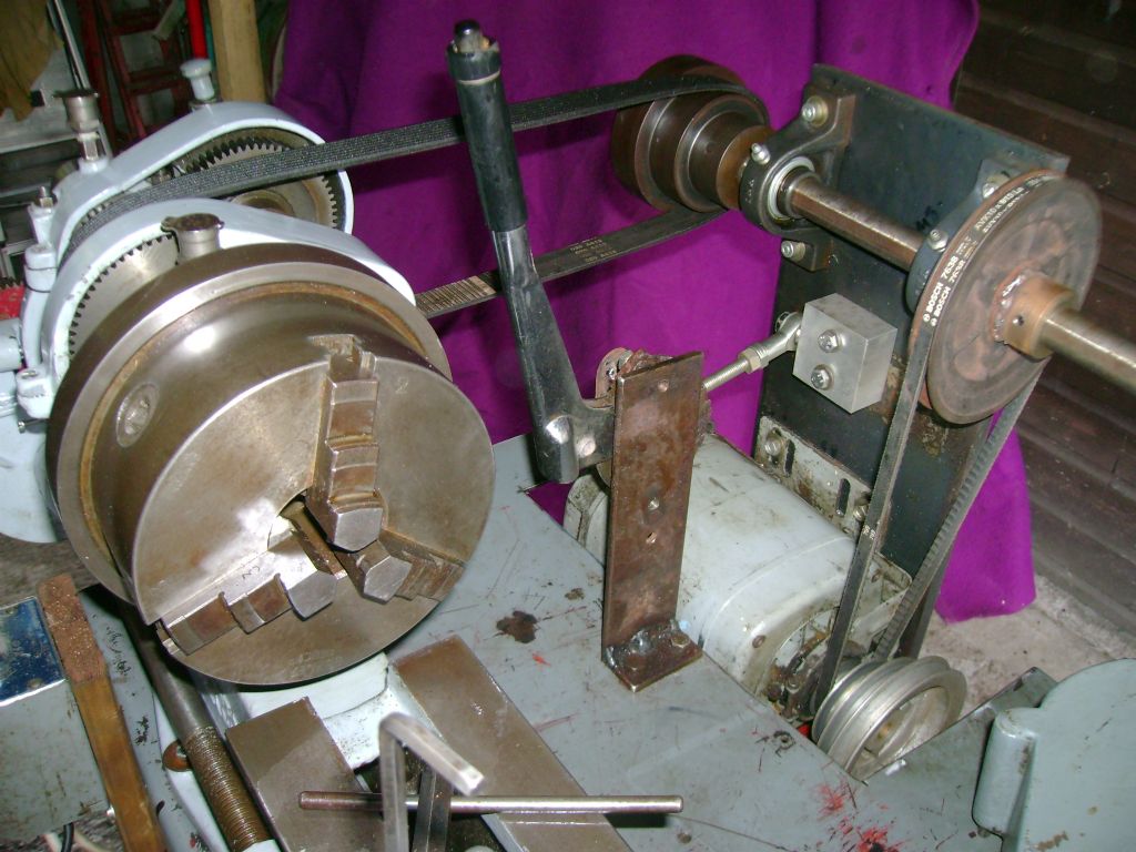

            Hi this is one from my album of the Vee Belt clutch on my wood lathe
            More pics in my album may be what you are looking for
            Not too clear thethe clutch lever goes just over centres and on to a stop that can just be made out in Pic  1

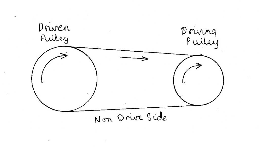

                            I know, this old chestnut again. How do you tell what the "non-drive" side of the pulley is, as mentioned by Gordon W above? Thanks – Bob

                                Posted by Robert Adkisson on 30/05/2022 19:36:02:
                                Robert
                                The belt direction will provide the info you need, the drive belt will be pulled by the motor pulley on the drive side between pulleys, so the non-drive side will be the other leg of the belt.
                                    Hi Bob, quite simple really, as belts can only pull and not push, it will be as shown below and if the driving pulley is reversed, the drive side and the non drive side will change places.
                                    Regards Nick.
                                    #600028
                                    not done it yet
                                      @notdoneityet
                                      The slacker side, when running.
