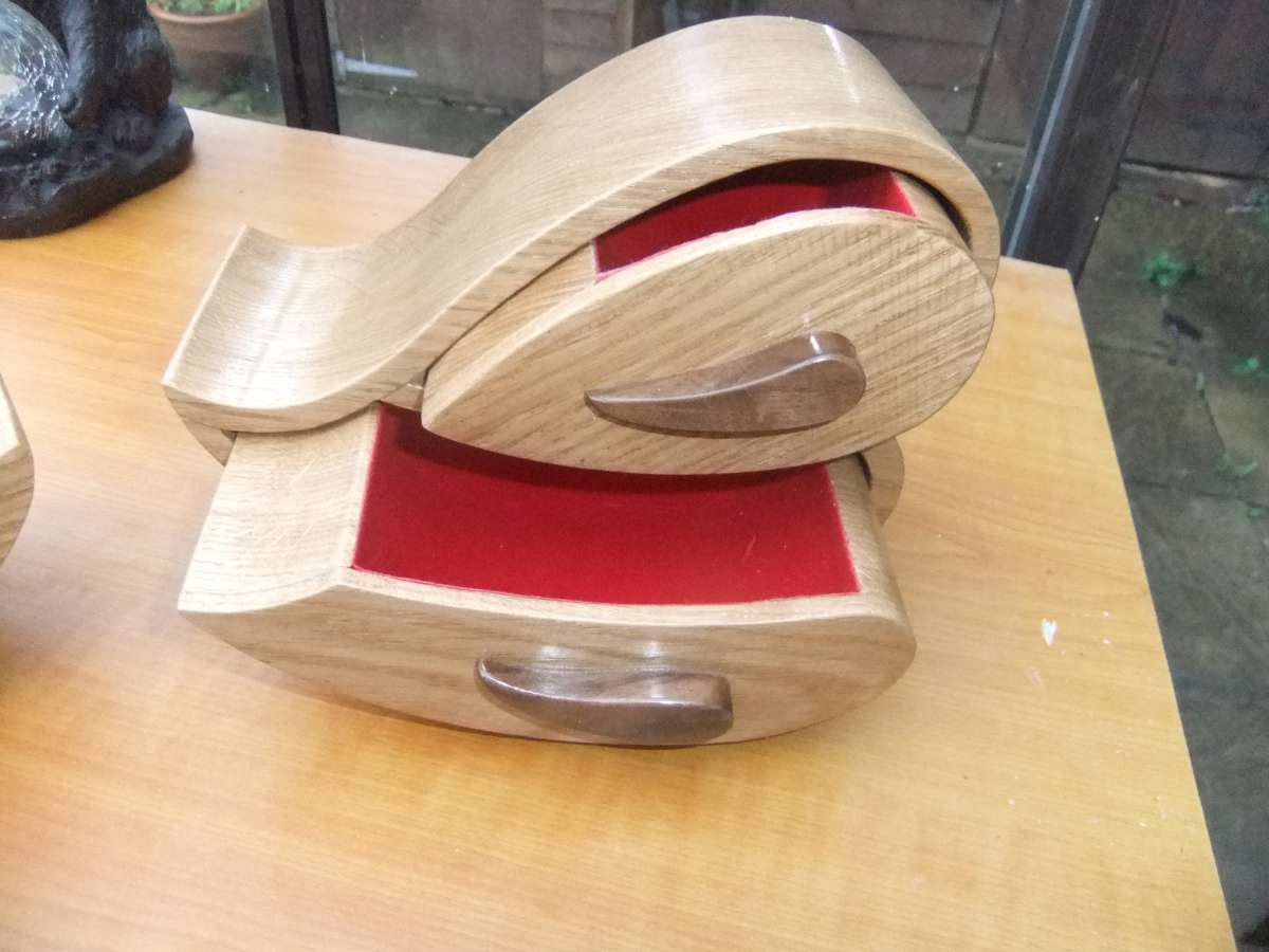

                          I use the adhesive backed baize with great effect. It can be brought in various colour. With this job I used a very fine sand paper along the edges sanding outward to produce a clean edge.DSCF2953
                          If you go for the spray type adhesives, make sure which you are buying. Some are semi-permanent, like the ones used by those that frame photographs.

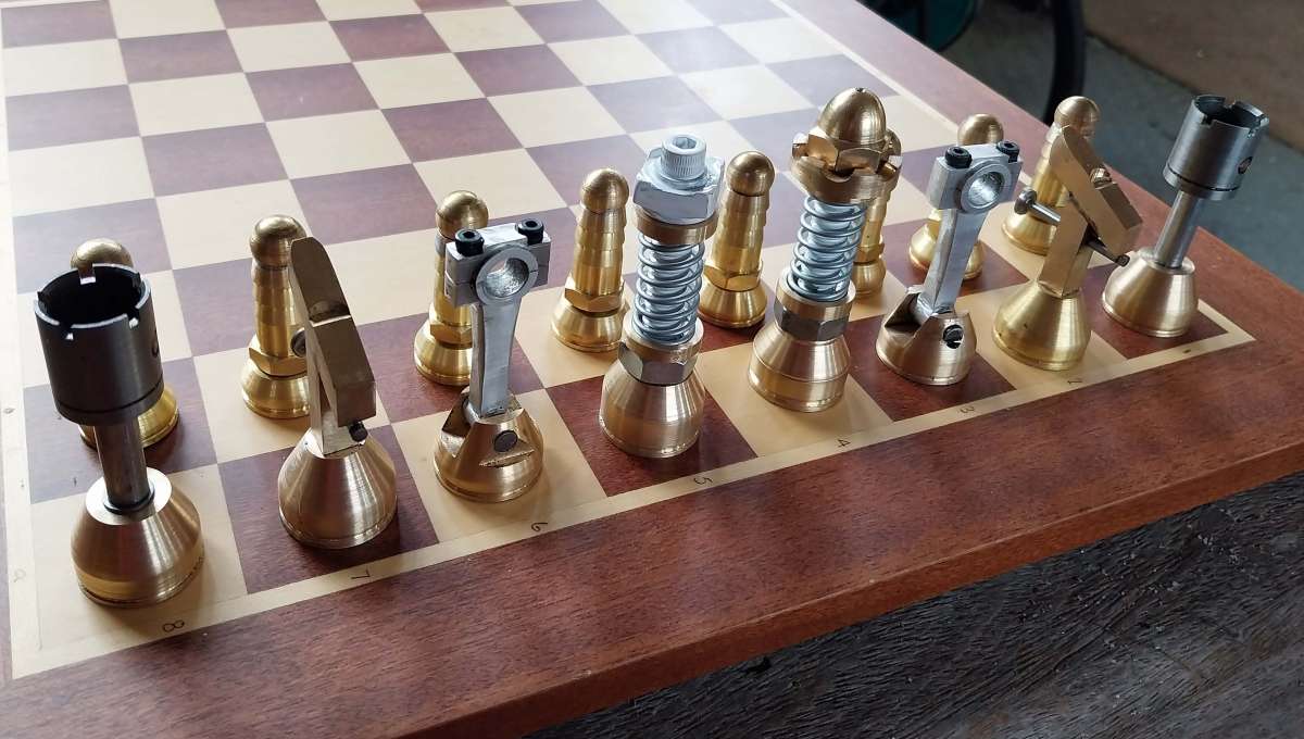

                                  Thank you all for your suggestions and experiences. I was unaware of self adhesive green baize and concerned that the material I have is quite thick high quality stuff that might make the smaller pieces unstable. Cutting the circles out with cheap circle cutters has been a bit of a pain. So I tried double sided tape but that increased the thickness too much, so araldite is being tried tomorrow. A thin cheap self adhesive material might be good provided it stays in position so I will trial that too.
                                  incidentally all the chess pieces, made with bits of old model engines or fitting were straightforward designs except for the knights which are the old asymmetrical pieces and have been a challenge. I will post a photo when all is complete and my grandson has beaten me in the first game.

                                        These are the unfinished white pieces. The bishops and rooks are made from parts of a Mastif 4 cylinder engine I built many years ago that was a real pain to set up and run and would have been thrown out when I go – the family might actually keep a chess set!

                                          That is a really nice set. Great thinking outside the box. Well done
