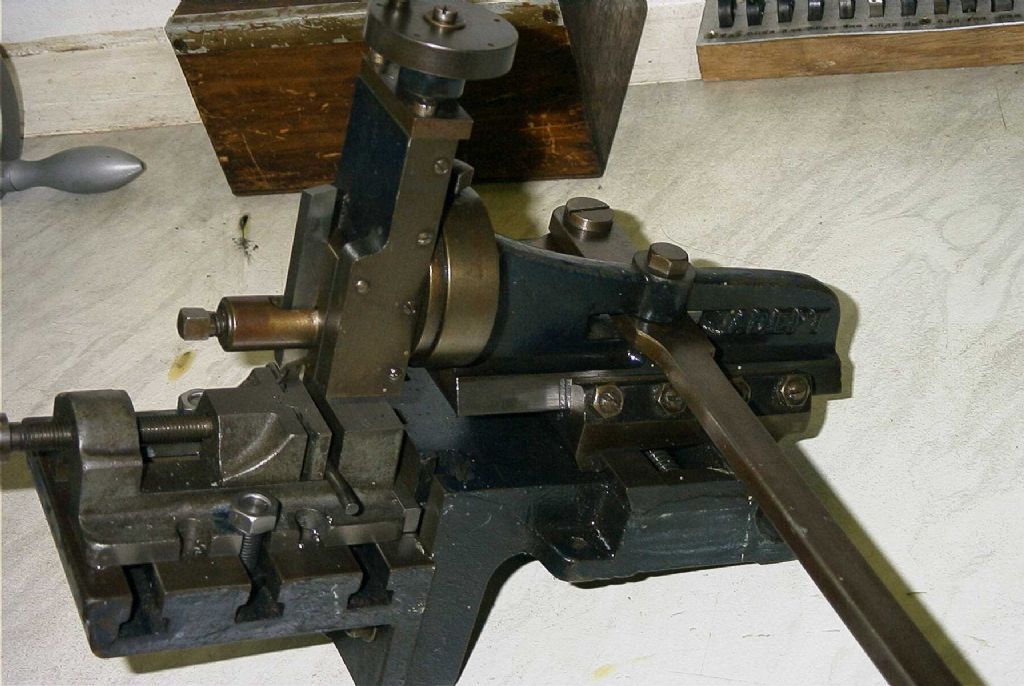

                        Here are pics of the No1:r0010040.jpg
                        #543620
                        Michael Belfer
                          @michaelbelfer47979
                          Thanks Glyn, Chris, but if you look earlier in this thread you will see it was reasonably clear that a) it is NOT a genuine Adept, and b) it is much more like a Number 1 than a 2 (Slides travel, number of tee-slots and so on.
                          But the question on the table at the moment is whether anyone can recognize the partial manufacturer logo pictured?
                          If not, too late now as painting has moved on far enough that the transfer/decal is now invisible.
                          Michael
