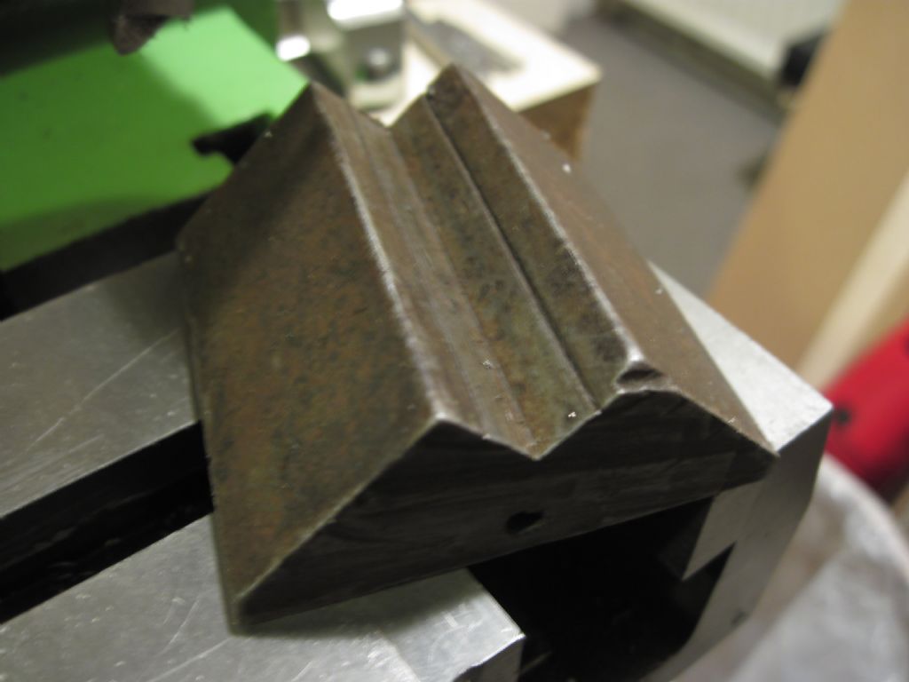

                            Battered V Rest
                            Battered 'V' rest, needed cleaning up but basic machining already done.

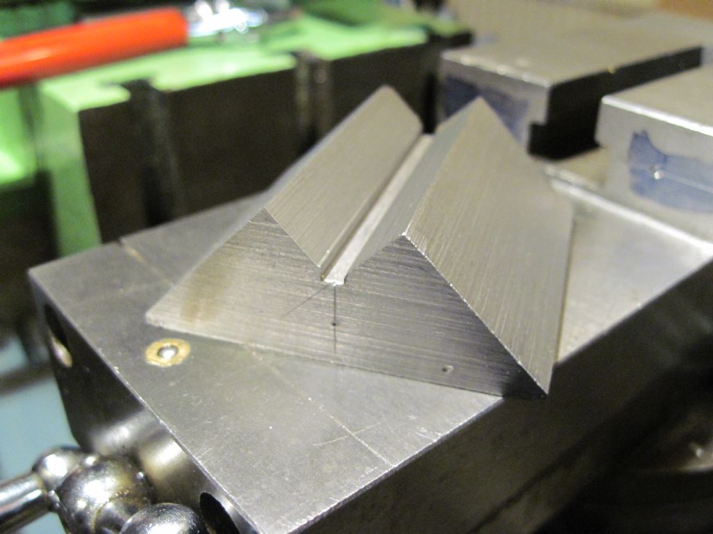

                            V rest - Finished
                            Fairly easy to clean up on the hand shaper, still took time but just really re-surfacing…

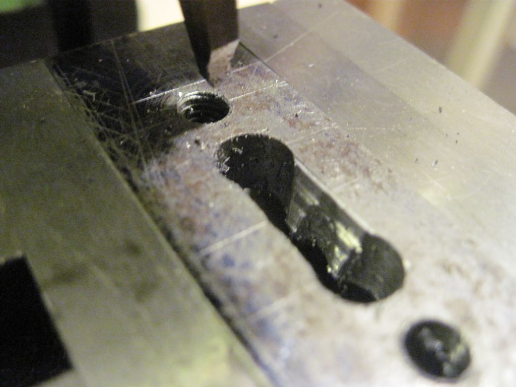

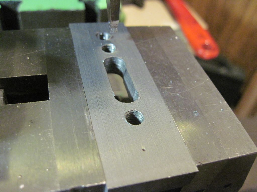

                            Next, tidying a slot drilled in a 'finger' for a finger plate
                            Simply done but an example of why you need to angle the clapper box on vertical cuts. Also used the Adept to cut the angles in the finger…

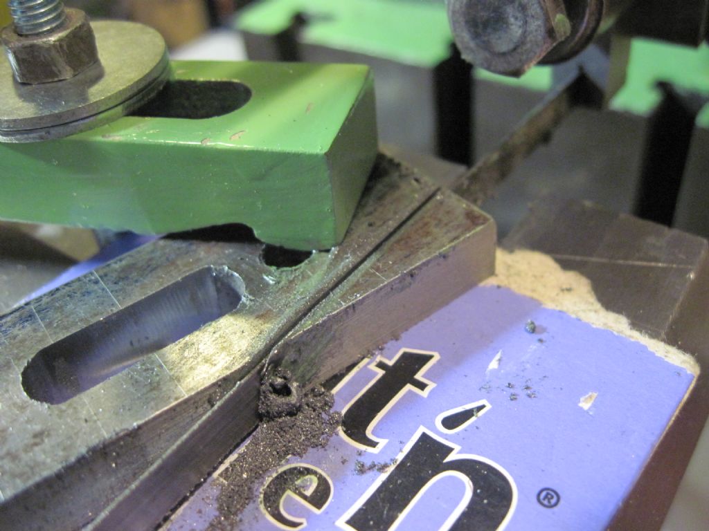

                            Shaper saw in mild steel
                            And finally, cutting 1mm AF hex parts. I often use my finger as a hold down for this and as I'm the 'motor' it is quite safe. Wouldn't do that on my Atlas of course!
