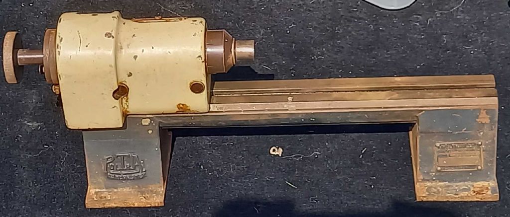

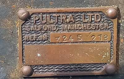

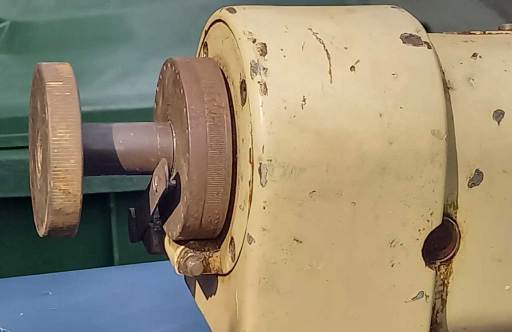

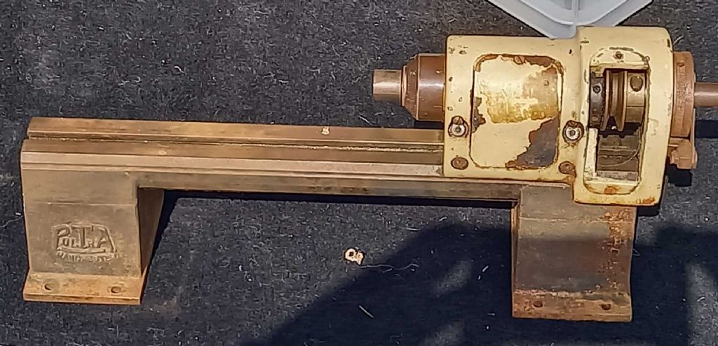

                pultra-4.jpgpultra-3.jpgpultra-2.jpgPhotos of bed and head. Not taken any of the other bits yet.

                  Excellent !!
                  On that Manchester bed, I suspect it may be a ‘bitza’ … but there’s nothing much wrong with that: They were sufficiently tightly toleranced that components were considered interchangeable.
                  Edited By Michael Gilligan on 21/05/2023 20:55:41
                  #646129
                    The series P … of which these are the beds, had a headstock more like a watchmaker’s lathe
                    #646131

                      I did wonder about the different finishes. At £40 including the chucks I was not too bothered It will be more of a bitza if I make my own slides… The headstock looks OK there is even some oil in it.
