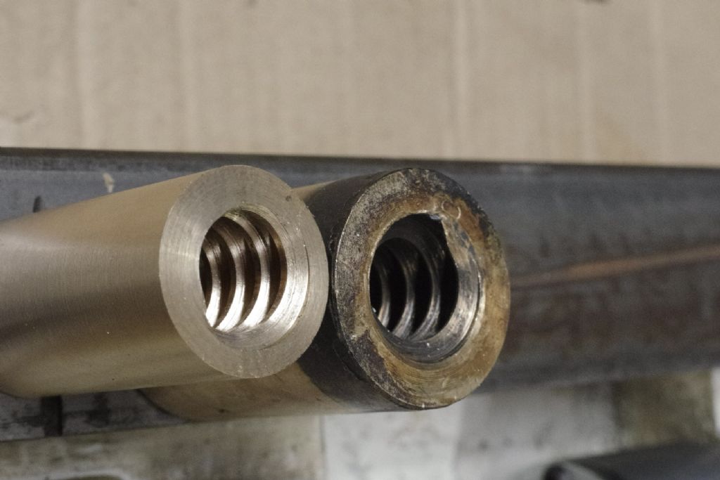

                                  recently I had to make 4 nuts for the jack screws fitted to a 100 year old smallish showmans living van.all I had to go on was a very corroded set of parts,the thread was 3/4 x4 tpi square thread, difficult ,so the owner settled to use 5 tpi Acme, as taps were available, The nuts were made from hard hex brass,I used hex as the nut could be held in lathe chuck or bench vise without slipping. The tap from tracy tools was a long tapered tap,I could not tap under power or by hand as the shank was small and a bit expensive to break,so I screwcut a vee thread and started the tap in the lathe to get it square then finished off by hand,not an easy job. Now one word of warning ,holding the tap in the tailstock via an ER collet and pushing it in by hand and when the tap bites let the work drag the tailstock along did not work, the new tap was so sharp that it did not pull the tailstock along,it stood still and the flanks of the thread acted like a boring tool turned the thread in the brass away,one scrap nut.so it was a case of pushing the tailstock along really hard and cutting a minimal amount of thread before resulting to using a very long tapwrench,the steel screw EN 8 was threaded in the lathe by single point tool ,the work supported by the travelling steady. The real problem with the job was the course pitch and the rather small diameter. For my own hobby work I would have made the correct square thread but it would not economical commercially,I have made square thread screws and nuts cut entirely on the lathe where the pitch was finer and the diameter greater eg the brake screws on a full sze TEs and and a threaded shaft for the sluice gate in a water meadow.
