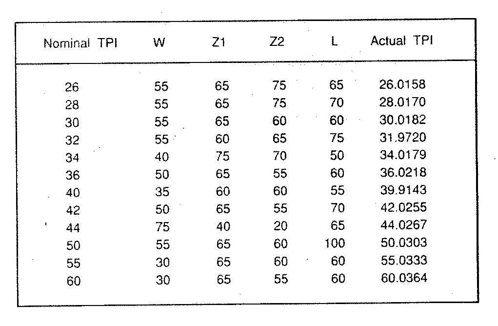

      Hey everyone,
      From what I understand, the Hobbymat MD65 thread chart only goes up to 24 TPI. Does anyone know if it’s possible to get a 28 TPI feed rate?
      I do have access to a 3D printer and can make custom gears if needed. Has anyone done this before, or know what gear ratio I’d need to make it work?
      Any advice or references would be much appreciated
      Thanks
      #819713
      Bazyle
        @bazyle
        Look at the settings for 14tpi and see if you can easily modify it to have an extra 2:1 in the ratio. ie double or halve one of the changewheels, not add extras.
        Drat its 55,65,75,35 so not that simple unless you can squeeze in a 70 instead of 35.
        #819723
        Nicholas Farr
          @nicholasfarr14254
          Hi, this might help.
          Scan_20251010
          Regards Nick.
