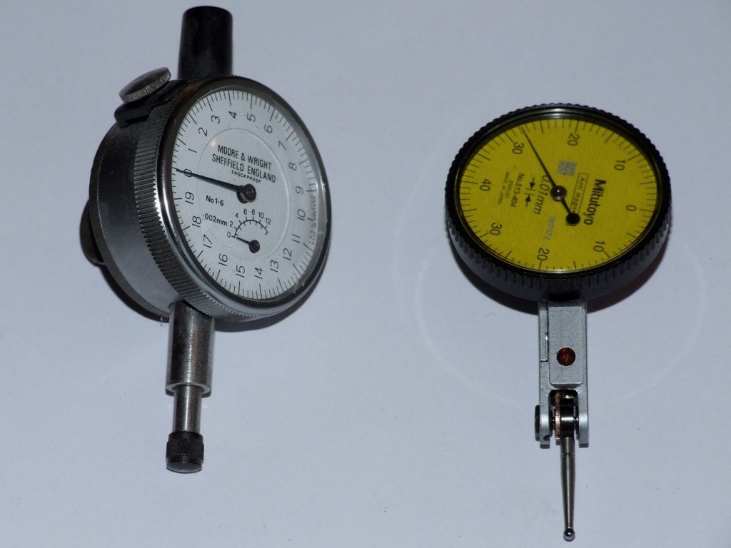

                        It depends upon what is being used to make the measurement. Here are two instruments:
                        On the left is a dial indicator, on the right a dial test indicator (DTI). The dial indicator should be accurate, assuming that the shaft is aligned with the direction of movement. The DTI is not intended to give accurate readings but simply an indication of movement from an arbitrary zero.
                        I've just checked the dial indicator on the left with a 1mm slip gauge and surface plate, the reading was 1.006mm. It would probably be more accurate if I'd cleaned the surface plate first.
                        So a dial indicator should give accurate measurements of distance. If it doesn't then something is wrong with it or the setup.

                          Posted by Andrew Johnston on 16/03/2021 11:28:21:
                          Andrew
                          I don't think I've ever seen a lever-type clock with a range of movement of anywhere near an inch. Apart from anything else the point of the lever moves in an arc, not a line. Those gauges are only suitable for reading small deviations, such as when completing truing-up of something already close to what's required.
                          So if the OP's using one o' them, it'd be deeply unsurprising if he got a discrepancy.
                          But he says he was using one with a full inch of range, so I read that as meaning it must be a plunger-type; and in that case I'd agree with you – something has to be wrong with the clock or how the test's set up.
