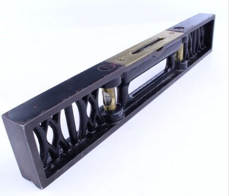

      I have a Rabone 12" Engineers level, which I believe was carried over to Rabone and Chesterman era.
      There is no identifying number on it, apart from the Makers name, it is utterly without any information. Usually such a well made level would have its accuracy marked somewhere on it, but not with this one!
      So what would its accuracy be? I have used it to check and adjust for zero twist in a Myford lathe bed. I am now wondering if it is good enough for this purpose? Or should I purchase a clinometer for such jobs?
      Andrew.

          Hi, I was having problems with bed twist last week and used a similar or the same Rabone Chesterman level, the ones with the V on the bottom. It has improved the turning remarkably . A simple matter of slackening off one of the tailstock end foot mounting bolts. I think as long as the bubble is in the same place in 2-3 places  on the bed ,its accurate enough for most .
          Mine doesnt have any accuracy markings either.
          mines identical to this:
          Edited By mark smith 20 on 10/09/2017 14:39:32
          Edited By mark smith 20 on 10/09/2017 14:40:19

                      If the precision (not accuracy) of a level isn't marked, you have no idea what it might be from comparison with similar, but maybe not identical, ones.
                      Set it up so it's about level, then raise one end with a feeler gauge and note the movement of the bubble to work out what its precision is.

                              Ideally, when raising one end with feelers or shims, try to do so over a known span, (in your case, I would suggest end to end)so that when the bubble has moved by one divison, you will then know the sensitivity in thous per foot for one division.
                              If you want to be really finicky, start with both ends resting on equal diameter rollers, shim until bubble shows Zero, and then raise one end by placing shims or feelers between the roller and the level at one end. Ensure that the ends are on a diameter of the rollers.
