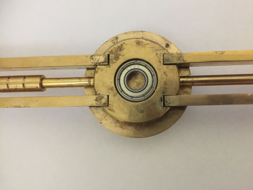

      I want to make a number of hubs like this:
      That's a mess I know, but it was a proof of principle exercise, not intended to look pretty!

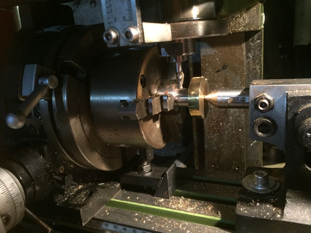

      I set up the 'proper job' to cut the 3/16" slots like this:
      The brass disc is held against the steel stub in the chuck by two sided adhesive tape and tailstock pressure. The work moved with consequent knackerment.

                Tin the brass parts and the steel stub with soft solder. Sweat them together. Cut all at once.
                Alternatively, superglue instead of solder.
                You did not say how (which direction) it moved. Are you cutting to compress the double-sided tape or to expand it? If it moved downwards or sideways, a flat stop in the appropriate direction will prevent this.
                To me, the steel stub looks a little on the small side. Something the same diameter as the brass would give more surface area for the glue. Clearly, you will cut into it the first time you use it.

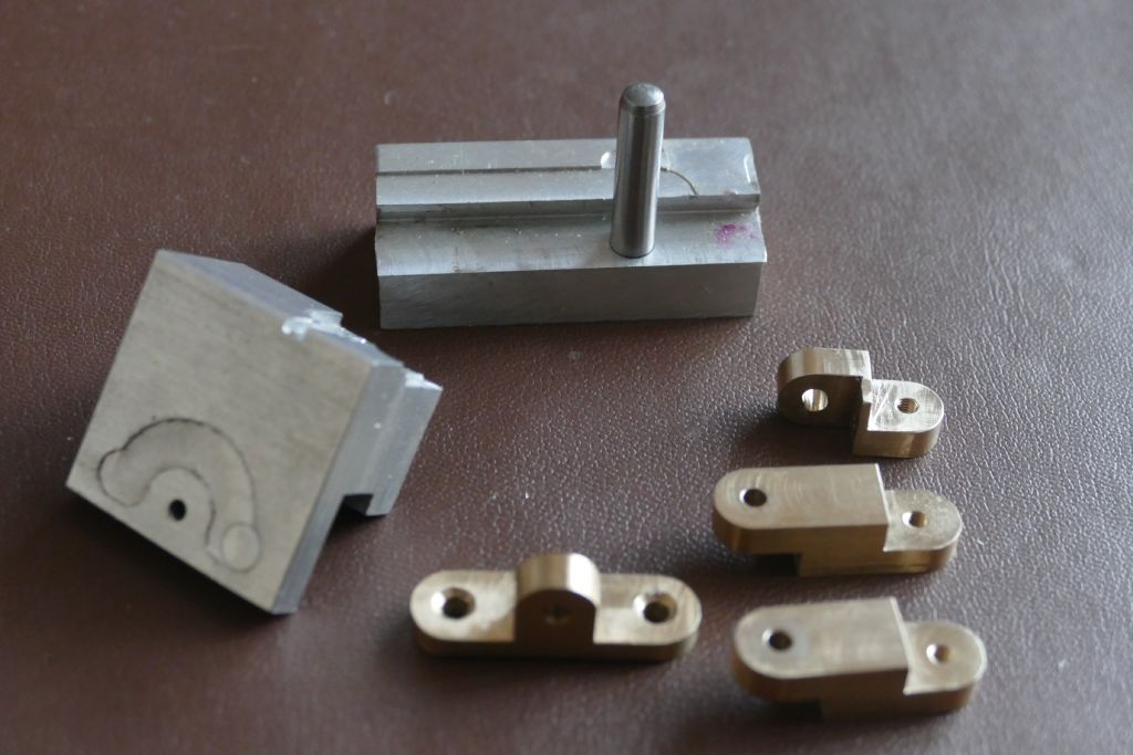

                    Once the first two slots are cut on one side you have a spigot and two shoulders to position the part in a recess. You could make the recess so that it clamped the spigot as well if you wanted to. If it was something I was doing to make many I would use a piece of aluminium plate that supported the back and also had a few tapped holes to allow clamping then it could be used horizontally and vertically for both the second slotting process and the boring for the bearing. A few reference features would allow setting up if the work was interrupted or the tool was going to be used at some point in the future.
                    This is what I was doing yesterday. I wanted to repeatedly position and hold a few bits of brass to machine down to 10mm square after cutting from some plate then add the final features without risking my vice jaws. A few scraps of aluminium and a dowel soon resulted in a throwaway jig. In use the block with the dowel in was supported on parallels and one end was held with a toolmaker's clamp which was then clamped to the bed of the mill to keep it in one place. The dowel acted as a stop in a known position and can be slipped out when not required. It can also be used to pick up the same point again if required in a few days time.
                    rough jig and parts

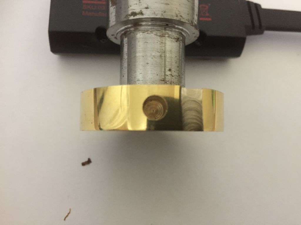

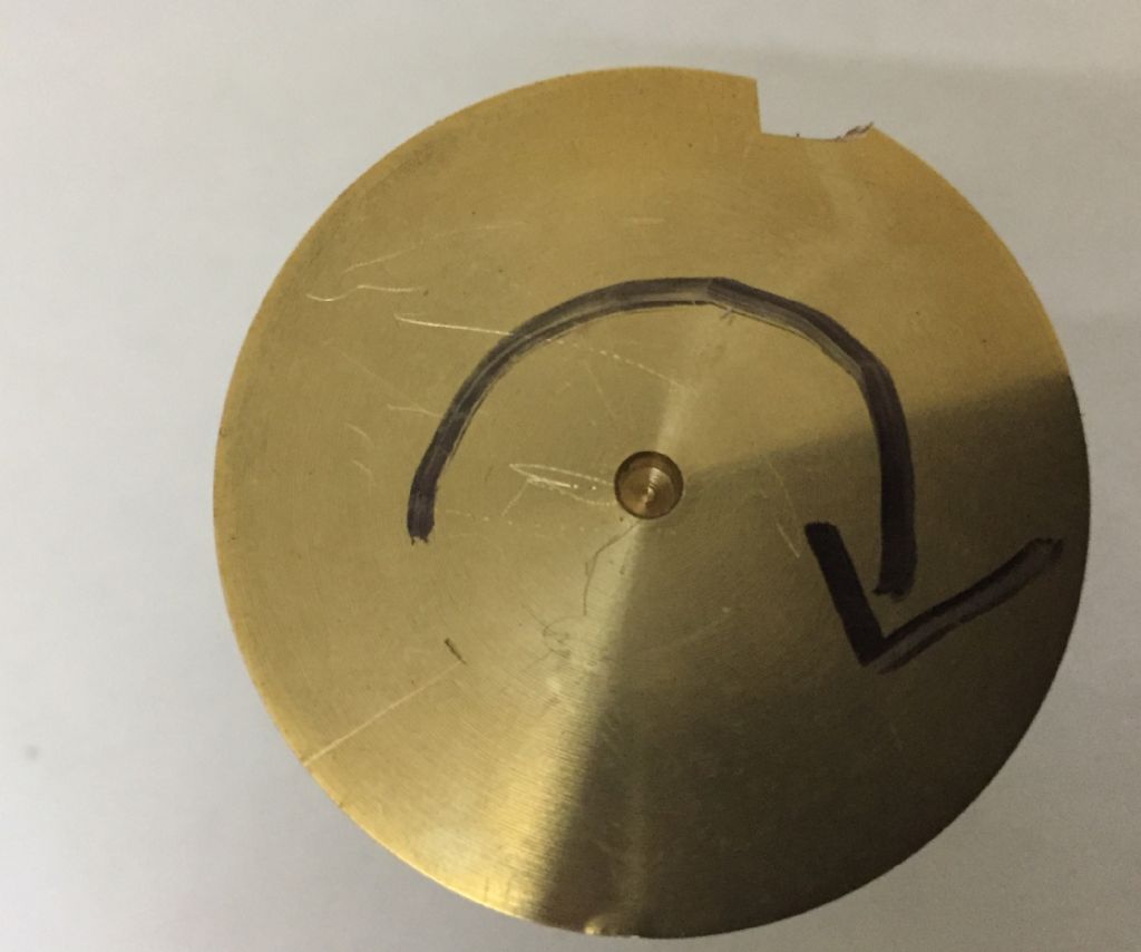

                                  Thanks for replies. This is what the slot looked like after the first pass (2mm DOC):
                                  It seems that the work wandered clockwise:
                                  I was cutting away 'front to back' in this view with a 2-flute slot drill – so conventional milling on the left hand side of the slot. I guess that makes sense – the bit was trying to pull into the work.
                                  The reason that I tried this setup was that I'd used a similar arrangement for turning and facing on the lathe and that works well. Presumably that's because a it doesn't matter if the work slips a little around the rotational axis when the the cutting force is applied. A different result when milling though!
                                  From replies it looks that I don't need to buy or make an expanding mandrel, which is good news. The 'bolt on' approach should work. I can make a through hole, as I said in my original post.
                                  With the benefit of hindsight I should have done the milling before the turning/parting as suggested, It's not the first time I've painted myself into a corner and had to devise an escape route blush.

                                        Even with the through bolt mounting you will still have a significant off centre cutting force which will tend to rotate the disc as it tries to run away from the cutter. Also full width cut slots tend to wander especially if one side of the slot is deeper than the other like this.
                                        If you have a smaller cutter I suggest you use it

                                          Thanks for further replies. I made a test with some scrap (actually the piece pictured, as that's what it is now is) with the intention of trying (a) a through bolt fixing with full width cutter, followed by (b) through bolt with a smaller cutter if that still moved, then (c) dowelling the work to the mandrel. (a) seems to work, so I'm happy for now, but shall keep (b) and (c) in mind.
                                          Chris Gunn – that would have been the way to do it I now realise, but I've lumbered myself with a pile of brass discs and don't want to start again. I'm self-taught and most of my effort has been directed towards (ahem) 'mastering' basic techniques . I'm pretty bad at planning machining sequences. Maybe that's the next thing.
