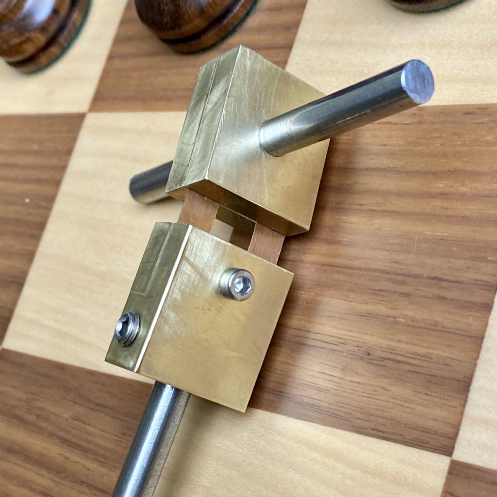

      I've started work on an "Arduinome"-type hybrid mechanical / electronic pendulum clock. I'd like it to be simple, practical, and hopefully imbued with a touch of artistry. So far, I've completed the pendulum's hinge assembly.
      The hinge itself consists of two 0.004" thick by 0.25" wide strips of beryllium copper. Cutting this using scissors did not work particularly well, as they leave a curled and uneven edge. Thankfully, John Haine (in this forum) made a creative suggestion, which I used: I clamped the cut strips between two 0.25" tool-steel blanks and used an old chisel, laid flat along the steel, to hammer-cut a sliver from the edges. After turning it around, I hammered off the other edge. This worked brilliantly, leaving very clean and straight cuts and a uniform width.
      These strips are held by 0.25" thick two-piece "chops" for stiffness and stability. The upper chops were drilled and reamed for a 3" by 0.25" stainless steel rod. This will sit in a cradle that holds the pendulum.
      The lower part consisted of two pieces: an "L" shaped main body, and a smaller piece that fits into the L. The "L" was used so that I could drill and ream the lower solid part to accept the main pendulum shaft. This was also drilled and tapped to accept two brass-tipped set-screws to fix the shaft in place.
      Cyanoacrylate adhesive was used to join the chops. I'm a little uncertain if this will be sufficient in the long term, but I experimented with it, and it seems very strong. I suppose I could (and probably should) try to insert pins to further fix the strips in the chops. But for now, I'm more worried about ruining the hinge via mishandling!
      The pendulum's shaft is a 0.25" by 36" rod of Invar, a low temperature-coefficient metal that is sometimes used in high-quality clock pendulums. It's quoted as having a 1.2 ppm TC. I may add further temperature compensation, or I may not, as this material should provide decent temperature stability on its own.
      Next steps: I have a 1" by 3" brass disk which I will likely use as the pendulum's bob. This should weigh about 2 lbs, which is rather light for a bob, but the 0.25" shaft is too thin for the usual ~14 lb weight anyway. I also mocked up a cradle for the pendulum in 3D printed form, and will build it in brass, too.
      Here's a picture of the hinge in its chops, the stainless support shaft and the Invar pendulum shaft:
      It should be a fun and interesting project. 🙂

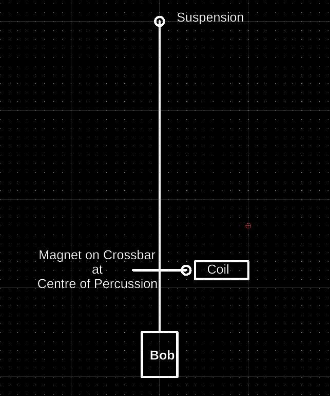

                                  Dave, yes, I will try for the CP, assuming I can find it or calculate it well enough. But I'll want to dodge the bob, so if it's too near that, I'll move it away from it a little.
                                  As for positioning, I'm thinking of mounting everything on a long, e.g. 40", T-slotted aluminum profile. That way, I can do the gross positioning of components along it pretty easily. But the impulse mechanism might need its own adjustment for the swing, the extent of which would vary depending on its location, etc. A little thought would need to go into that.
                                  Also, while the bottom of the pendulum is the ideal spot for an opto-interrupter, I'd like a clean design, so I might integrate it with the impulse mechanism too, e.g. impulse coil on one side and opto on the other.

                                    I can't visualise your coil and magnet arrangement – any chance of a sketch?

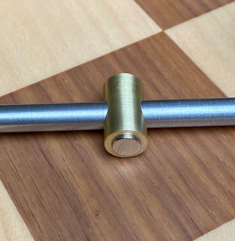

                                        I propose using a hollow (coreless) coil. I have an old relay somewhere whose coil I can likely scavenge, or else I'll 3D print a bobbin for one.
                                        I've just bought two 1/4" by 1/4" cylindrical grade 52 Neodymium magnets for this purpose, either for use in a pair or to have an extra. (I also splurged for brass rather than cast iron for the bob.)
                                        The picture above is approximately what I'm thinking of, with the magnet on a short stick so there's space for it to continue through the hollow coil without the rod hitting it. I've seen this approach used somewhere else, I think using a horn shaped piece of steel rather than a magnet, but I can't find it now.
                                        My question is where the magnet should be relative to the coil at the point of the impulse (approximately). I was thinking inside it, at the center of the coil, but now I see that's wrong. I suppose needs to be while near the outside, e.g. at the entrance to the coil.
                                        In the alternative, I don't like the idea of a "flat coil under the bob," but I do like John's Helmholtz coil approach. If the latter, I think I could use the two magnets facing out from the rod with their poles in the same direction (i.e. NS-NS), as I don't have the opportunity to put one inside the rod as John did. Maybe that's a more elegant solution.
