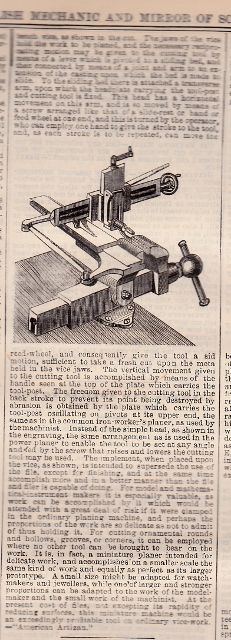

                          Thought I had put in a picture of M. Vautrin's miniature planer of the 1860s, I'll try again. Ian S Cvintage shaper (231x640).jpg

                            Ian,
                            Thanks for posting Vautrin's Planer.
                            … I have sent you a PM

                                                No problem Michael. The book it came from is a bound volume, one of the second hand book shops in Christchurch, ("Smiths Book Shop", the locals will know it well), had about 20 volumes at $NZ50 each, except the one I have that was water damaged, and I got it for $NZ5. Love these old books, you soon learn there is nothing new in this world, they were, in 1868 worrying about climate change, it was getting colder, and they thought an ice age may be on the way. Ian S C
