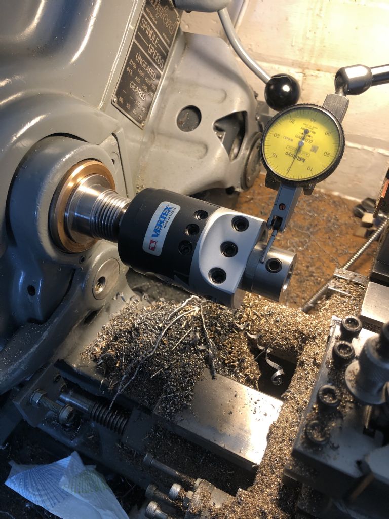

      I want to make a number of round pegs with a central flange to join some round tubes with brazing but I want the diameter on one side of the flange to be eccentric to the other by varying amounts on each peg.
      I have seen the trick where a piece of metal is placed between the jaw of a chuck and the workpiece to create eccentricity but I would like to be able to dial it in like you can with some boring bar heads.
      The tubes to be joined have an inside diameter of 15mm so I have thought of using a small chuck mounted on a small dovetail cross slide, which in turn is mounted on a faceplate, which might seem like overkill and something only to be used at low speed but one that would produce repeatable results, if I can first find a lightweight, low profile cross slide for this set up?

            Will your boring head screw off it's shank, if so just put that in the 3 or 4-jaw. Simple straight shank backplate to fit the boring head so chuck can be mounted or even just a bit of bar with a 15mm hole to take one end of bar locked with a grub screw so other end can be turned eccentric to it.
            Alternative is to hold work in toolpost or on vertical slide and put boring head into lathe spindle with an external tool and then just use cross slide handwheel to set the offsets

                          Sorry, Yes I do have one, and thought of cutting the pegs mounted on a vertical slide with the cutting tool in the other way round, but now I’m sold on the idea of a peg holder fitted in my MT2 boring bar head held by a draw bar in spindle of my S7

                            But of a disappointment, as I found the central cutter hole of my boring head doesn’t spin true by 0.5 mm at right angles to it’s slide, so as things stand I can’t start from true, or on this hole anyway!

                              That's why I said put the head in your 4 jaw so you can clock the hole in the head true.
                              Or if you want to use the taper mount then put the spigot of your holding adaptor into the boring head and bore the hole for the 15mm part while held in the boring head this will ensure your part runs true at "zero" then you can feed in any offset you want.
